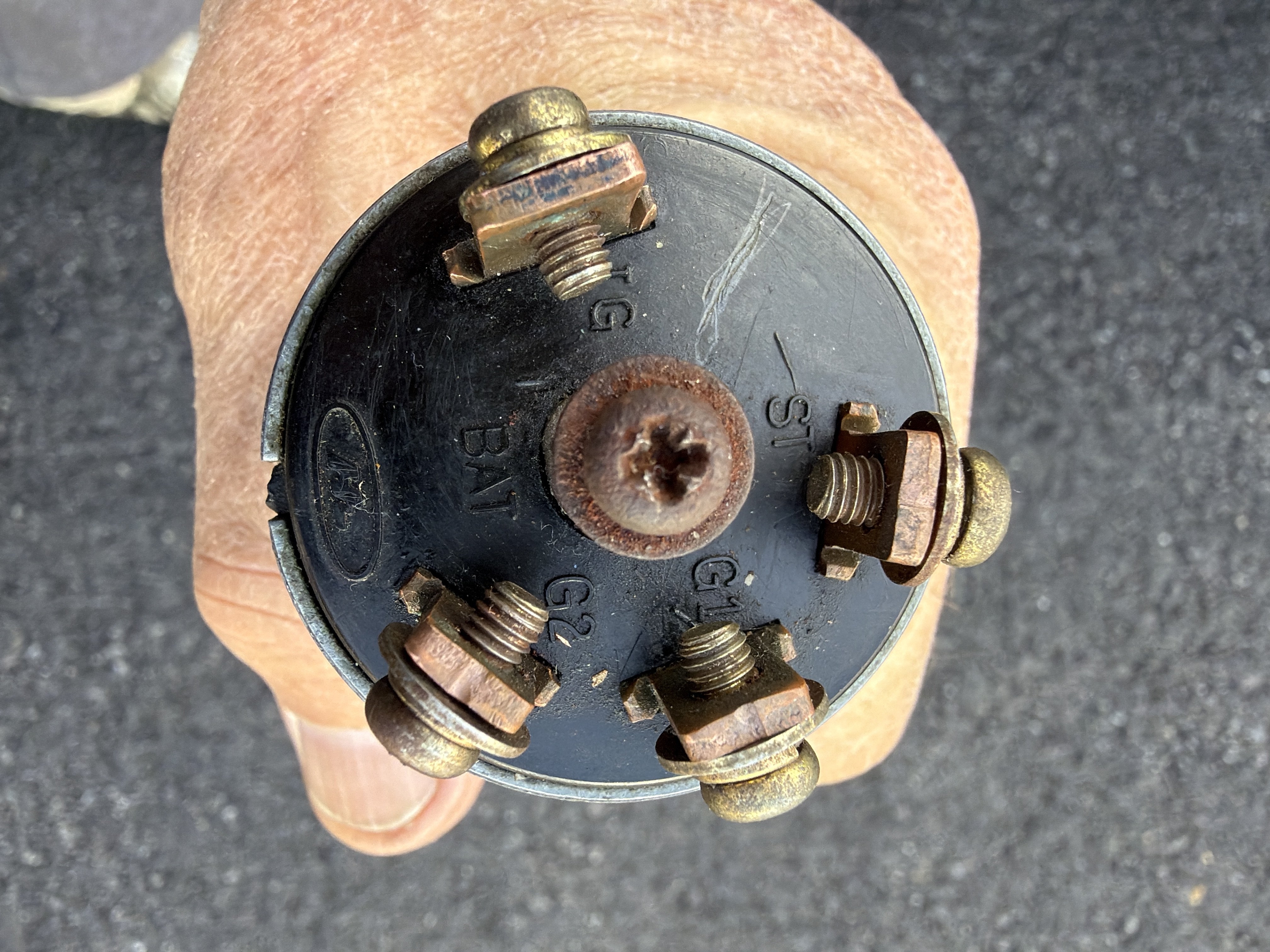

Have a MT210D with bad ignition switch. Got one from Amazon. Little different terminals. Old one has BAT in center and IG, ST , G1 , G2 in clockwise order. The one received with no instructions has:
B, BR , C , R1, R2 and ACC. I connected:
BAT to B
IG to BR
ST to C
G1 to R1
G2 to R2
ACC not connected.
When battery connected bad spark at battery with key off. Disconnected.
Then tried moving IG to ACC and no spark.The tractor started in on position then would not stop in off position.
Dumped clutch in high gear to shut off.
Any idea what’s wrong with order?

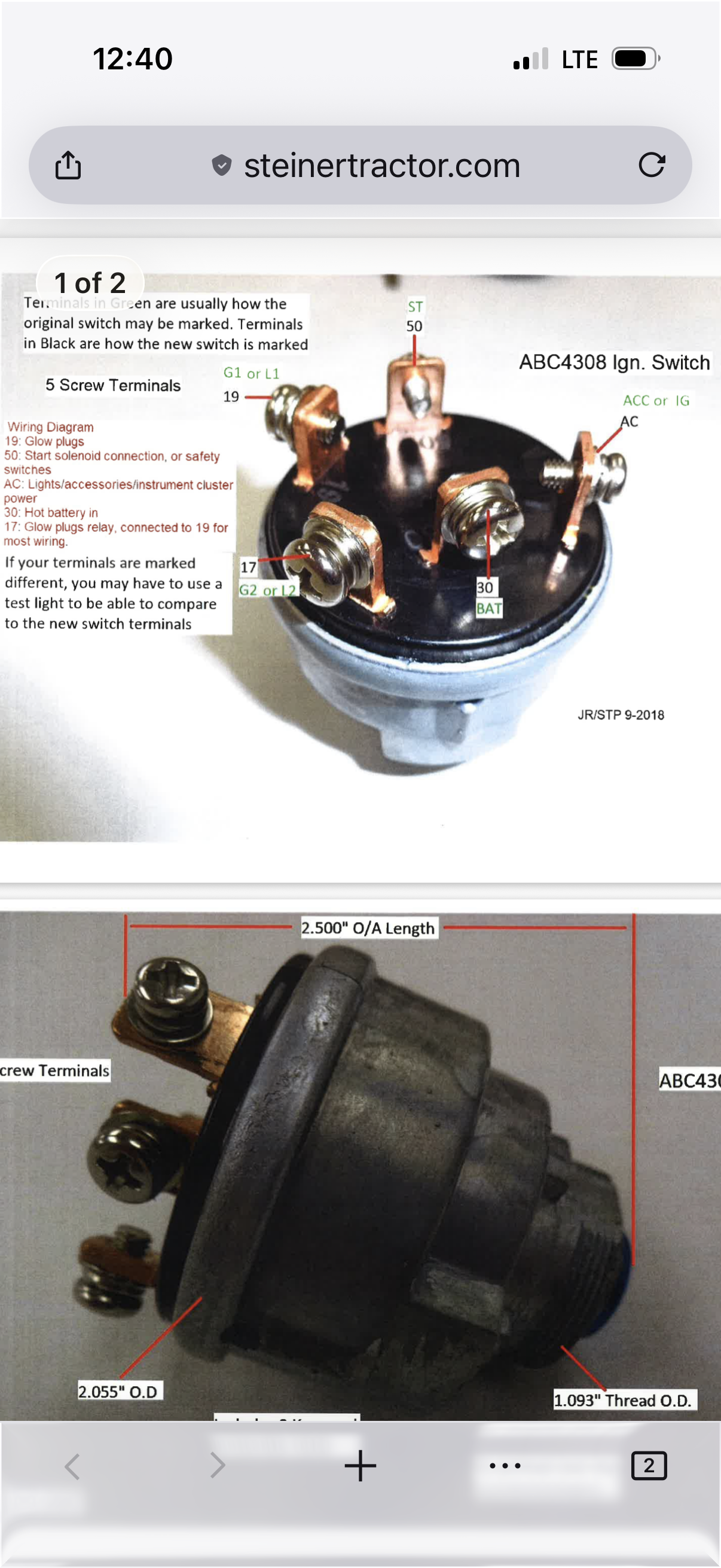

The 2nd photo is what I found for help from a different switch.
