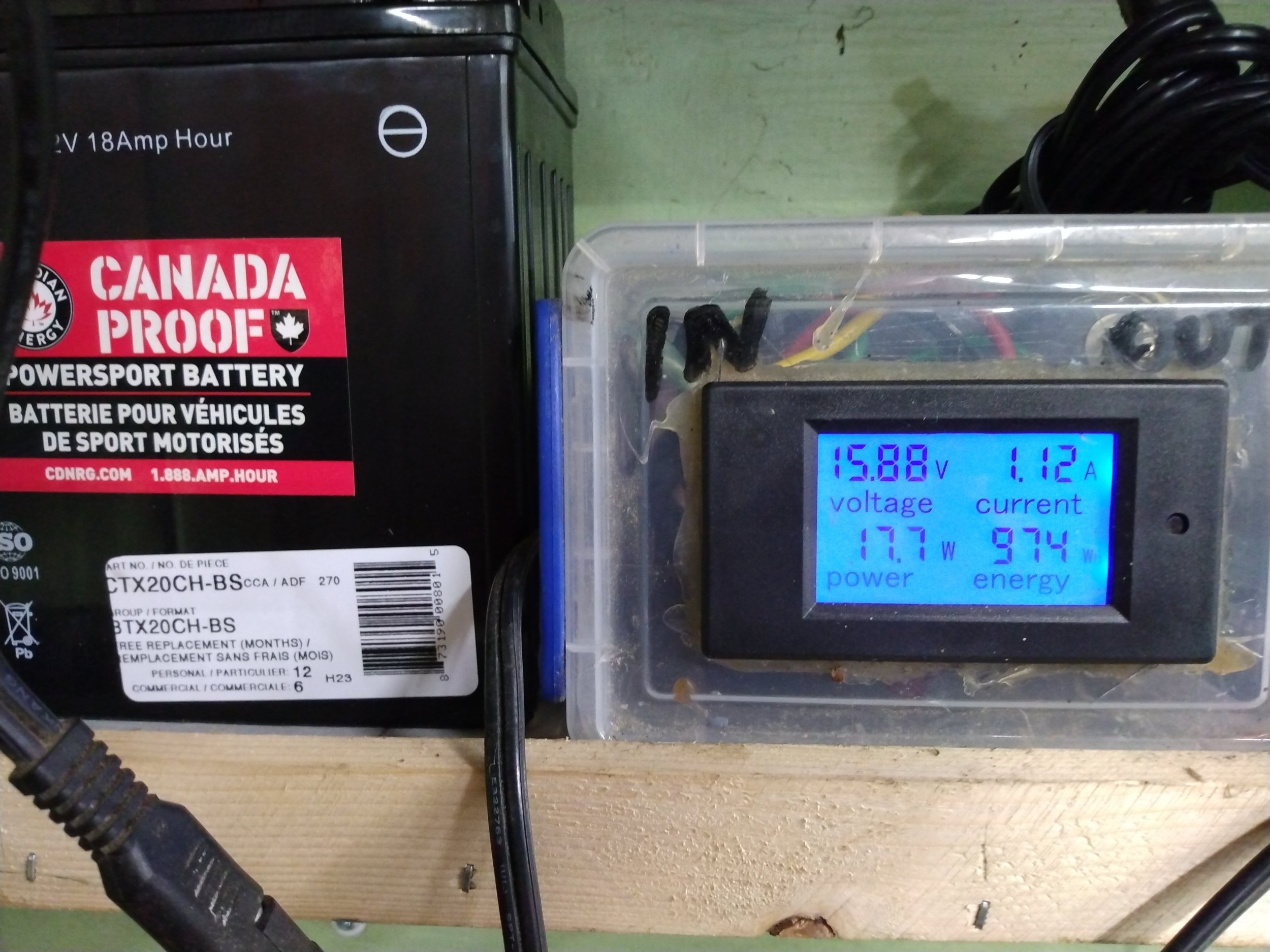

That's what I used to think. Just last winter I had a new one one fry the battery on my bike. They sent me a replacement that was going to do the same to my new battery if I hadn't caught it by putting an ammeter inline with it. I attempted to contact them about the faulty replacement and got nothing but crickets.
This is what the Schumacher maintainer was putting into a fully charged battery after 1/2 an hour, you could smell and hear it boiling. Never again a Schumacher.

For sure, as can anything. I've got two other Schumachers that are almost 10 years old. They're actually twice as heavy as the new ones so I presume they're more than likely transformer based rather than 100% electronic. One's on my tractor which has a full size battery, the other on my ZT which is a lawn tractor battery, not a lick of problem with either.
To have two of them fail with the same problem, (the original one that I had bought and the replacement they sent me) would tell me there's something wrong other than just a random failure.
Here's a pic of the replacement they sent me, the second one than boiled my battery. A minor problem but really LOL. In case it's not immediately obvious, the charger is up side down, so the status lights are shining thru the wrong part of the label. Sorry for the fuzzy pic.

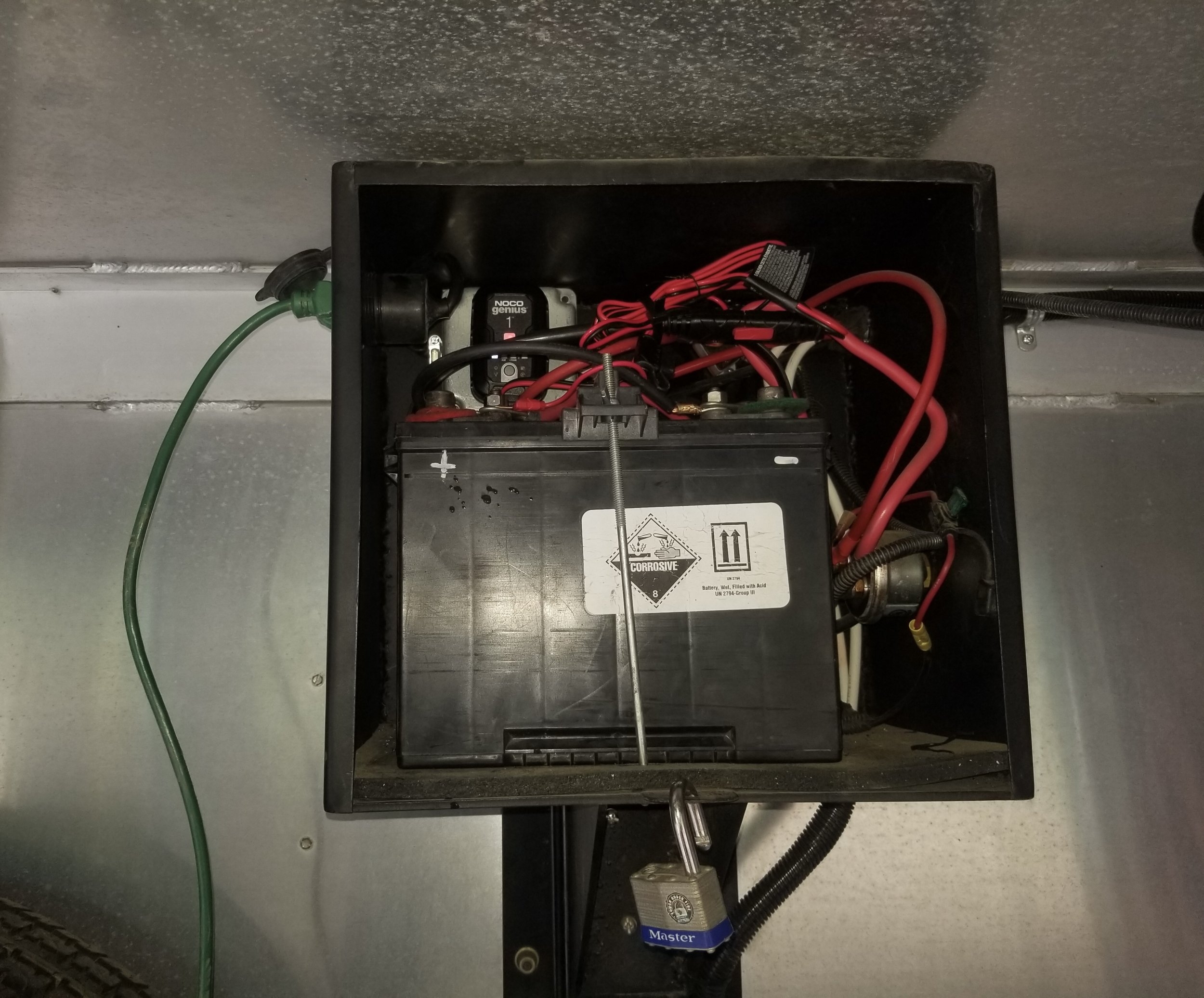

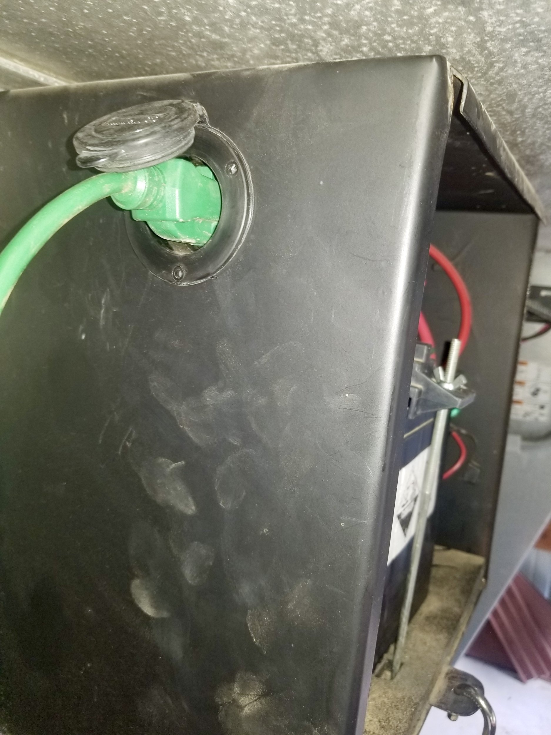

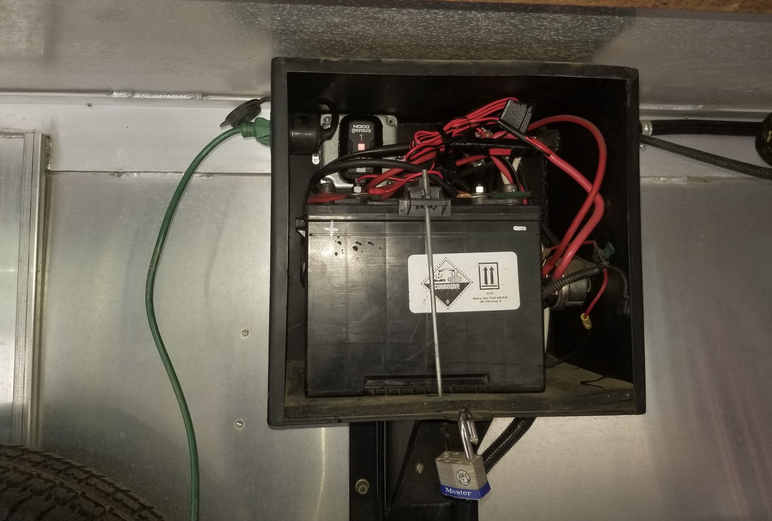

Well, i got the Noco genius 1 installed in the horse trailer. I have a exterior WP outlet installed outside battery box that houses battery and controls for electric landing gear plus battery disconnect switch. Its getting crowded in there.
But now when i lock the cover inplace, i can simply plug the cord on the side and not have to pull bttery during the winter. I did a similar thing to the dump trailer a few years back. Has worked great.

isn't this a agm battery?
