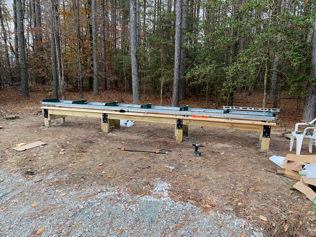

I got the track assembled and as straight and level as I think it will get. The instructions are good, but this reminds me of those old-fashioned stamped metal utility shelf kits where you'd get a zillion screws and square nuts, and had to put it all together. Tedious is an understatement. But it's together and solid as heck.
One section of track had a slight bow on the end, so I wrote Woodland Mills to see if I can get a replacement (I think I could bend it but I'd rather let them weigh in first). Other than that, the quality is very good and the track is very heavy duty. No missing fasteners or parts (yet). Need to begin assembling the saw head next.

Great job and it looks very solid. :thumbsup::thumbsup:
