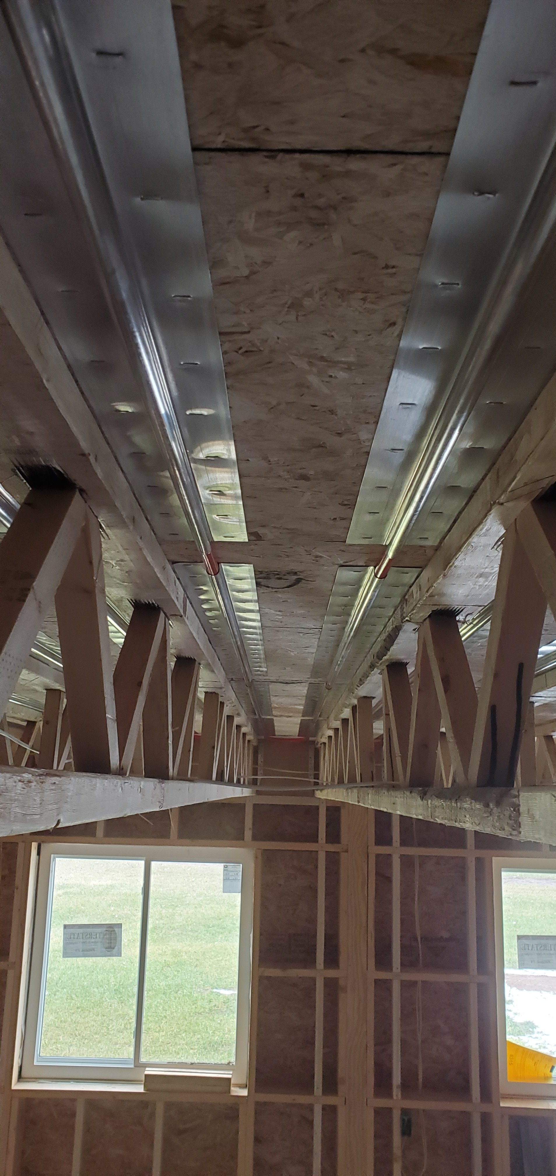

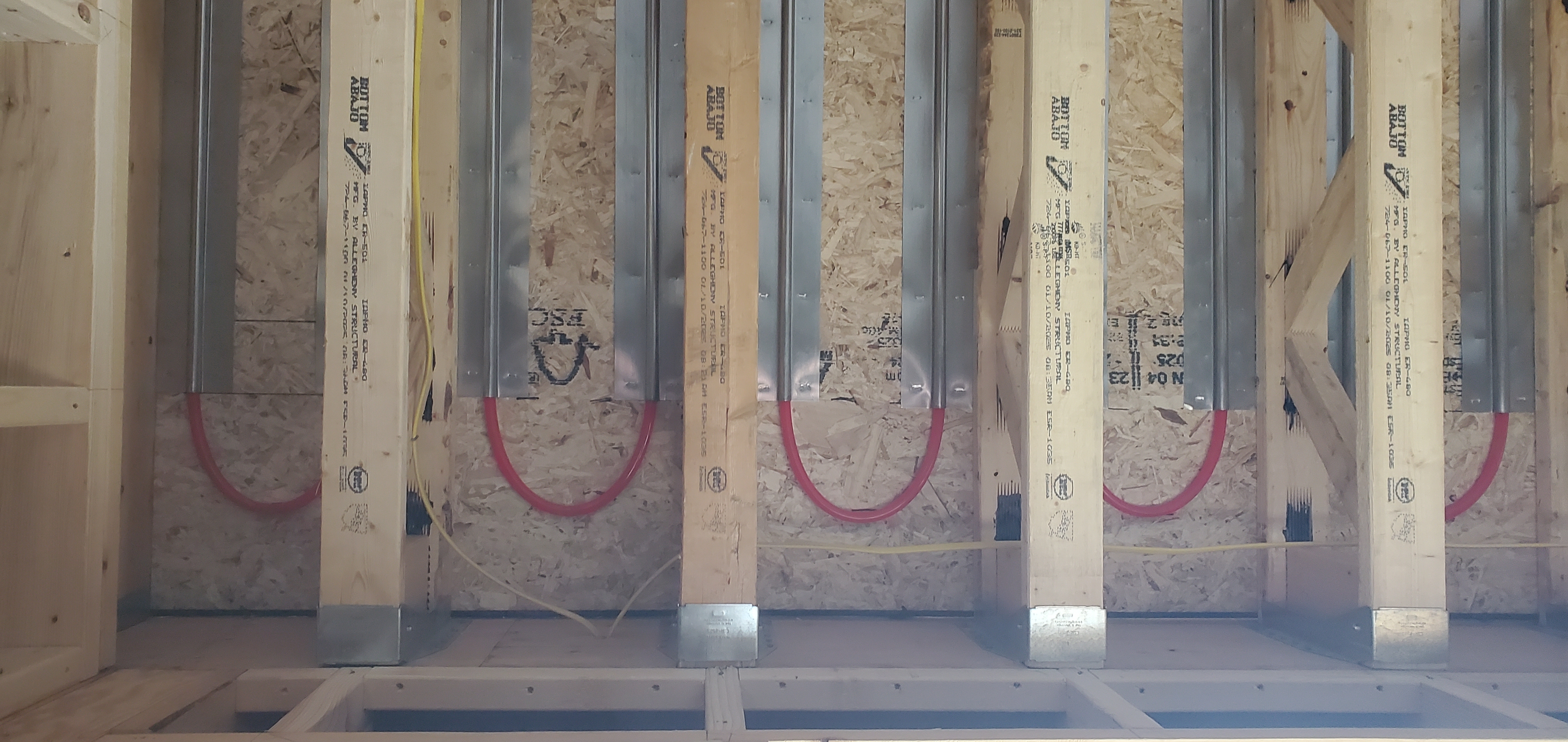

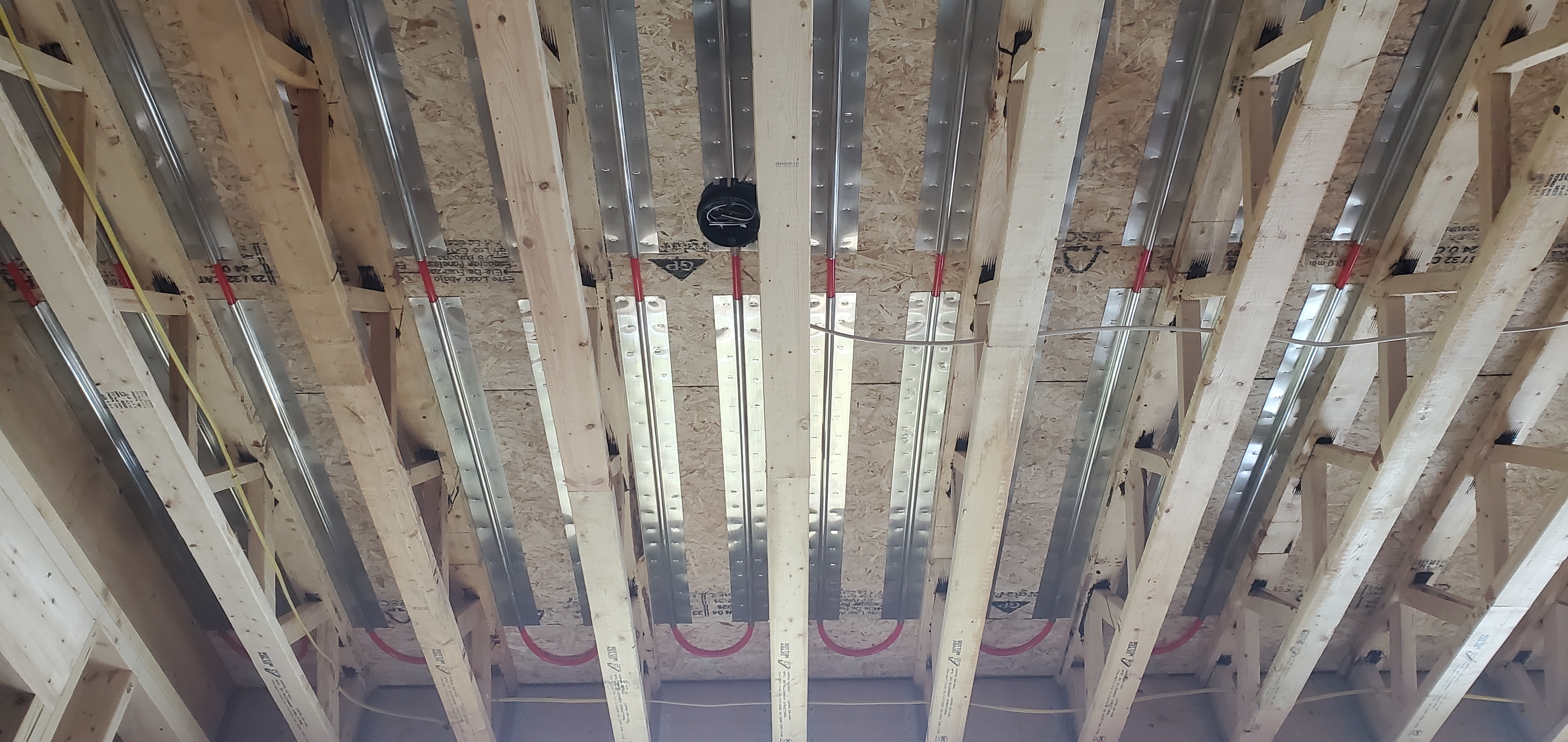

I started the sub-floor radiant tube installation this weekend.

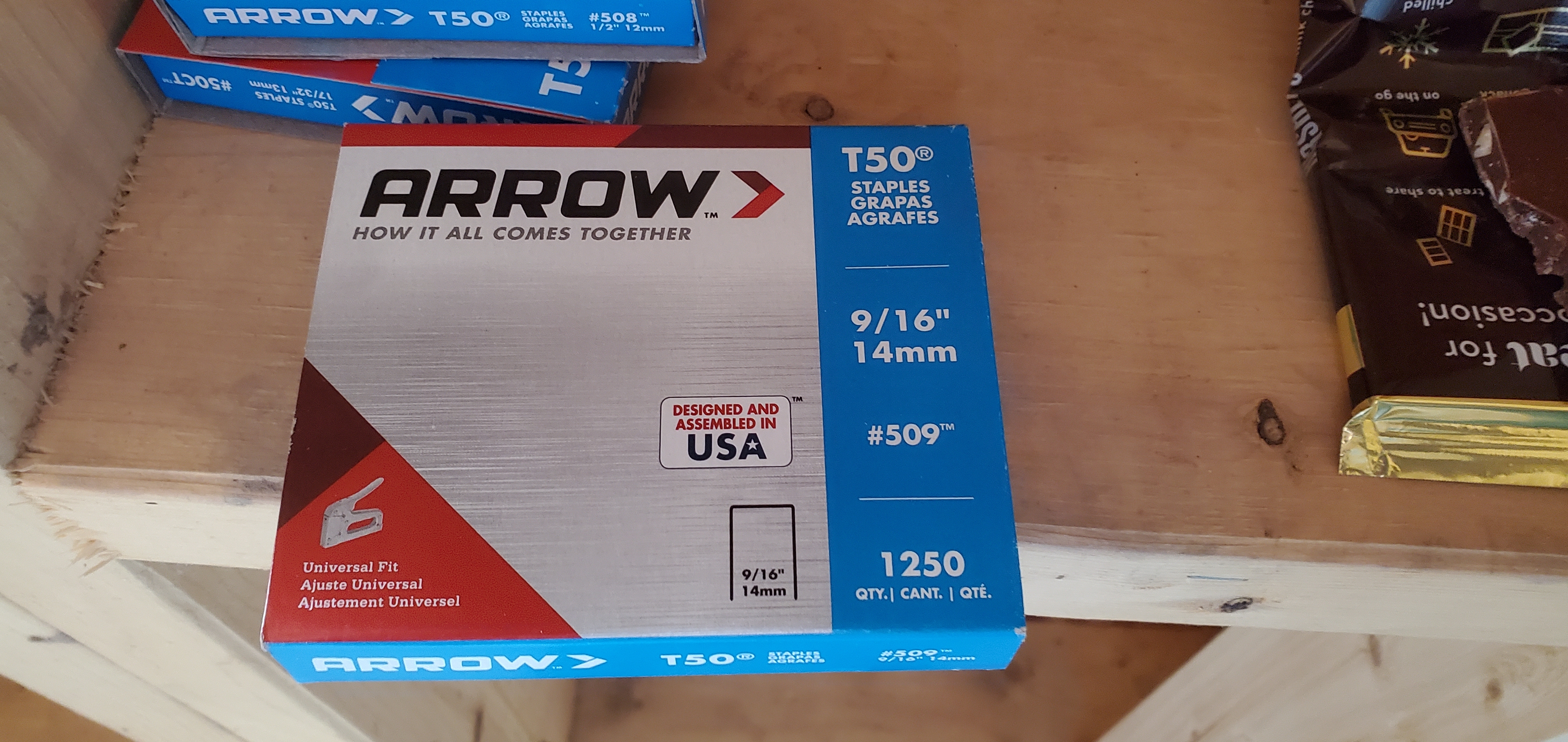

I am really struggling with the staples. I have a Milwaukee cordless T50 staple gun, that has no problem driving a T50 3/8" crown x 9/16" leg staple through the aluminum transfer plates and into the sub-floor plywood. The issue is the staples are made out of such garbage (import) metal, that ~50% of the time I end up with a staple that is folded over on itself and I have to pull out with pliers, and try again, sometimes try many times to get that staple to go in.
I don't know why, but any stalpes over 3/8" leg length do not have a beveled edge, they are cut square.
The 3/8" leg length staples with the bevels do go in better, but I wanted longer staples with more holding power to ensure these plates do not fall down over the next ~100 years etc.
I did order some stainless steel marine grade T50 x 9/16" leg staples off Amazon in the hopes that they are stronger and will not fold over when driving through the transfer plates. However, country of origin on those is also not USA.
I'm so annoyed with these import building materials. I'm building a house in the USA, I want USA made stuff. Look at that package "Designed and assembled in the USA". How to the heck are staples assembled in the USA? Put in the box in the USA? So sick of this BS.
Anyone know where I can buy USA MADE T50 staples?

Routing and looping that PEX must be a nightmare, like wrestling a snake. You must have a trick to it.

Nice and clean installation! When I saw all the staples 30 per section, thats a lot of work! Is there a spec like a staple or fastener every 4" ? Then are you doing a fiberglass batt insulation?
I have not been able to find documantation that states the staple count and/or pitch.
The plates need to have as much conductive contact to the subfloor as possible to transfer the heat. I noticed when I used less staples the plates dipped away from the subfloor between the staples. All the failed staple installations don't help either as they deform the metal and the contact between the plate and plywood is not ideal.
This is not the most efficient way to do radiant heat for a subfloor. When I helped my brother do his house, we installed 1" foam on top of 2x2 stringers that we nailed to the sides of the joists, plastic stapled the pex to the foam, then filled between each of the joist spacings with ~1.5" of motar, then installed the subfloor plywood over that. Heck of a lot of work, but a much better thermal solution. However, I have long spans with these open web joists, and all that mortar would not have worked, the floor loading would have been way too high.
