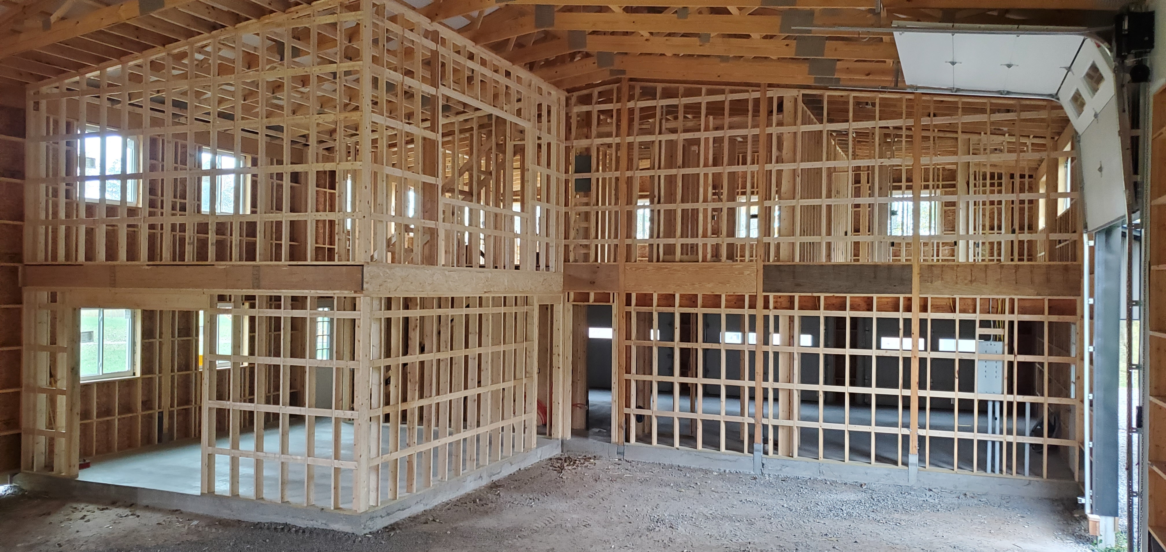

Just about done with the interior framing. Hopefully getting it inspected this week.
It has been a real slog doing 100% of it by myself.
Rough electrical should be done this week.

Just curious. Why is there so much blocking between the studs?

I've been following the build since the early plans, and thought the living area was all above the 3 garage bays? It seems you have an additional section right of the stairs and above that I don't recall seeing in the original plans.
Do you have a new layout you can share showing the living and shop areas?
It's looking real good, the framing looks tight and straight - nice work.

In that area I added upper and lower workshops. Neither of which are living space.
I wanted working areas that were separate from the larger shop. Areas that had better heat/insulation. Both areas will be for tinkering and assembling stuff, not areas that will have equipment. I want them to be sealed off from the main shop space which will contain dust and chemical fumes etc.
The lower workshop will have an 8x8 OH door in it for rolling in engines/etc that I can assemble in a clean environment.
Those areas were in the original plans though the upper portion was labeled "attic space". I've since added a transom window in the upper workshop overlooking the primary shop space. The building inspector might not like this due to fire code, but my argument will be it is a transom window between shop spaces, not between shop and living space.

I see that your overhead door track follows the slope of roof trusses. Was it a problem to have it installed that way? Do you know if there are limitation on what the slope can be? I would like to do something similar on a steel frame building where the slope is 5:12. Yours looks less steep, at least on the inside.
