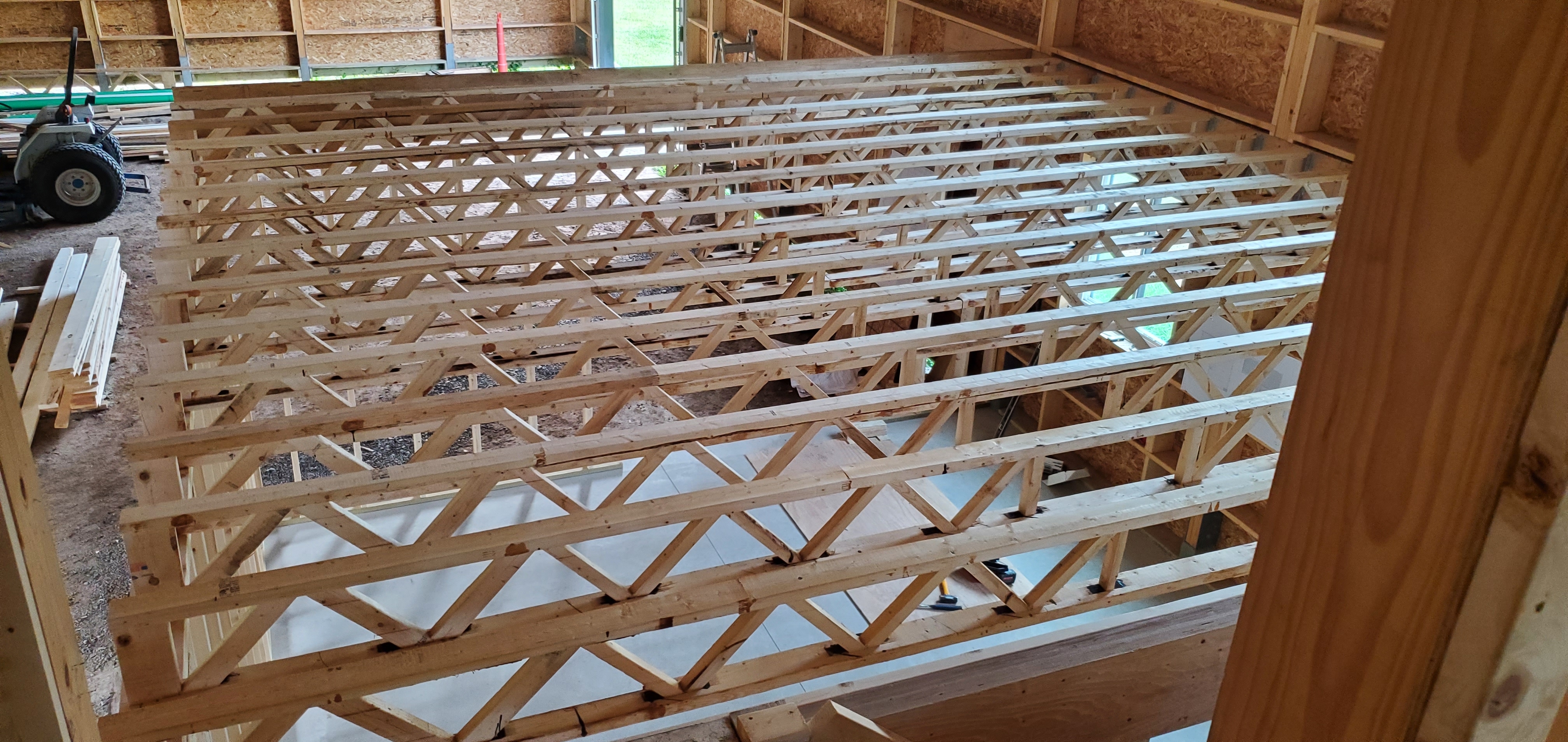

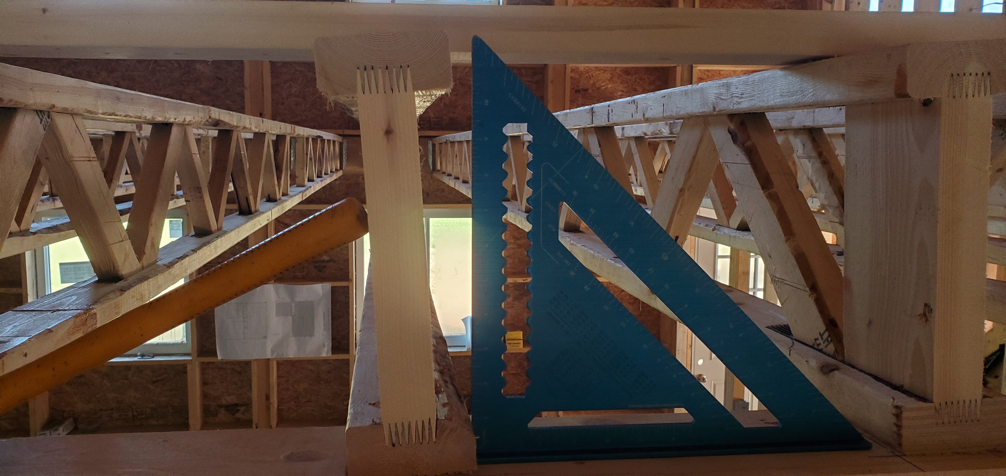

Working on the last bit of framing before I can get to the upper level radiant pex installation.
I am surprised by the open web floor joists, they are not very precise. They are twisted up more than I expected, takes some prying to get them vertical.
They also have about a 1/2" arch to them. I suspect that will decrease when the subfloor is attached.

I also used open joists on my 2nd floor. I wonder if the I-Joists would be any better from a performance standpoint after the house is completed.

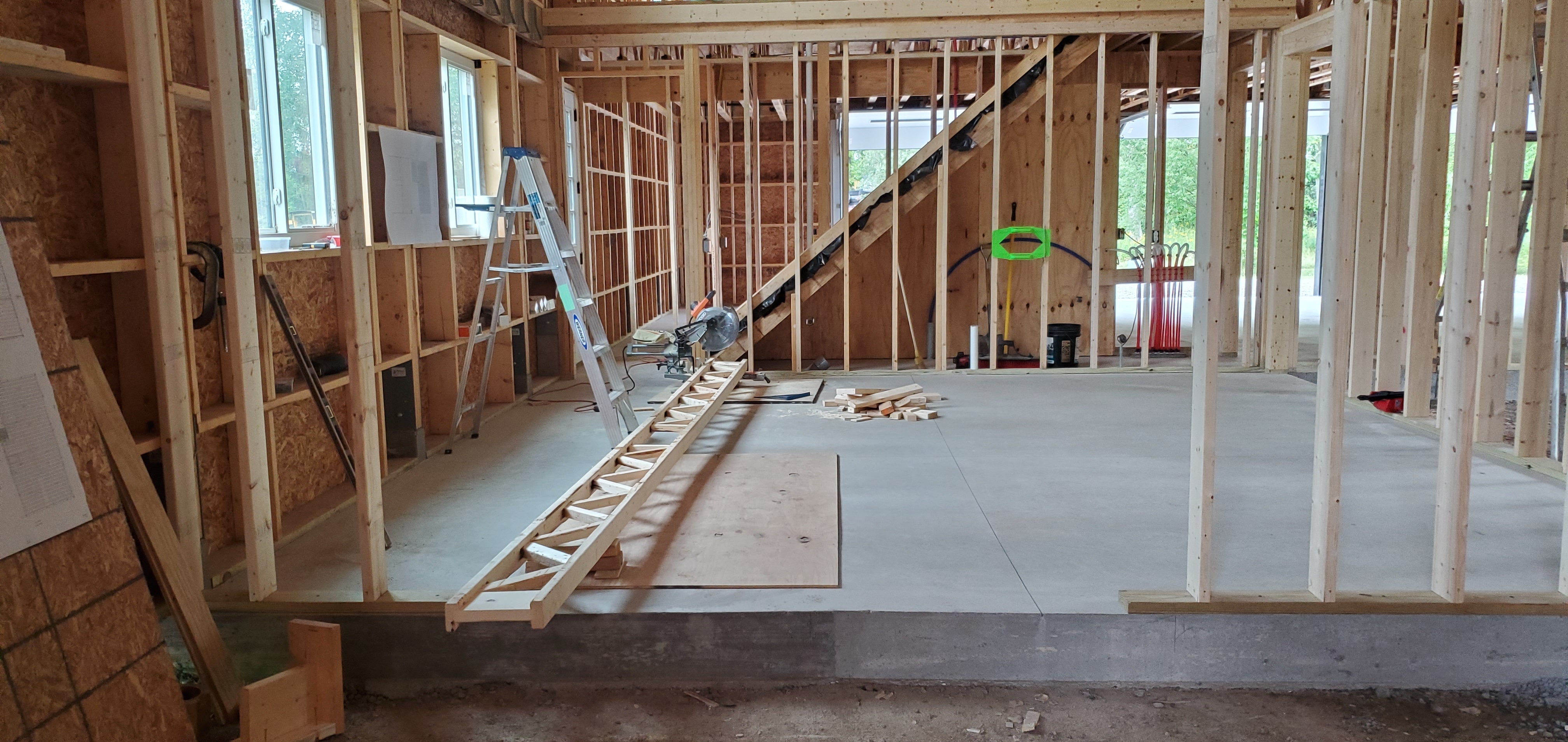

Looking at the side view of your concrete, I have to say that I'm impressed. That looks fantastic!!!
I've never seen trusses that didn't have metal plates on them. These must be some new technology with the finger joints and glue. I really like this style of floor truss for running everything through them.
