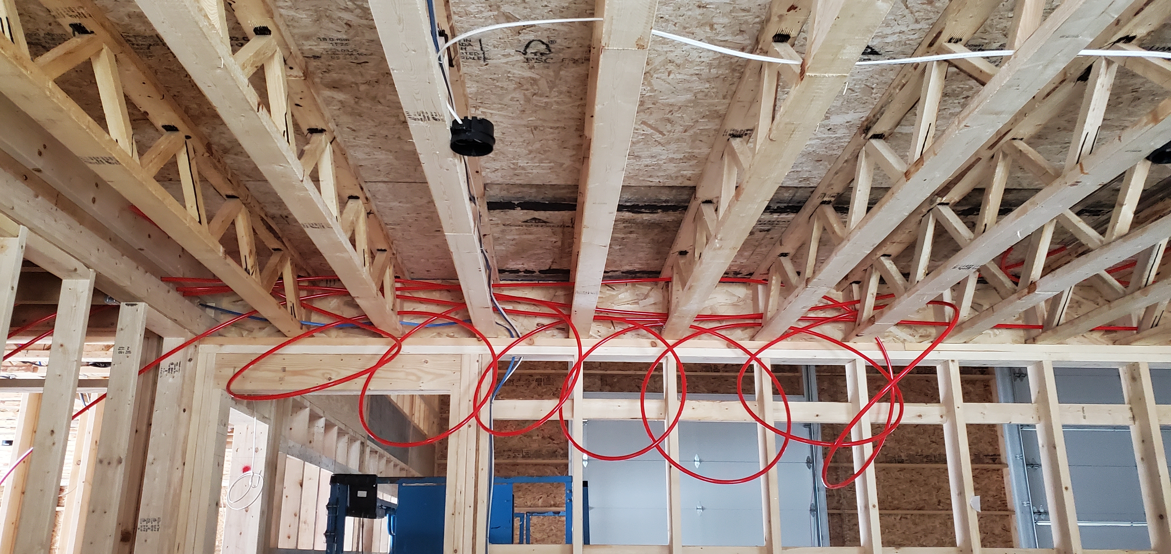

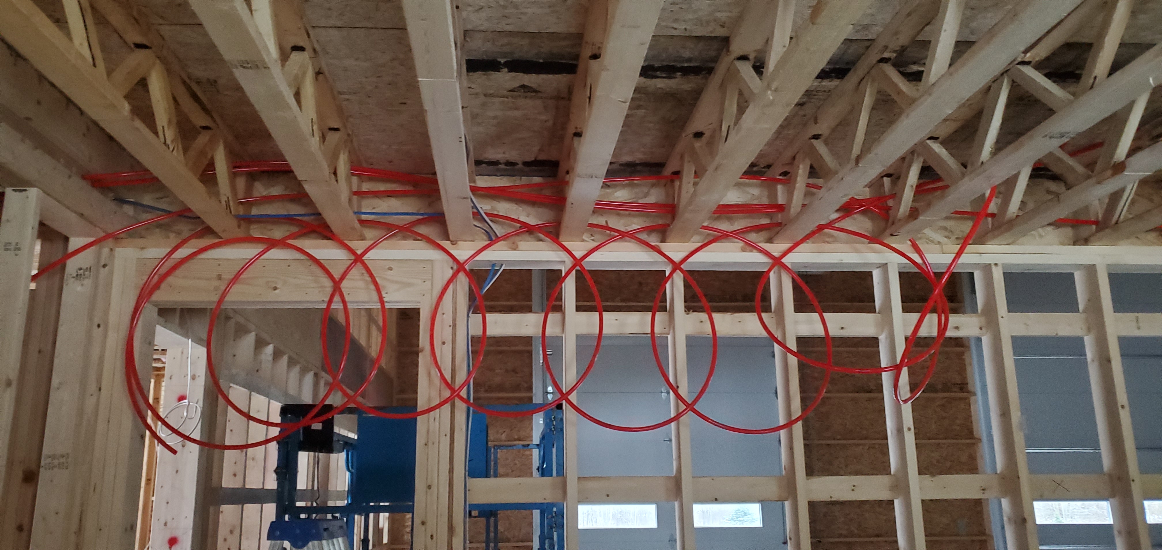

Almost done with the first two loops for the upper workshop radiant.
Fighting with this pex in sub 30 deg F temps is the worst part.
I'm not stapling the plates in until I have all the loops roughly placed to ensure I have no kinks. I want to have continuous runs with no couplings spliced in to fix kinks etc. I already had to pull out about 40ft of pex and 10 plates becuase a kink occured. Live and learn...

That's interesting. I have been using my cellphone in my building no problem so far. My structure has 8x8 posts and will have 7-1/4" of insulation on the exterior walls. So I'm hoping even with my less efficient radiant sub-floor solution, I'll still be better off than most traditional forms of heating. (Most homes here are forced hot air).
I also have radiant in the concrete floor below the second story, I expect to keep the garage & workshop at around 50-55F, which will help with heating the living space above.
