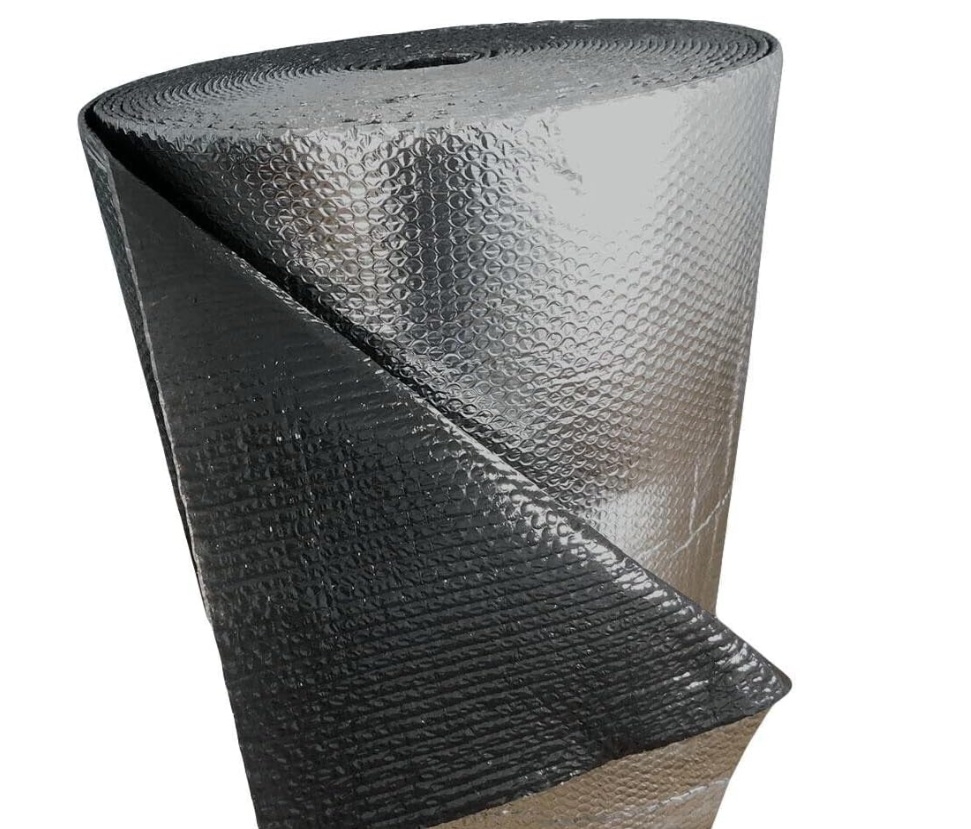

After the tubing and plates are all installed, I will be stapling "foil bubble wrap" to the bottoms of the top chords of the open web trusses, creating a 1.5" air gap. So the subfloor plywood is heated both by conduction and convection. Still not as efficient as tubing embeded in concrete but better than hot forced air into rooms via a furnace, blower & ductwork etc.

Does the foil bubble wrap dry out and crack over time? I've seen that in pole barns, but I'm not sure of the brand or if there are better types of it out there.
Since I have no experience with this, I'm probably way off here, but wouldn't foam work better? Cut it to fit between the joists and cover all of the PEX?

The water heats the pex tubing -> the pex tubing conducts heat to both the sub-floor and aluminum plates -> the warmed aluminum plates and the plywood sub-floor radiate infrared light downward away from their surfaces -> the foil bubble wrap reflects that infrared light back up towards the sub-floor and plates adding additional energy. The infrared light will bounce back and forth between the plates and the foil, but some of that energy gets absorbed by the plywood subfloor, some of it diassapates into other parts of the structure like the open web trusses and is lost via conduction out to the OSB sheathing and then the steel siding which is exposed to the outer elements.
The foil bubble insulation R value is pitiful, only like R2, but, the foil radiating the infrared light back up is the important part.
Underneath the foil bubble wrap will be fiberglass insulation to keep heat in the shop & garage produced by the pex in the concrete floors. Some of that heat will of course migrate up and heat the rooms above.
I would not be using this type of heat if I didn't have pex imbeded into the concrete in the shop/workshop below the second level living space.
Your understanding of how it works is a lot better than mine.
I've read a little on reflecting light for heat, but I honestly don't believe any of it. I'm very basic and simple thinking. Sometimes that works for me, sometimes it ends up costing more, taking longer and nothing is any better.
My brain is telling me that I would want to stop every bit of heat leaving the PEX that's going downwards, away from the floor. To me, it looks more like you have a radiator type design that will cool the PEX with air all around it instead of a heater that will focus the heat where you want it.
