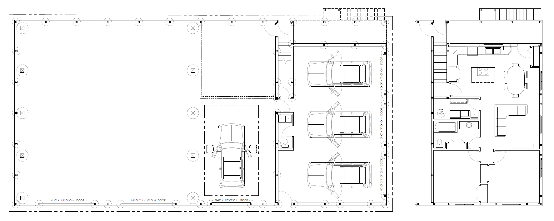

The columns in the 3 car garage were eating away at me for a week so I changed to 16" I-Joists. Bedroom and Den don't have full 8ft ceilings for ~4ft near the south wall but I could live with that more than the columns:
Excellent modification.

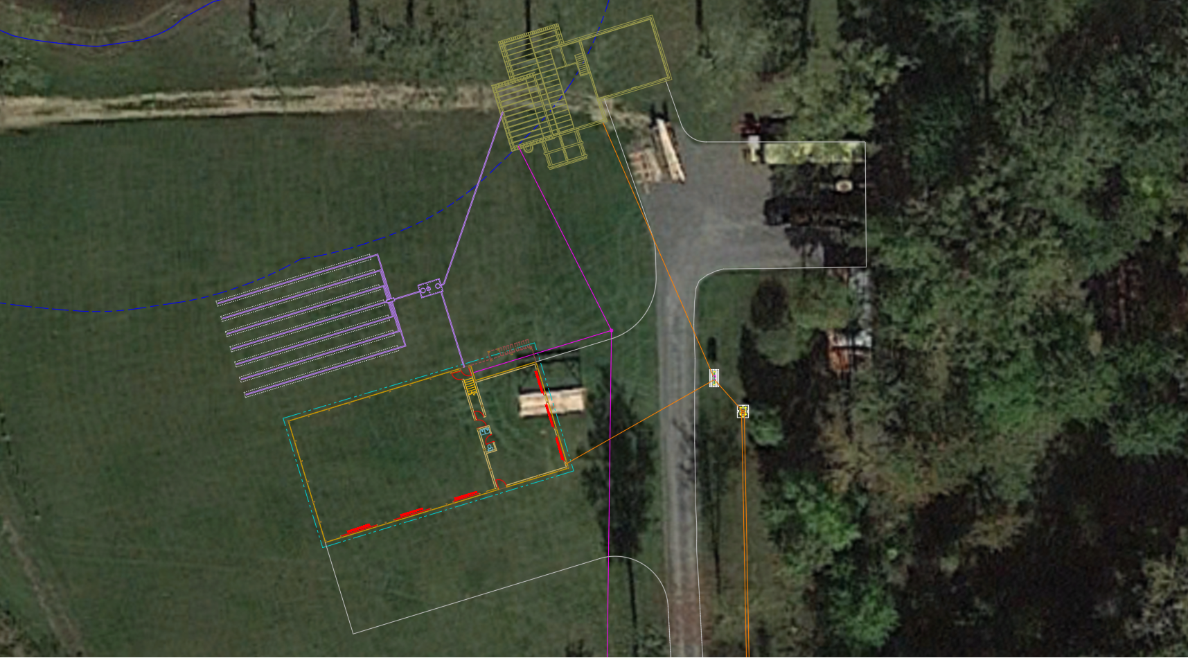

I THINK I might finally be on the path to a final Barndo config:
My site layout has my Barndo and stick frame house both in there where I originally planed. Think I'll stick with that plan, no matter which I decide to build.
