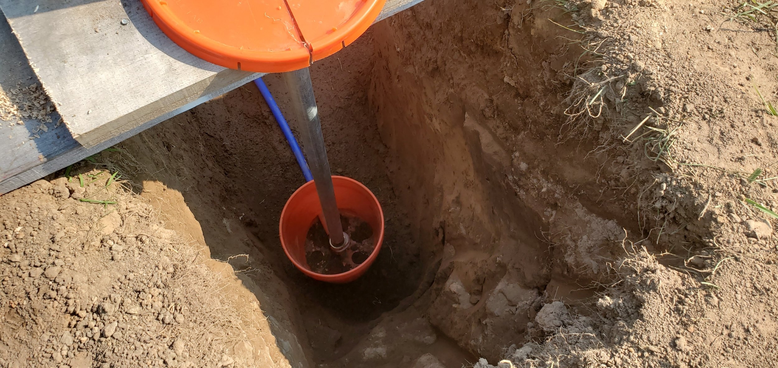

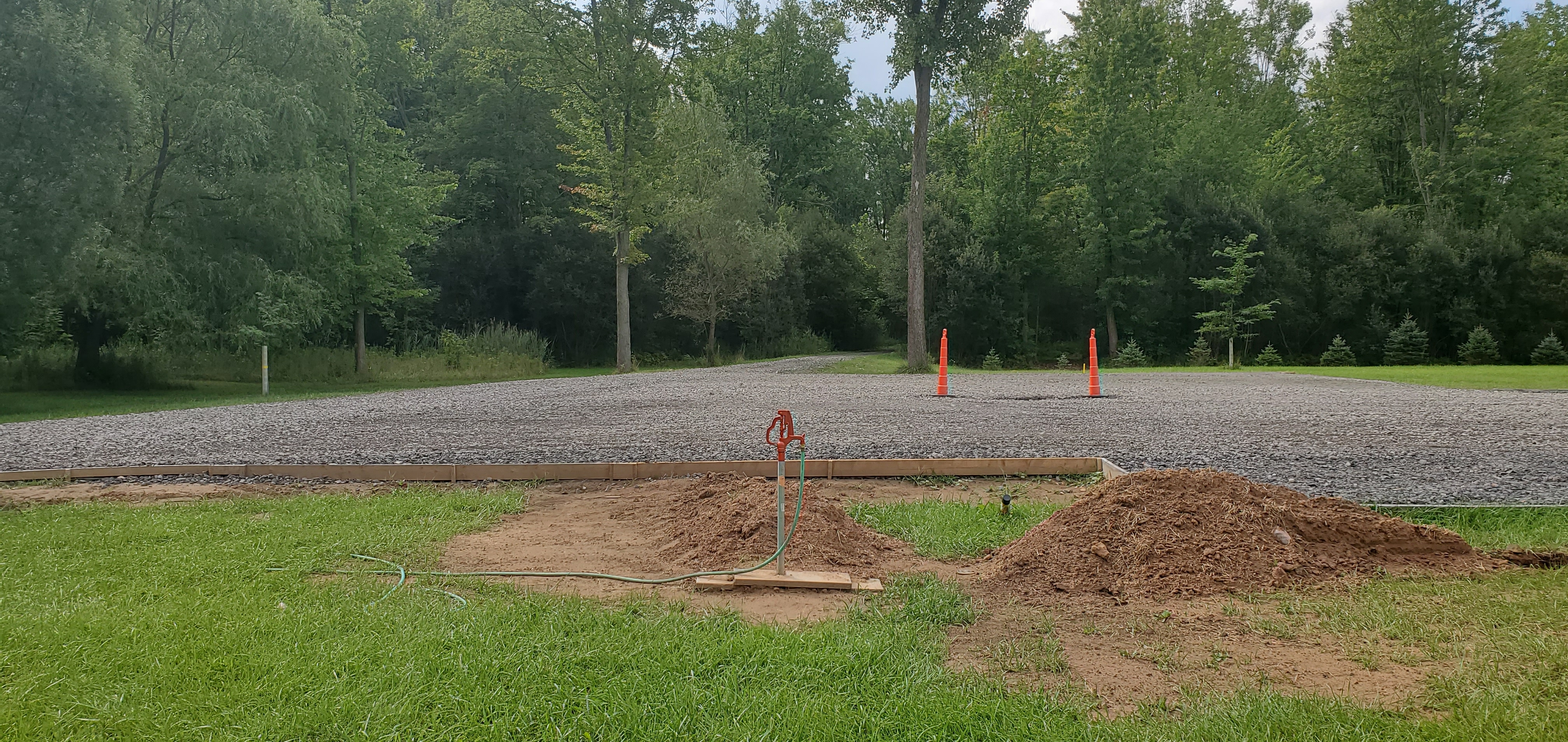

Got my water far enough along to have the water company come turn on the water to check for leaks.
Hopefully there are no obstructions in the line anywhere because I already hooked up all the fittings.
I don't want any spigots on the outside of the structure, the yard hydrant will be the only water source outside the building.

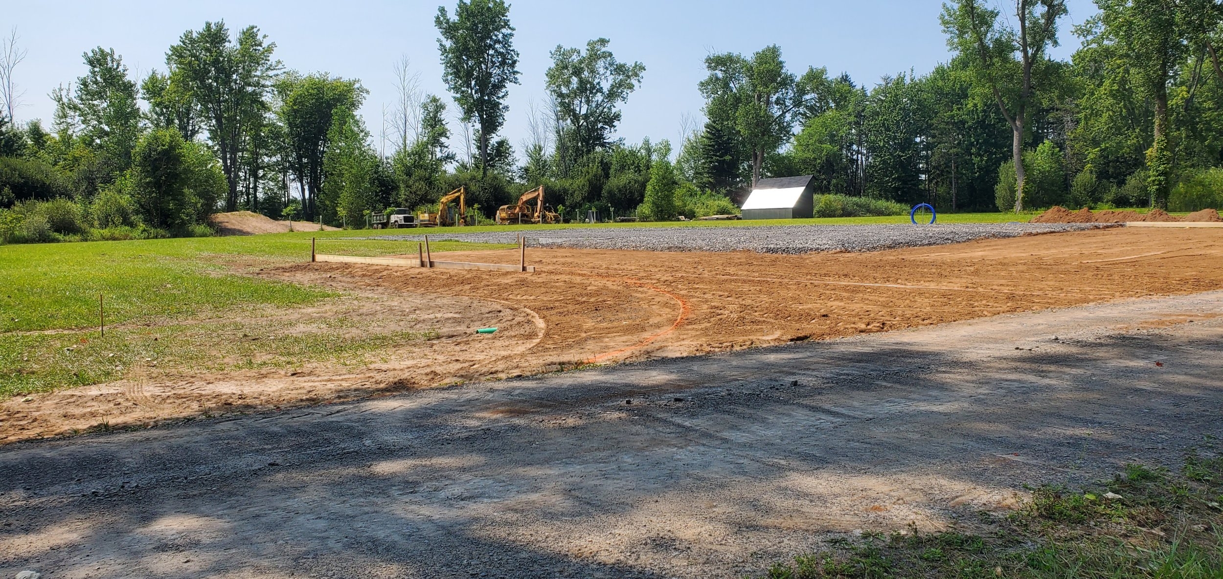

Final grading of the approach, started on the forms for the stone. Ran out of lumber for that, but it was too hot outside today to get my sawmill up and running to mill more lumber. I have not used it yet this year. It's still covered, and a bunch of weeds growing up through it.
The grading worked out well for me doing the vast majority of it by eye. I was only off in areas by about 1 inch form where I wanted to be.

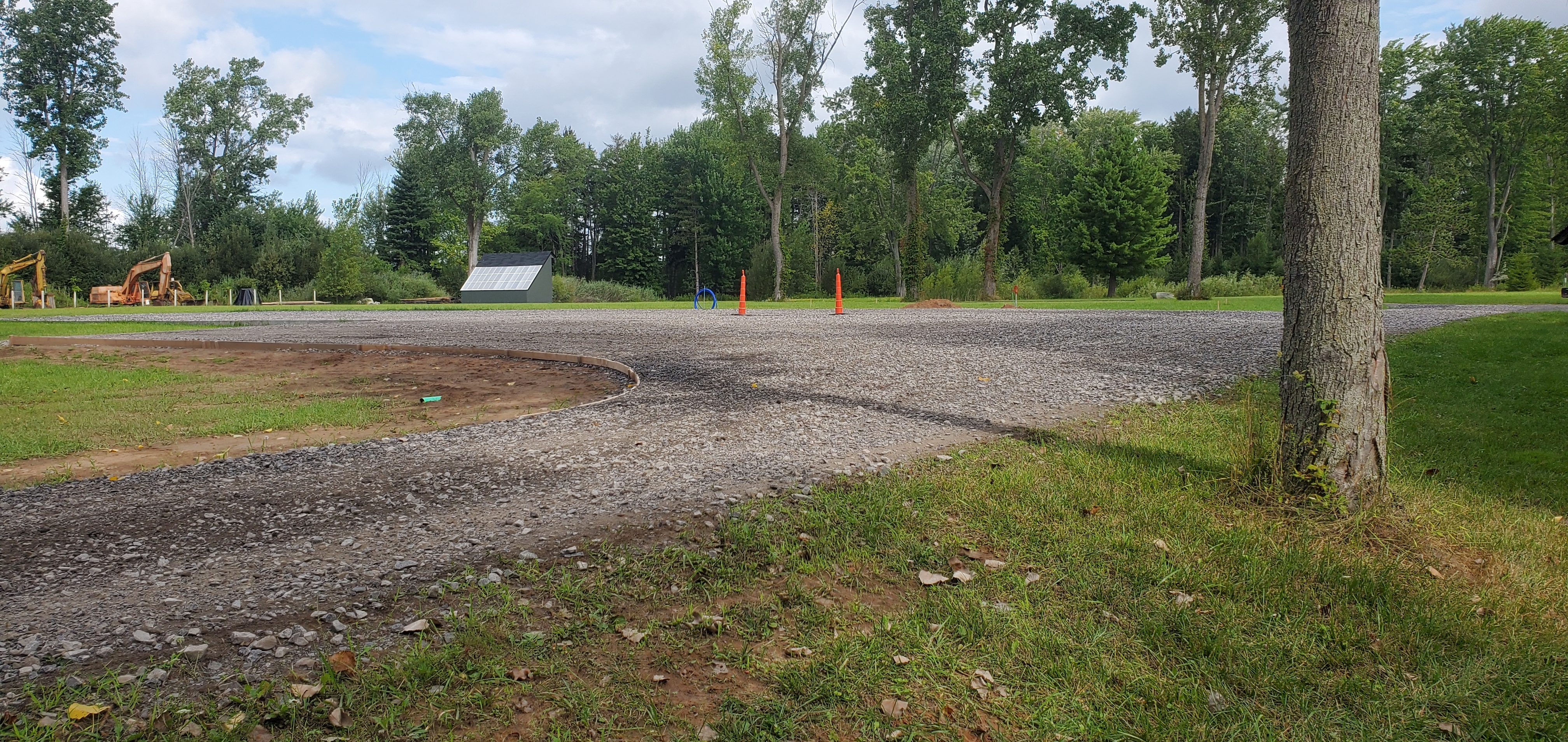

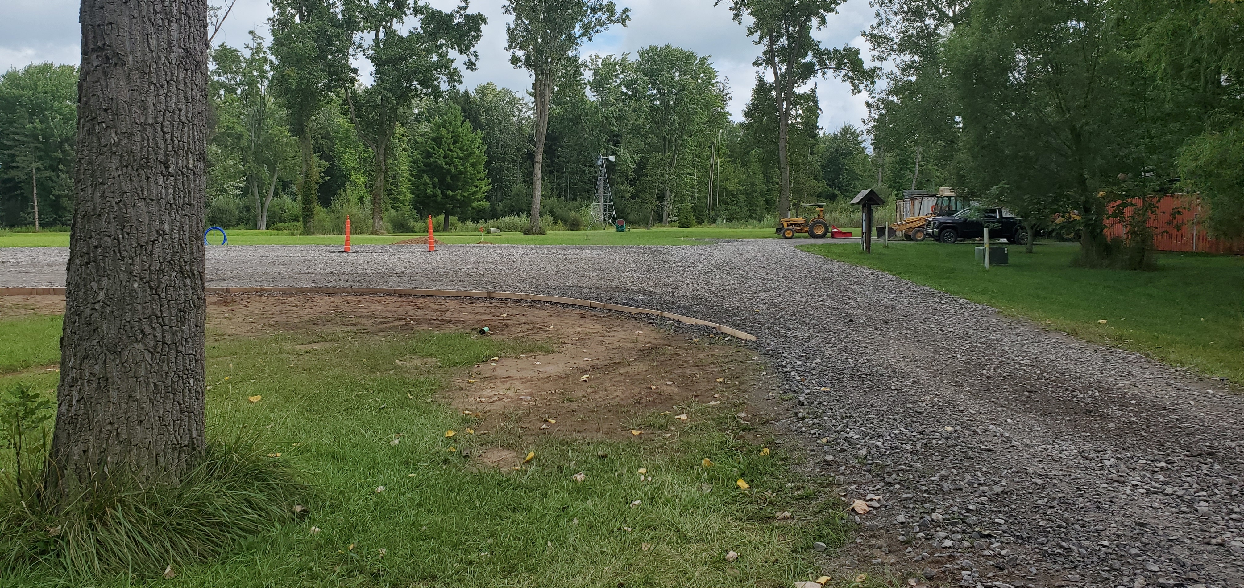

Driveway approach is completed, for now:
Hit a bit of a snag last week. The transmission in my 2013 GMC 3500HD stopped moving. 190k miles, was hoping to stretch that vehicle out past this barndominum build, but had to go buy a new truck:
Took the dealer a week to get this truck for me, not even the color I wanted (wanted black). Also hurts my cashflow for this build project.
It seems like I found a GC, he took all my stamped plans and is getting a building permit and hopefully we can get going with the build soon.
I'm pretty much done with all the site work except a drainage basin and landscaping up to the forms I have in for the approach.
Those forms should last until next year if I need them to, so not in a hurry to get the landscaping done.

Is that for fewer penetrations of the building, or are hydrants better in some way? I'm going to have to make that choice soon.
For me, hydrants are far better as they don't freeze. Any burst pipes I've had are with spigots back freezing. Hydrants drain down to below frost level when you shut them off. I use the Iowa Y34s.

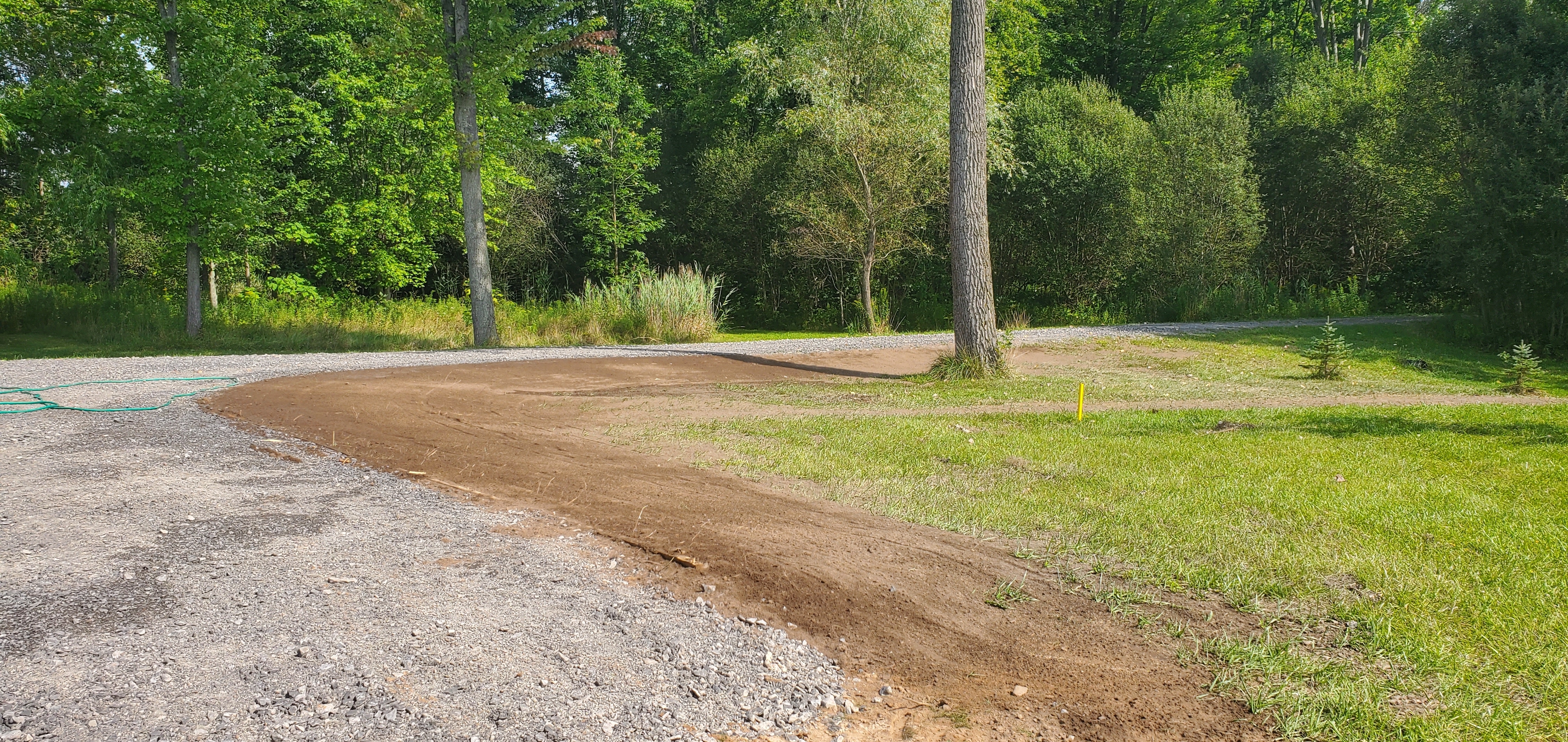

I a still looking for things to do pertaining to the site work, so I landscaped on one side of the approach:
I plan to make a concrete catch basin on the other side of the approach with a 13" diameter cast iron grate and flange cast right into the concrete with some all-thread studs or the like. However, the grate and flange are going to take 6 weeks to get, so will be well into Fall weather before I get to that. I don't like how pretty much all the catch basins you can buy are plastic...
