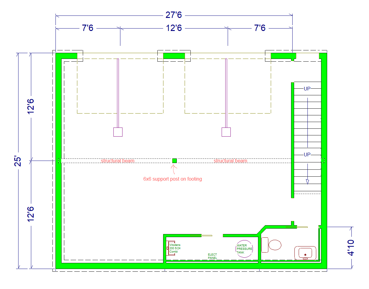

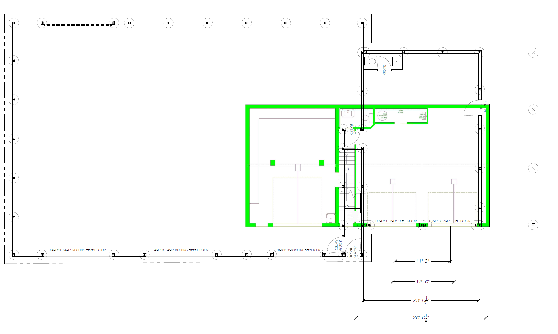

I overlayed our floor plans. Looks like your door spacing is about 15" wider, and overall the inside of your garage is about 3ft wider.
Do you have work benches & shelves on the inside of the garage? The plan is for mine, just parking, no clutter. I have the rest of the shop for benches, shelves, toolboxes, etc.
If I make the garage wider I might have to move from 14" tall I-Joists to 16" tall, losing headroom. I don't want any columns inside the garage, want a clear span ceiling.

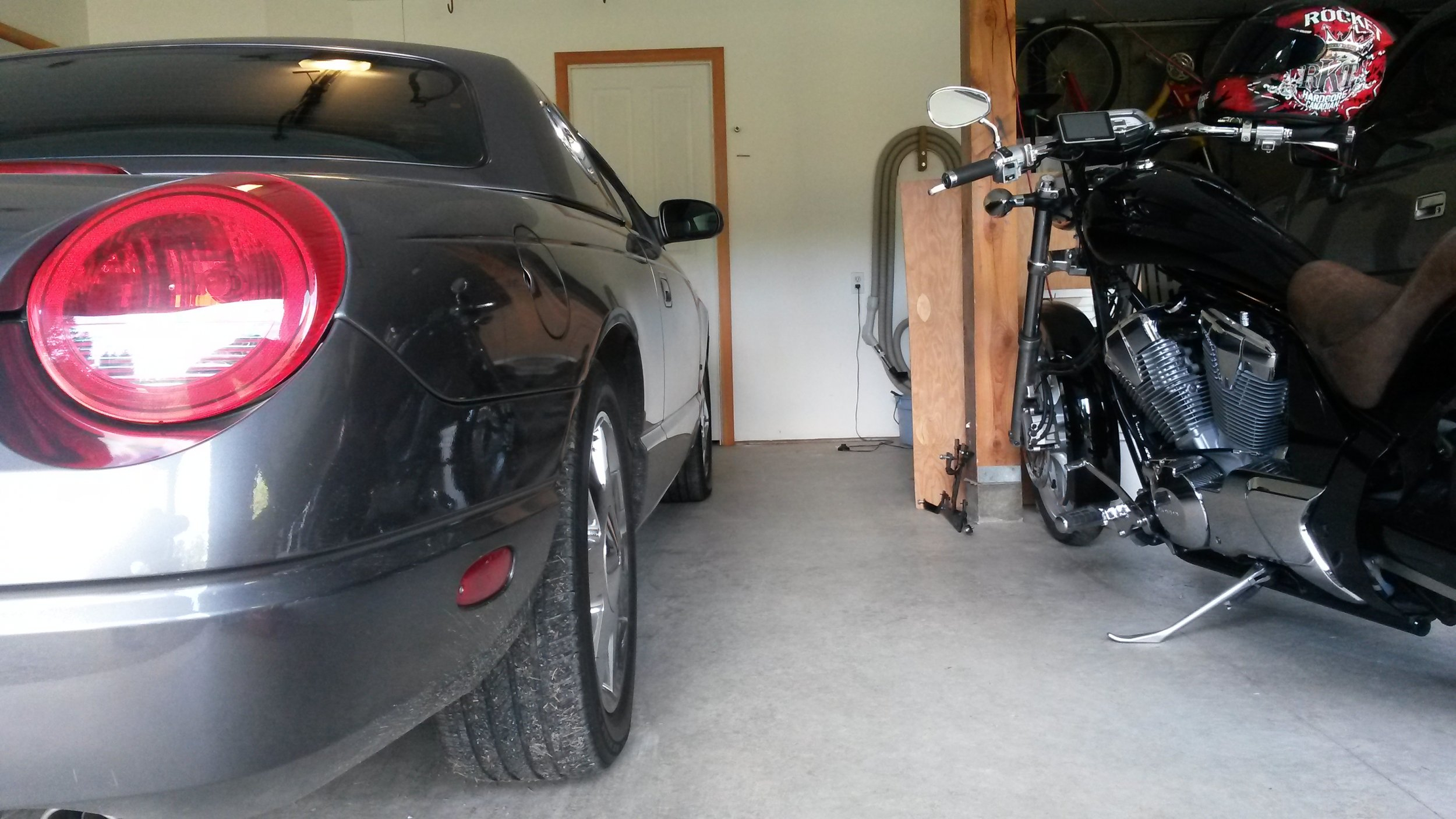

You nailed those dimensions! Sorry I missed your 2 pc bath in your garage on my phone screen :rolleyes: On my 34" desktop now. I will say my garage is just right for 2 intermediate cars for width and length BUT as we accumulate STUFF it does get crowded though manageable. Extra length like yours would be quite helpful for more hoarding. A good purge is in my future, no doubt. I could fit a full size pick-up on the right I should think. My pick-up is only 12½ feet long with a 4 foot bed so no worries there.
I do have a post mid span which actually comes in handy for hanging my helmet, jacket and battery maintainer for the Honda Fury parked between the cars :).
No work benches or shelves inside the garage and I definitely would not want to reduce the door spacing or overall width.

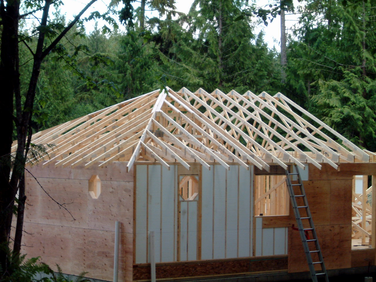

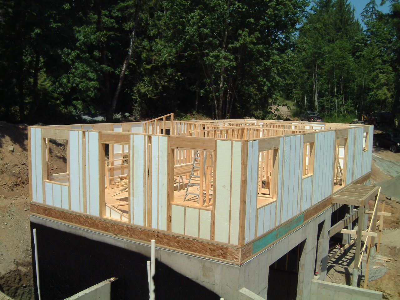

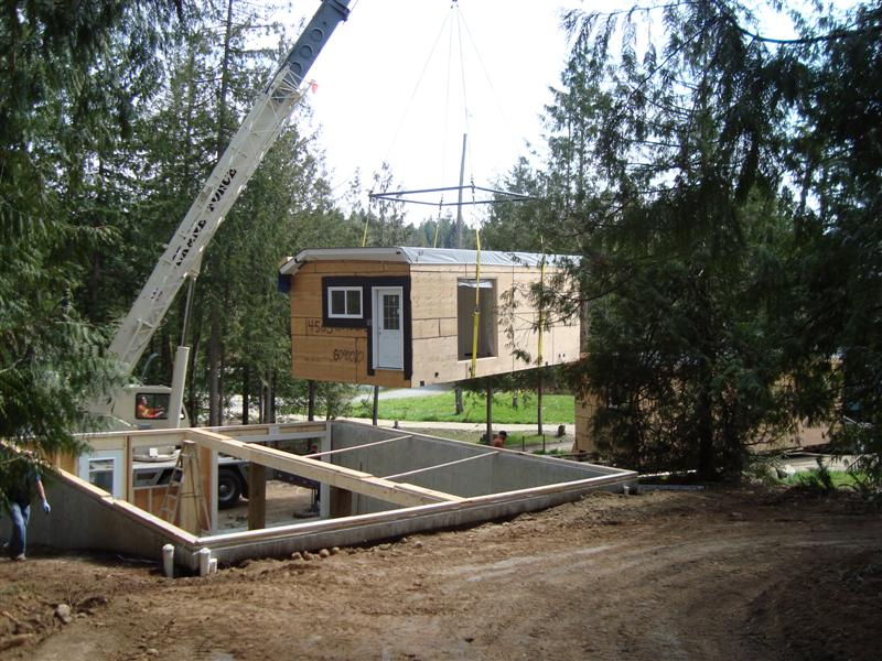

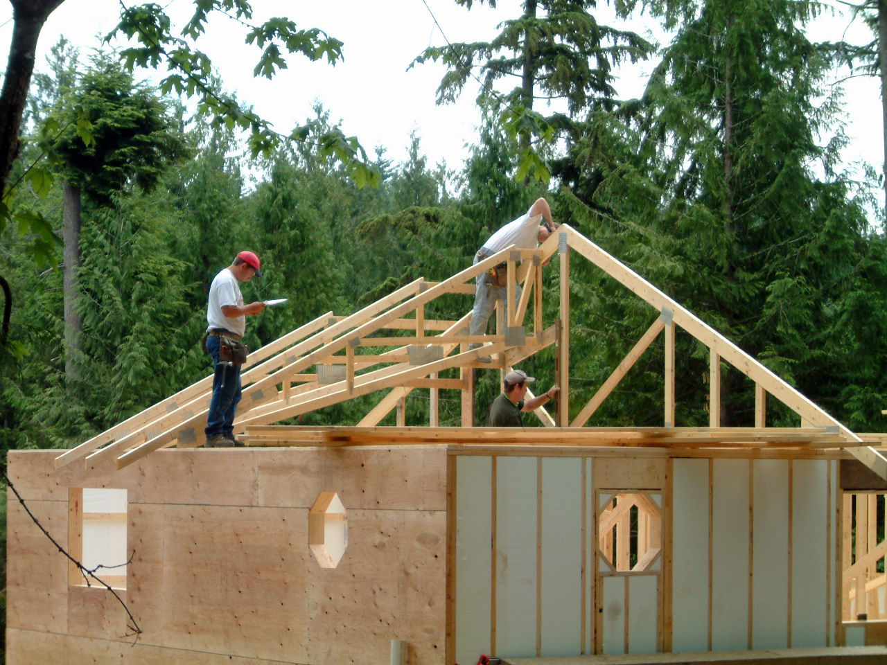

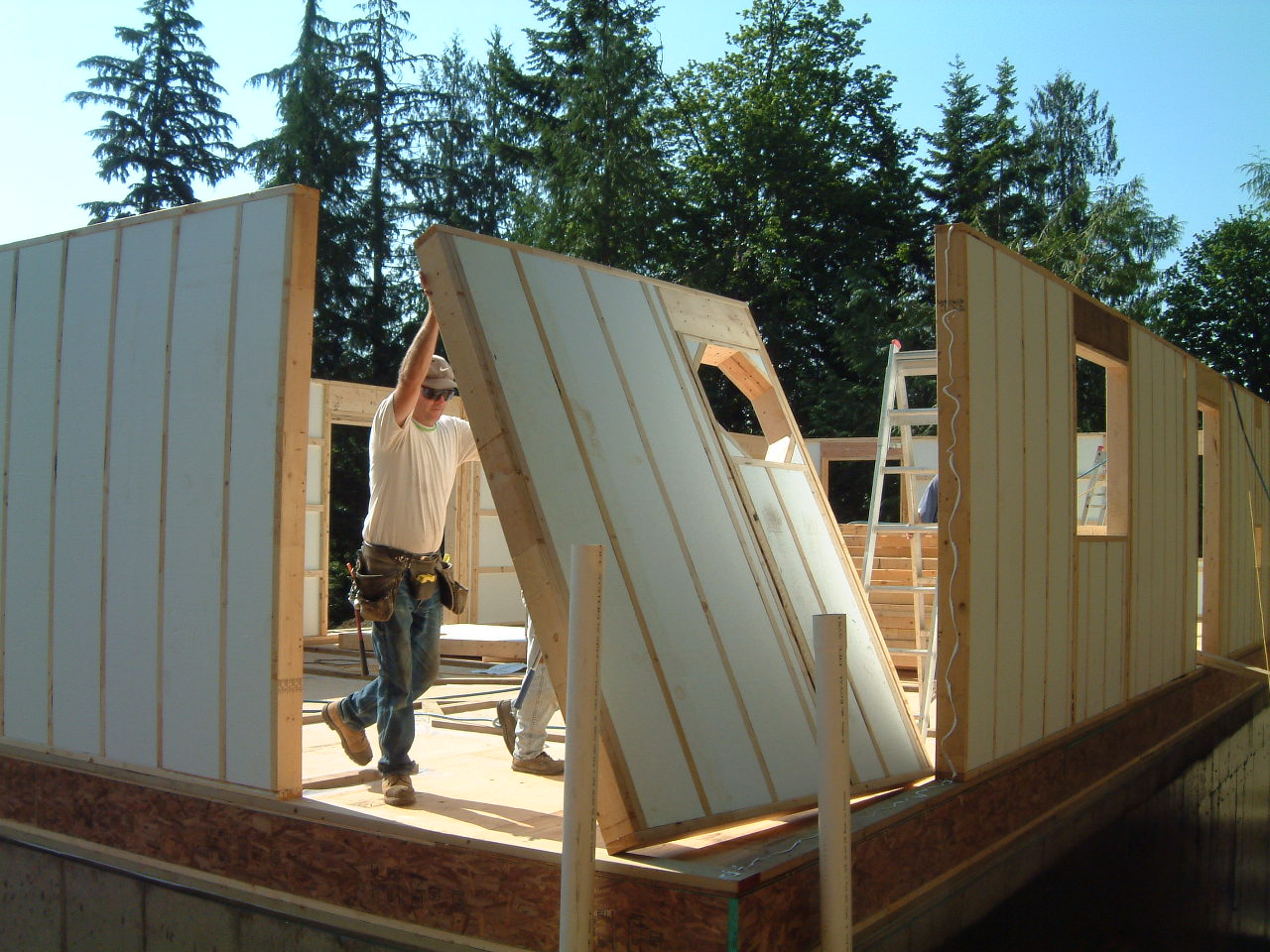

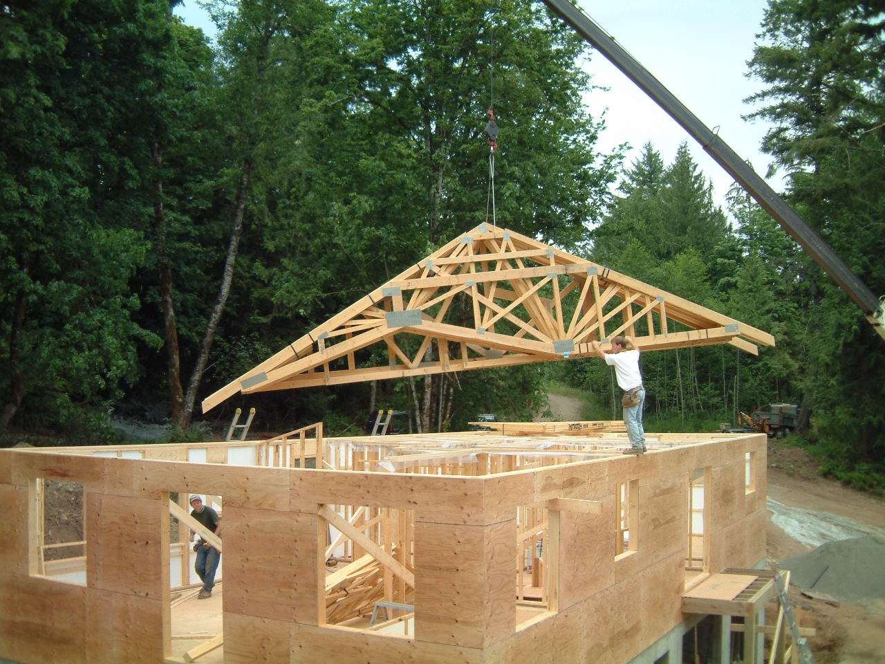

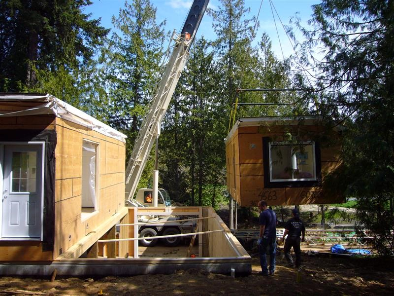

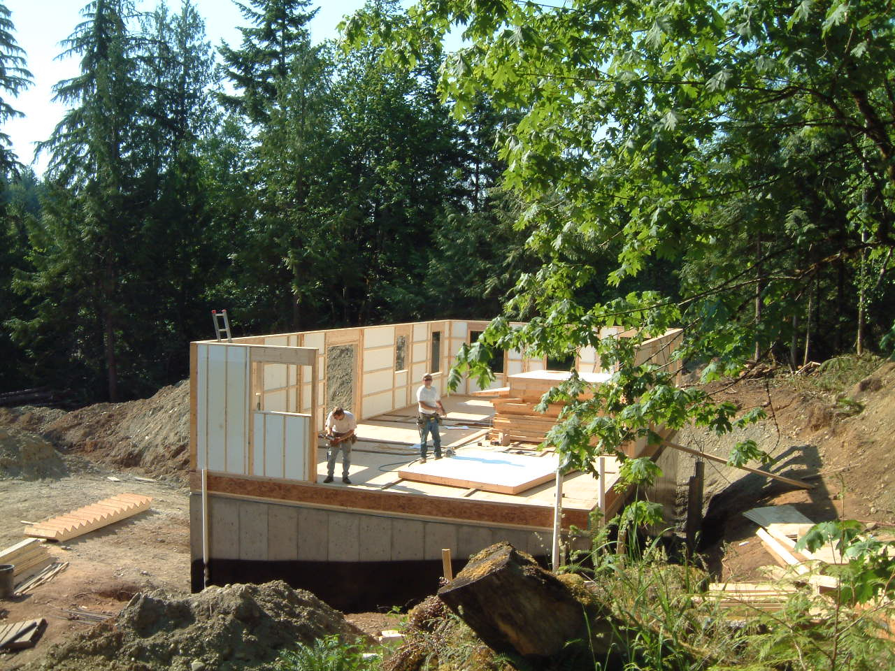

I've been a bachelor all my life too, so, at 60 I decided it was time for a good dog and a house for ME. Started off with a 600 square foot log cabin design I liked which grew into 1250 square feet on top of a basement 2 car garage and a vehicle hobby shop in my 3D Home Architect software. Broke and 5 years to pension, I hung a sign on the road stating Vehicle Repairs. Low and behold my lady of 20 years now, came rattling down the driveway in her tired 16 year old Subaru. The rest is history, LoL.
In 2009 I designed and built a 840 square foot home for my mother. Her investment for rent covered the cost so it was a no brainer. After she passed at 94 the cottage sat empty until 3 years ago when my better half sold her house and moved in. Now we share both homes but maintain our own spaces with zero conflict 🥰.
As a point of interest, my home used factory built rigid foam insulated walls that went up in half a day. The cottage was manufactured 800 miles away, transported, cut in half and dropped onto a 2 car garage built into another slope (no surprise there). Another same day effort. Of course both houses required roofing and siding. Mine also got windows, doors, plumbing, electrical, hydronic heating and flooring, all of which was preinstalled in the cottage albeit forced air electric heating.

Regarding the shop, there is no question that a much larger space would have been ideal. I managed quite well during the 5 years doing vehicle repairs but now that I'm immersed in the original purpose of doing a body off drivetrain swap, space is at a premium. I have the body on a pair of trailer wheels that allows me to move it (with my tractor) back and forth from the garage as needed. Would love to have a separate wood shop too (sawdust and all) but that ship has sailed, in fact it never made port!

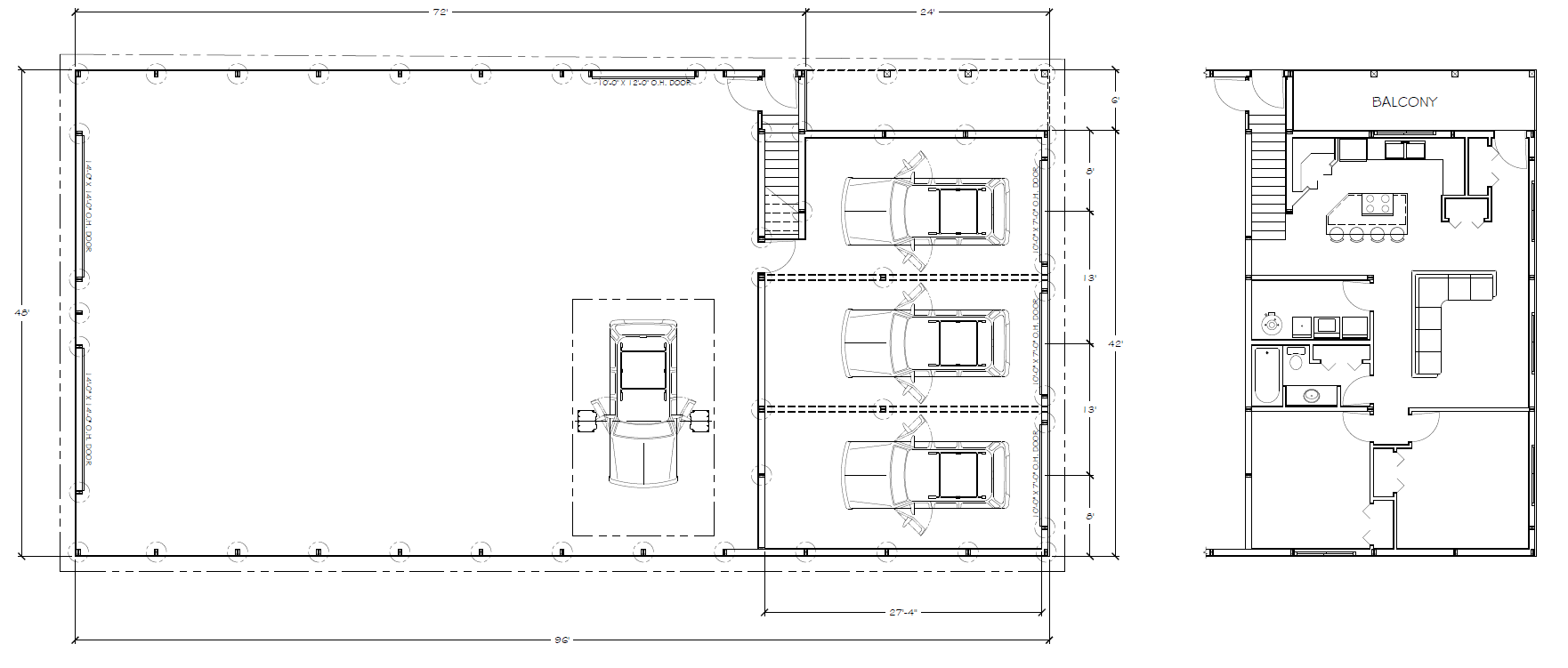

So, been wanting to build at a lot that I have owned for nearly 20 years now. I think I am finally in a position to do so, albeit at the worst time to build... That's my luck.
I have attached my shop/living space design. Talked to various residential and post frame builders. Many of them suggest bookshelf framing the garage and upper living space portion of the structure. Most of them recommend sheathing the garage and living space walls with 7/16" OSB and the living space roof with 5/8" OSB before the steel siding and roofing is installed. One of the builders thinks that's just a waste of money and that the steel provides the anti-racking for wind loads just fine. Thoughts? Will drywall in the living space be subject to more cracking without the sheathing?
The 10 X 12 OH door bay will be for a 2 post asymmetric truck lift. The 14 X 14 sheet roll doors will be in a 48 X 48 area where I'd like to have a 5-7 ton bridge crane someday. Want to go with sheet roll doors to make sure the doors do not interfere with the future shop crane.
The living space is minimal, per the municipality, I cannot go under 900 sq-ft living space, this design ends up at around 990 sq-ft.
I have also attached an ICF design as the "real" house option. Both designs are of my own making, but RA's have looked at both and they will be stamped, which is required in my area.
One of the builders is looking at both of these designs and will be pricing out the builds for me. (For either design I will be helping with labor wherever I can digging my own trenches, etc, but I do have a fulltime job) If they are similar in cost, what would you build? This would be my final residence, so the decision is a life decision...
I really want a shop ASAP because I am almost 50 years old and sick of working on my equipment outside in the weather.
At the same time, a "real" house would be nice as opposed to living in a barn. Not to mention it is an upper story with stairs that I will have to deal with the rest of my life.
If I were to build the ICF house, that puts out my shop probably at least another 5 years.
The ICF house design has a decent garage and will have provisions in the floor for the asymmetric truck lift. So I will have somewhat of a shop to tide me over until I put up a larger structure for working on my equipment. (Not an contractor of any sort, equipment is personal/hobby stuff).

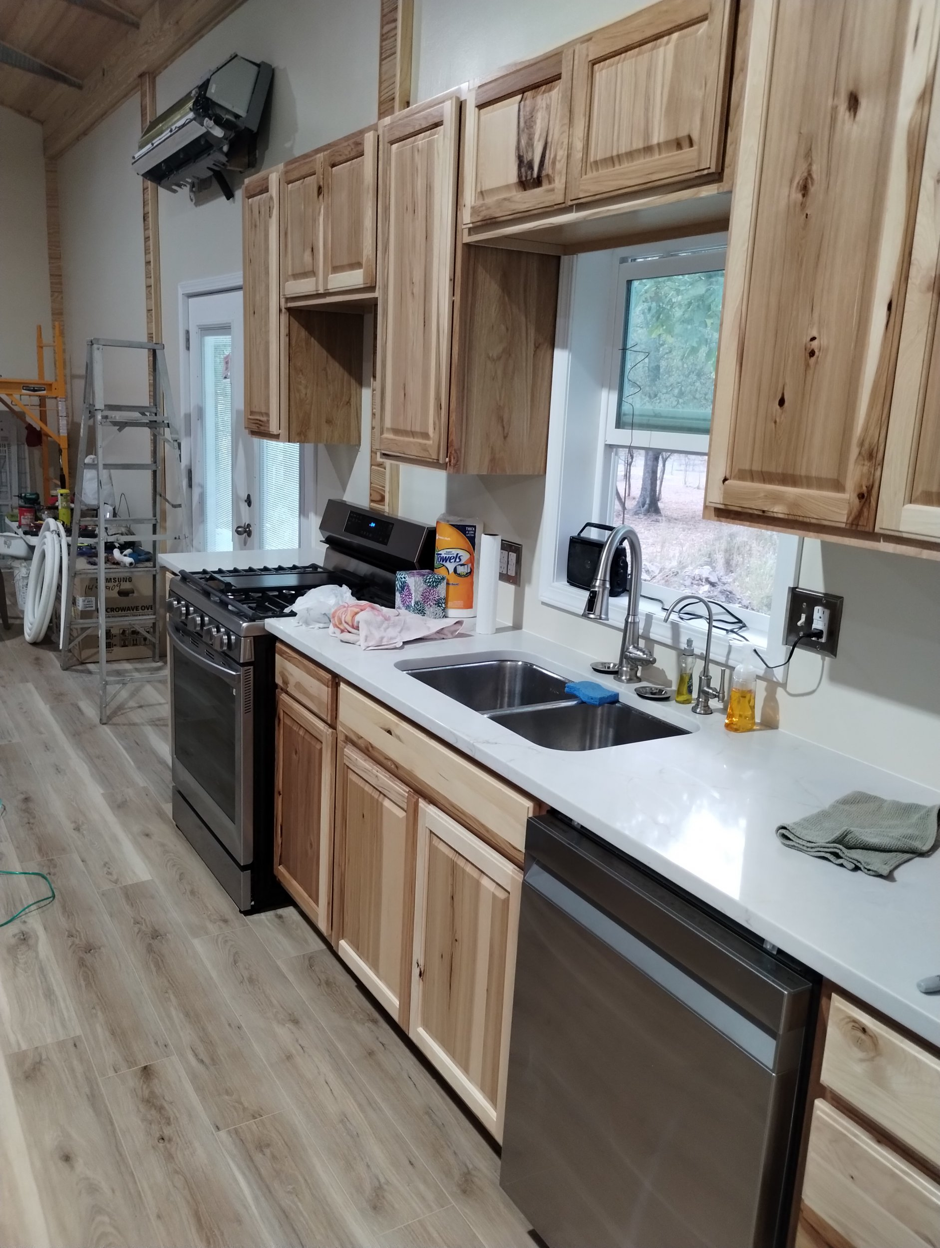

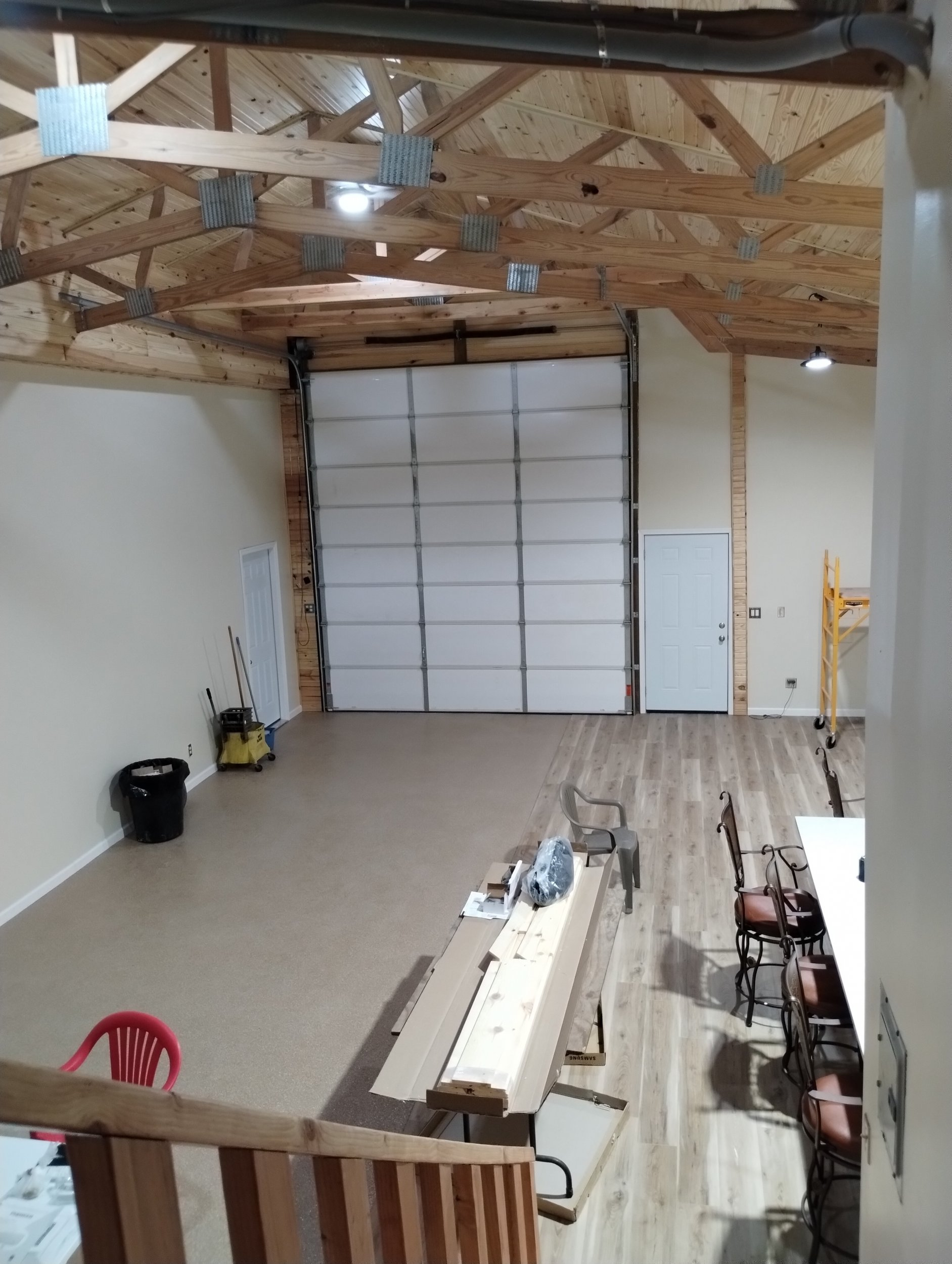

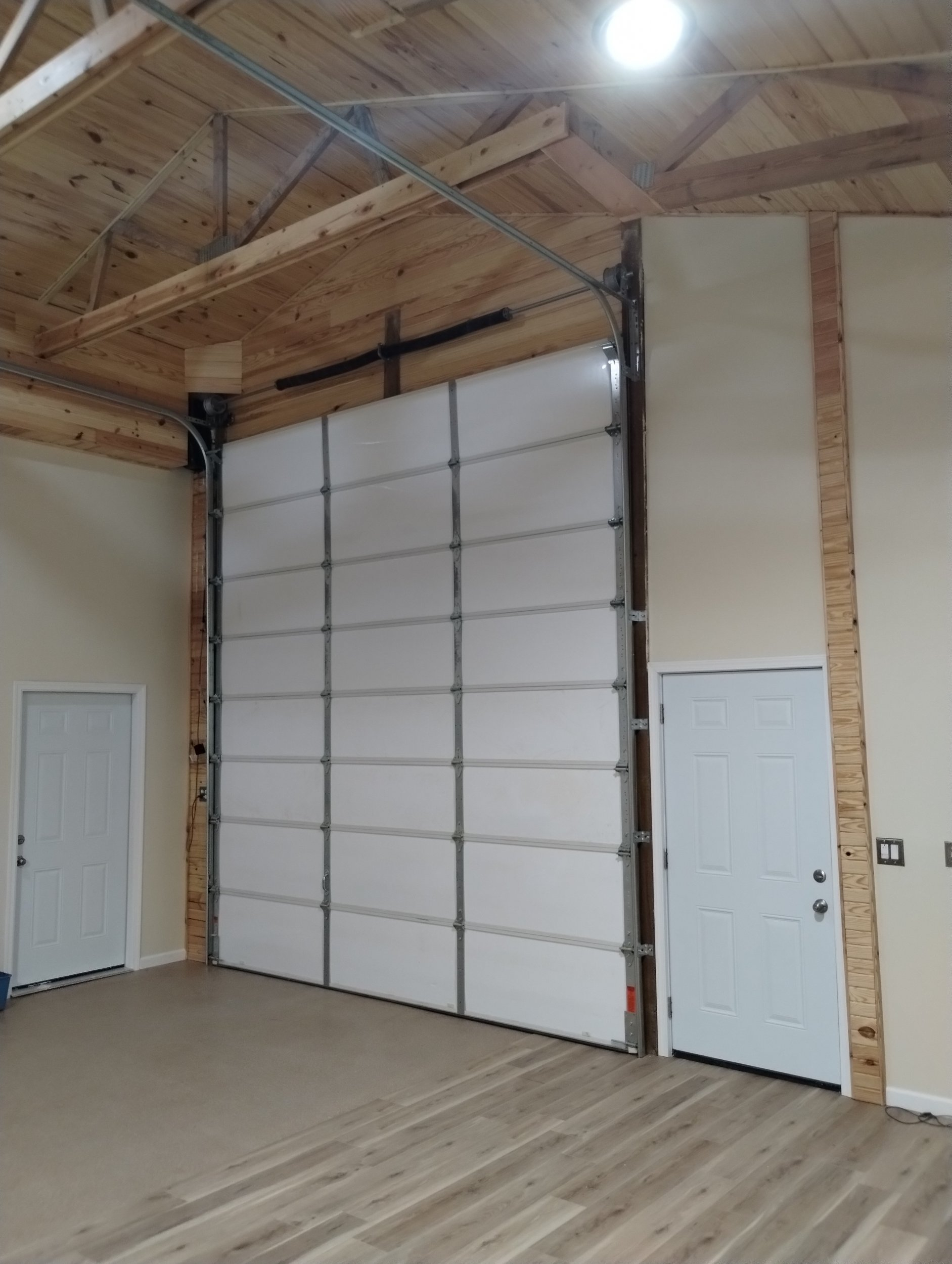

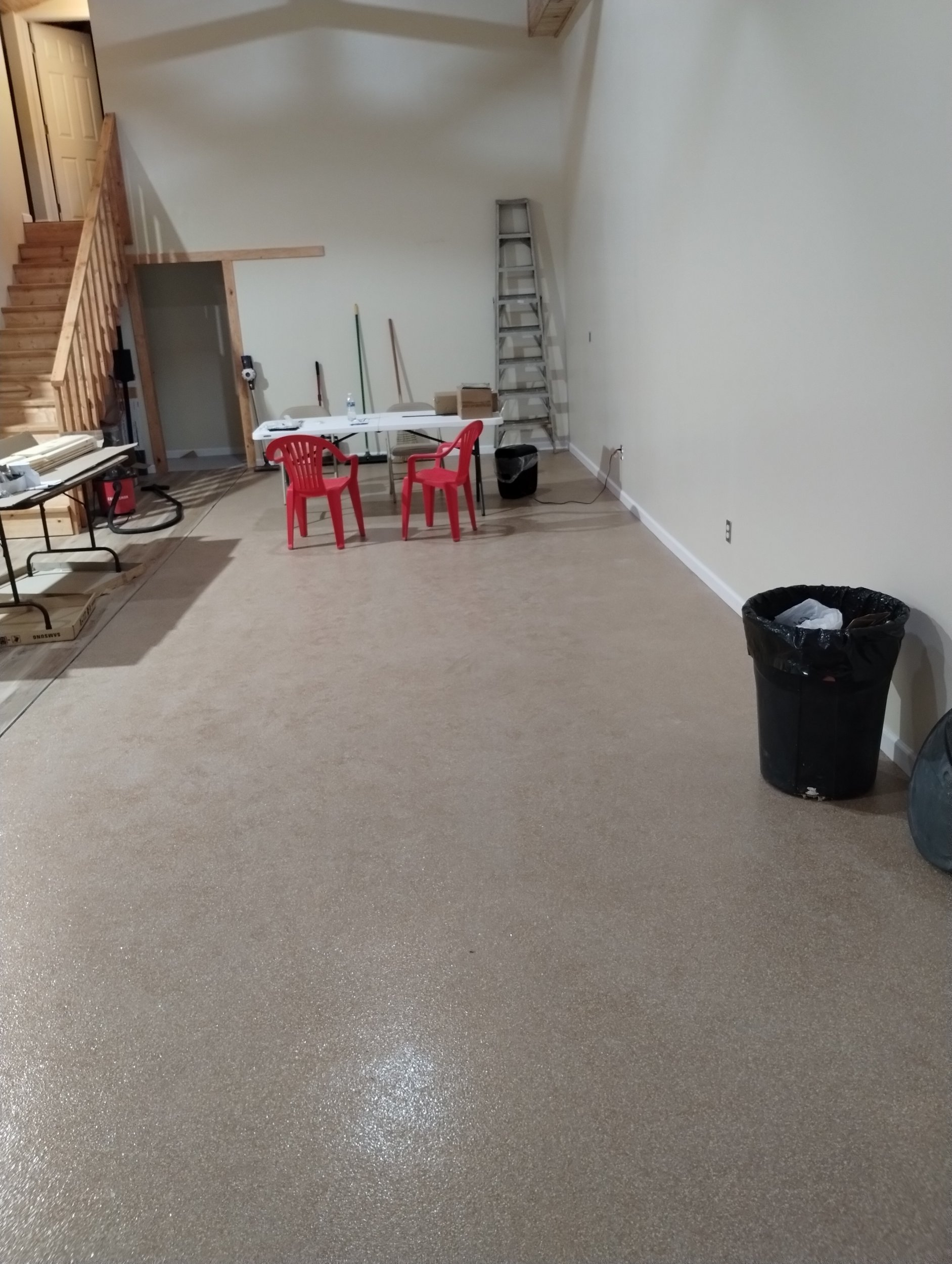

Barndominium is the way to go. I have one and it costs less to build. It cost less in taxes. If you don't mind living in a building that looks like a barn or a shop. I bought property with a metal pole barn on it. Already had electric. I ran water and sewer lines. Divided it off for dwelling and shop. Installed mini split systems for heat and air. Before sheet rock I had spray foam insulation installed. Very happy with my new house and shop. Cost less and less tax money out the window.
   / Barndominium/Shop or "real" House? #157

Wow, what a thread. I haven't had time to read all the entries, so forgive me if I am repeating something.
I agree with the concerns about noise, smells, fumes, and fire issues with a residence in the shop building, but if the construction is well done and well sealed, it shouldn't be a huge issue. I think the house and shop separate would be better if the cost is workable. I am pushing 60 and have had a couple of injuries that made stairs impossible for a few weeks at a time. Living in a 2 story became a real problem.
I had the thought that rather than build the residence on an elevated platform in the shop building, why not put the residence on the ground level and have shop and/or storage space over the residence? This could be a wood shop, or some other "shop" that doesn't need the big shop area. Anything heavy can be lifted up there with a forklift or tractor FEL so you don't have to muscle it up the stairs. This would also enable the house to have doors directly to the outside in more than just the front, so egress in case of fire is much easier and more reliable - sort of mitigates that problem.

Another redesign. I took a look at my 24ft wide garage and it was a bit too tight, so rearranged it into a 3 car garage. Much smaller deck/balcony. But I'd rather have more garage space than a huge deck.
There are now columns in the garage with dual LVL beams attached to rest 2x12 joists upon. No more 14" tall clear span I-joists.
Roof design is much simpler now, all the same trusses.
I think this design should be a bit cheaper than my last.
Still need to put in the shop bathroom.
