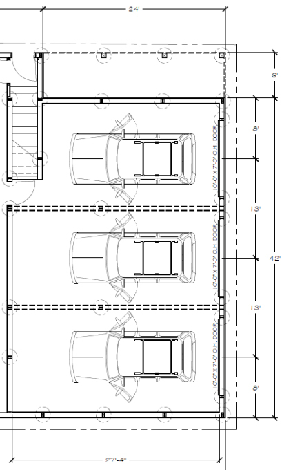

I'm glad to see you expand the garage out to 42'. I had a 24' for a few years and it got narrow real fast.
And about the columns now in the garage. A friend had them in his and while they were needed to hold up the house, they sure were a pain in the ax to work around, and not bump into them.
Yeah, that's why I had it at 24. I don't like columns, but not sure there is a way around that with wanting an 8ft ceiling on the second story living space. Plus the engineered lumber is so pricey. However, theoretically, that garage is for parking, not working. I have the rest of the shop to work on stuff.

Yep. By looking at your plans the columns won't be so bad.
   / Barndominium/Shop or "real" House? #177
I don't like columns ...
Nobody does but actually with these dimensions the column doesn't get in my way and actually proves to be an asset.
With your identical stall width you will likely have no inconvenience :).

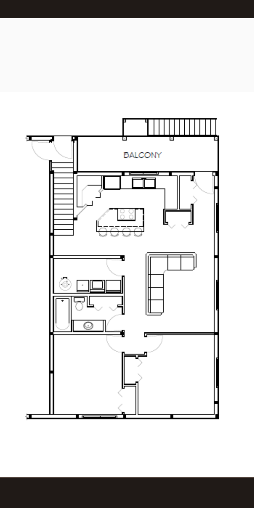

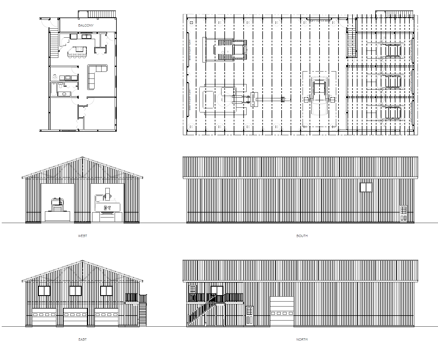

Well, it looks a lot simpler on the outside:

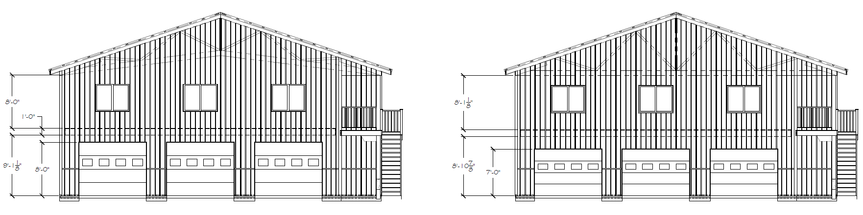

I might reinvestigate scissor trusses to maybe move the 3 car garage ceiling up to get 8ft tall doors. However, I'm already very close to the maximum stair tread rise. I'd have to make other changes to increase the total run of the staircase.

Not that much change required for 8ft doors. Seems like a no-brainer:

Perfect candidate for a cathedral ceiling :)
