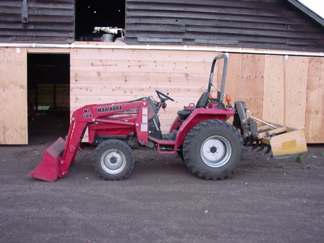

So I got tired of staring at the foundation wondering what I am gonna do so I decided to do a little tractoring /forums/images/graemlins/cool.gif. Here is the before shot.
/ Barn to workshop
#47
This is after about 9 hrs, mostly box blade work with and without the rippers on. I have been needing a place to park everything out of the way so I don't have to keep moving things. Very relaxing, good way to spend some time pondering a problem /forums/images/graemlins/grin.gif.
/ Barn to workshop
