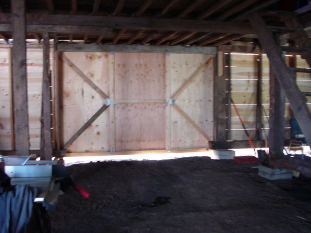

Besides a mess, this picture shows the south bay (with forklift-one of my bargains I couldn't pass up $700) and the sub panel install, I am running 3/4 conduit throughout. You can see the floor is down to soil and fairly level and pier under SE corner post.
I just put the benches up a couple of days ago, I was going crazy with the mess. At least I can walk now...

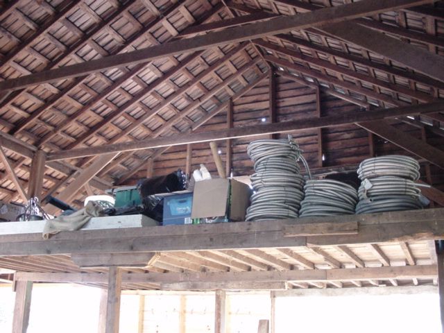

Eddie, Thanks for the support. I'm trying to do the best I can with the available resources, I have boxes of stuff from a home depot type store that went out of business and we purchased a sealed container of it. The 3/4 conduit I have rolls and rolls of, I think you can see it in that overhead shot I posted last night. So go easy on me, I'm a doin my best. Sorry about your electrical problems, I know the feeling when that stuff blindsides you.

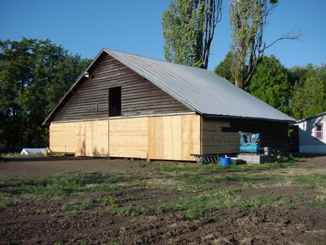

This is an exterior shot of the trees that were encroaching the east wall. The closest had deformed the wall about a 1 1/2 feet inwword, so sometime in the past someone cut the beam to take the pressure off. They did not bother to resupport the vertical studs so there was alot of deformation in the roof line and eves. I trimmed the trees as far up as I could, between 15 and 20 feet using the forklift. I knocked off some major weight 40 plus foot branches, had to tie them off to the truck and make some careful calculations. Had approximately a 35 degree window to drop the limbs without taking out the barn or house. Did it by myself, so to say I was nervous is an understatement. I posted this picture before but it will help to see the before and after. Also if you look in this picture you can see the house in relation to the barn, I went North East with all the tall limbs as that was the only direction with enough space for them to fall. Just for reference North is a few degrees right of the direction this picture was taken.
/ Barn to workshop
#33
Here is the after on the trees. There was not any way for me to bring these trees down by myself, so my goal for the time being was to relieve the pressure on the barn at the roofline (which was pushing the whole roof west) and at the base where the trunk was deforming the base of the East wall for about 24 feet. It is really hard sometimes to get scale in pictures but in this picture if you look in the barn opening you see the back of OJ (that is a Clark 4000 lb warehouse forklift) the tree pretty much dwarfs it.

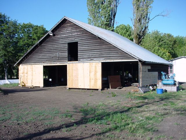

This is the South tree closeup after I back cut it and replaced the base beam. It had moved the base so far inward that I misjudged how far to back cut it. I need to take another 4 or 5 inches. Once I get the structure sound I will take the trees all the way down.
/ Barn to workshop
#35
This is the North tree closeup. I got the correct clearance on this one first time around. I spent a good week getting these trees trimmed down and then cut back. I burned up a buddys logging saw doing the back cuts. /forums/images/graemlins/frown.gif I payed him back by spending a couple days leveling the land around his business, he brought in a JD 750 CAT so I was pretty miserable driving that around for a couple of days /forums/images/graemlins/grin.gif I got some pics but they are film, I will post em when developed.
