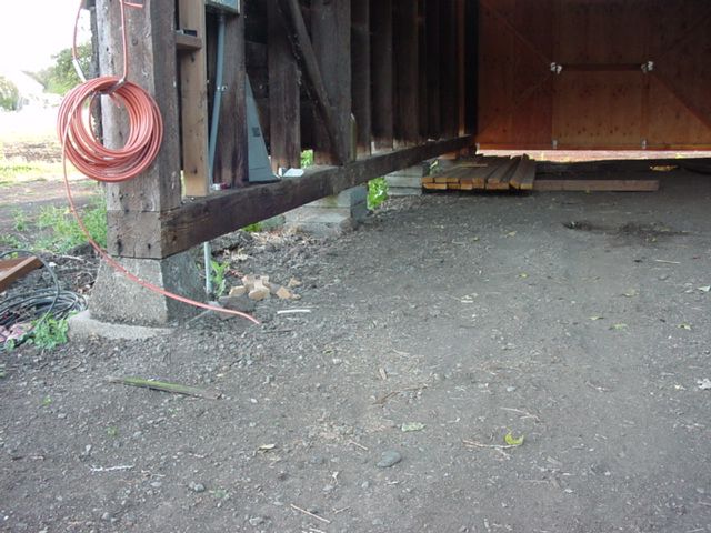

So I position the PHD to get an idea of how much space I will need to dig and how far apart to set the new supports so i can remove the one I am digging under.
/ Barn to workshop
#95
Outside looking in...... That's Penelope checking my positioning from under the beam to the left /forums/images/graemlins/grin.gif Always helps to have 2 sets of eyes on a project...
/ Barn to workshop
#96
Close-up after I have set the new supports and removed the one under which I will dig. The 2 beams don't match up /forums/images/graemlins/shocked.gif imagine 2 6x8 beams that are different dimensions. The rough cut original beam is 5 7/8 x 7 7/8 while the replacement comes in about 5 1/4 x 7 1/4 is that what they call dimensional lumber? Why is it that wood is getting smaller while retaing the same dimension label but the price is going up? /forums/images/graemlins/smirk.gif
