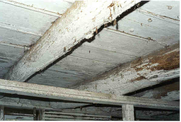

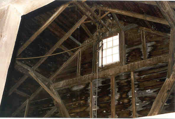

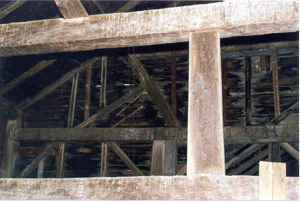

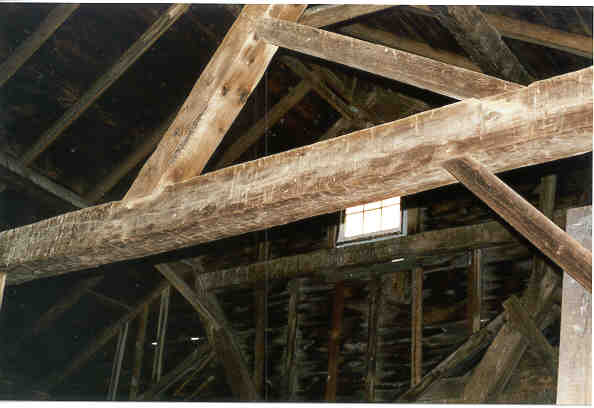

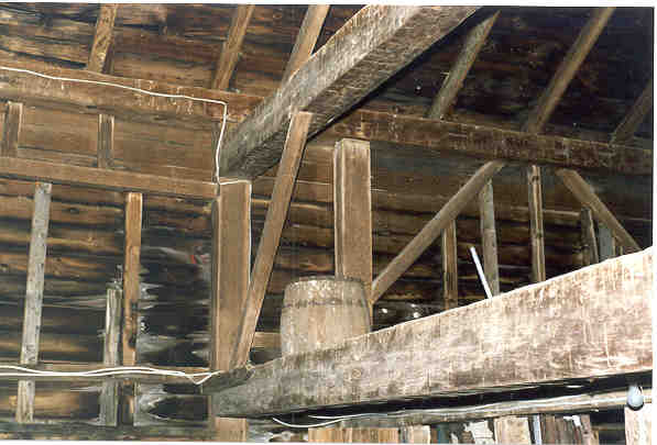

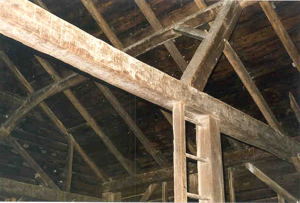

Nice job! From what I could see of your beams it looks like a canted queenpost frame. Do you have any good dates for the original erection of the frame? Also, have you seen any "marriage marks" near the joinery where 2 pieces come together? I just returned from 2 weeks on the road - the first week being a member of the repair and raising crew of <A target="_blank" HREF=http://www.tfguild.org/rendezvous/cuvilly702.html>this barn in Ipswich, Ma.</A> I have a 40x80 barn built in 1852 that I am working on as time permits and I may end up taking it down in order to fully repair it. I'd be interested in hearing about what repairs you made to the post feet and sills in your barn.
/ Barn Renovation Project
#47
Hi Andy....
These were great pics of the barn raising in Ipswich, Mass. My wife was born in Ipswich and she was most intrigued when I showed her these pics.
To answer your first two queries...no and no. I'm not saying they're not there. I just haven't found them. It's just been very difficult finding dates as most of the framework has been white washed on the ground level. This, plus accumulated decades of cobwebs and dirt hide an aweful lot. That's why I've had such a difficult time dating this building. Where did builders typically put these marks?
Apart from the front end of the barn that was razed because it was too far gone, the rear of the barn was where I had much of the water and dry rot damage. About half of the post feet were repaired or entire posts replaced. Barn was jacked up and new posts were installed or post feet spliced in where appropriate. Sill plates were also replaced with pressure treated 2"x8" or 8"x8". I would have preferred to go with something more original that matched the original framework of the barn but the fellow doing this work recommended the pressure treated due to rain and moisture problems that were impacting the sills. I was fortunate in that my foundation was still in relatively good shape.
What can you tell me about a 'canted queenpost frame'? I'm not that well read up on the different building techniques from the 1800s. Is this a typical or atypical frame builders used during this time?
Bob

Re: Canted Queenpost timber frame. From what I could see in your picutres, you have common rafters supported by a canted purlin plate (that being the long plate, holding up the rafters mid-span,held by short angled beams. Take a look at <A target="_blank" HREF=http://www.tfguild.org/workshops/gouldfarm/barnjuly29e.html>pictures of the Gould Farm barn raising</A> to see one of those plates being placed and how it sits in a completed frame. To the best of my (still learning) knowledge, this type of construction was not uncommon. Hope this helps.
#52
Thanks Andy for the pics. I'd say you're right. My barn's framework is just like this new one being erected. Thanks for improving my knowledge base a bit more on what I have.
