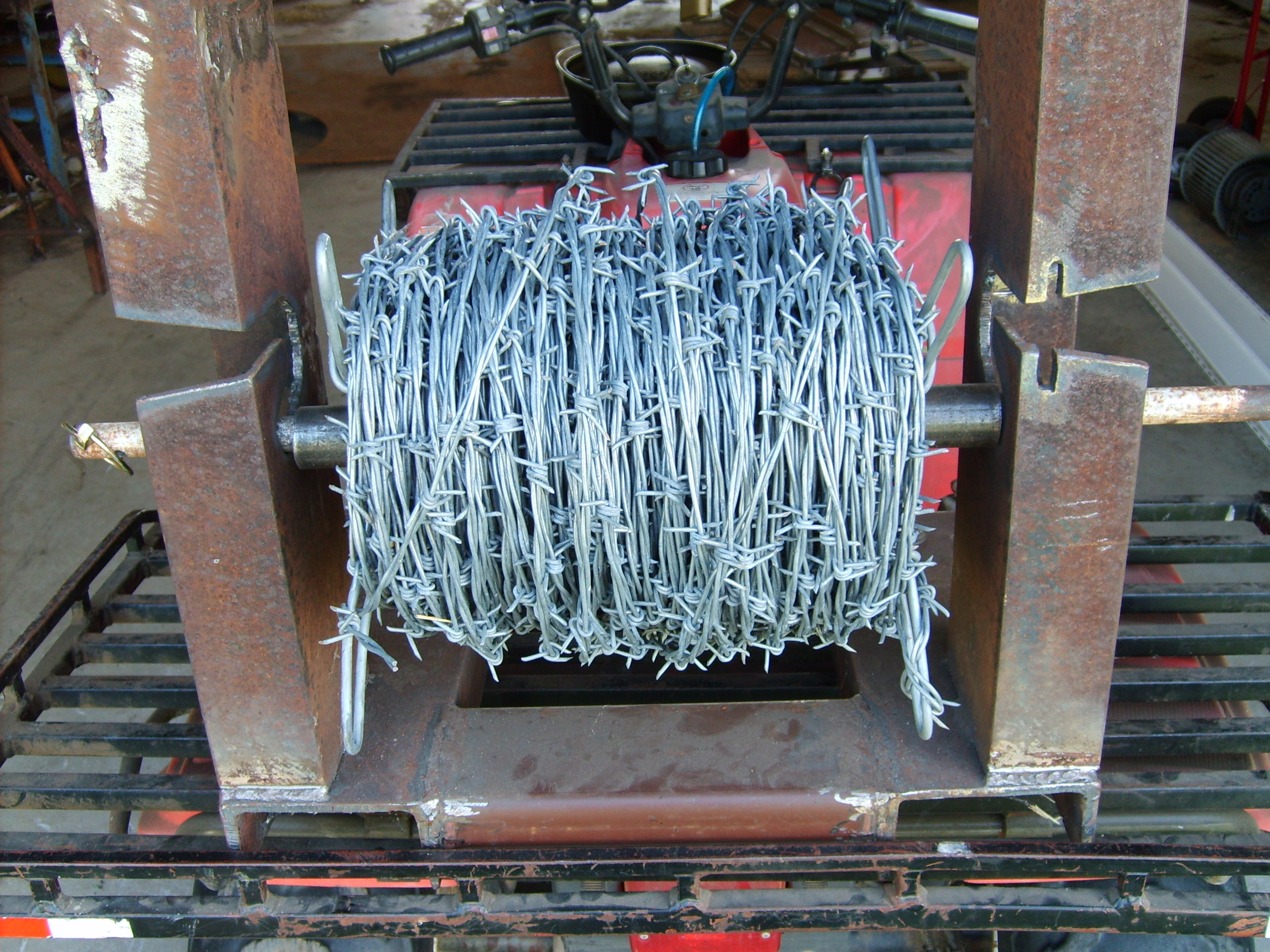

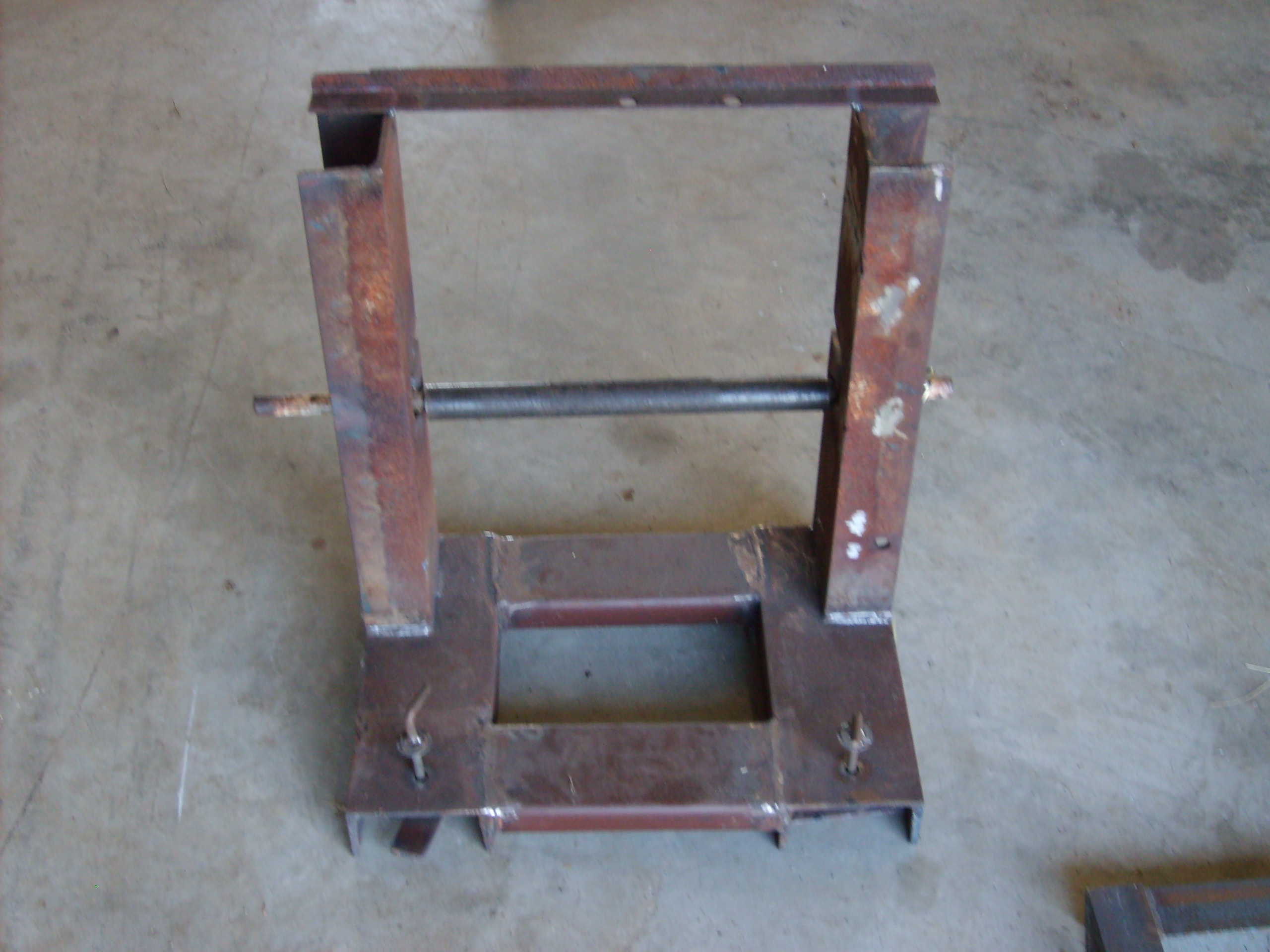

/ Barb Wire Unroller #9
I built one for my 4 wheeler but something like it could be fashioned for 3 pt. Only 1 roll at a time though
