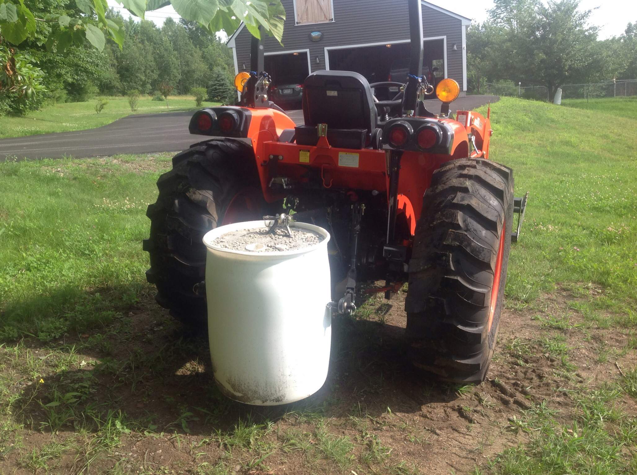

Nice move tho. Do you think 1000# is enough? Is it enough to max out the loader lift. 1600# shouldnt be close to the max you can lift? 1000# was sufficient for that, but what if you lift 2500# +/-? I would think 1000# wouldnt be enough.
I know your tractor weighs alot more than mine and has larger tires for fluid. But my 1000# ballast barrel is none too heavy when lifting to the max on my machine.
time will tell. When lifting the generator i had no lift in rear end at all. Ill have to wait and see if i ever get anything heavier yo lift.

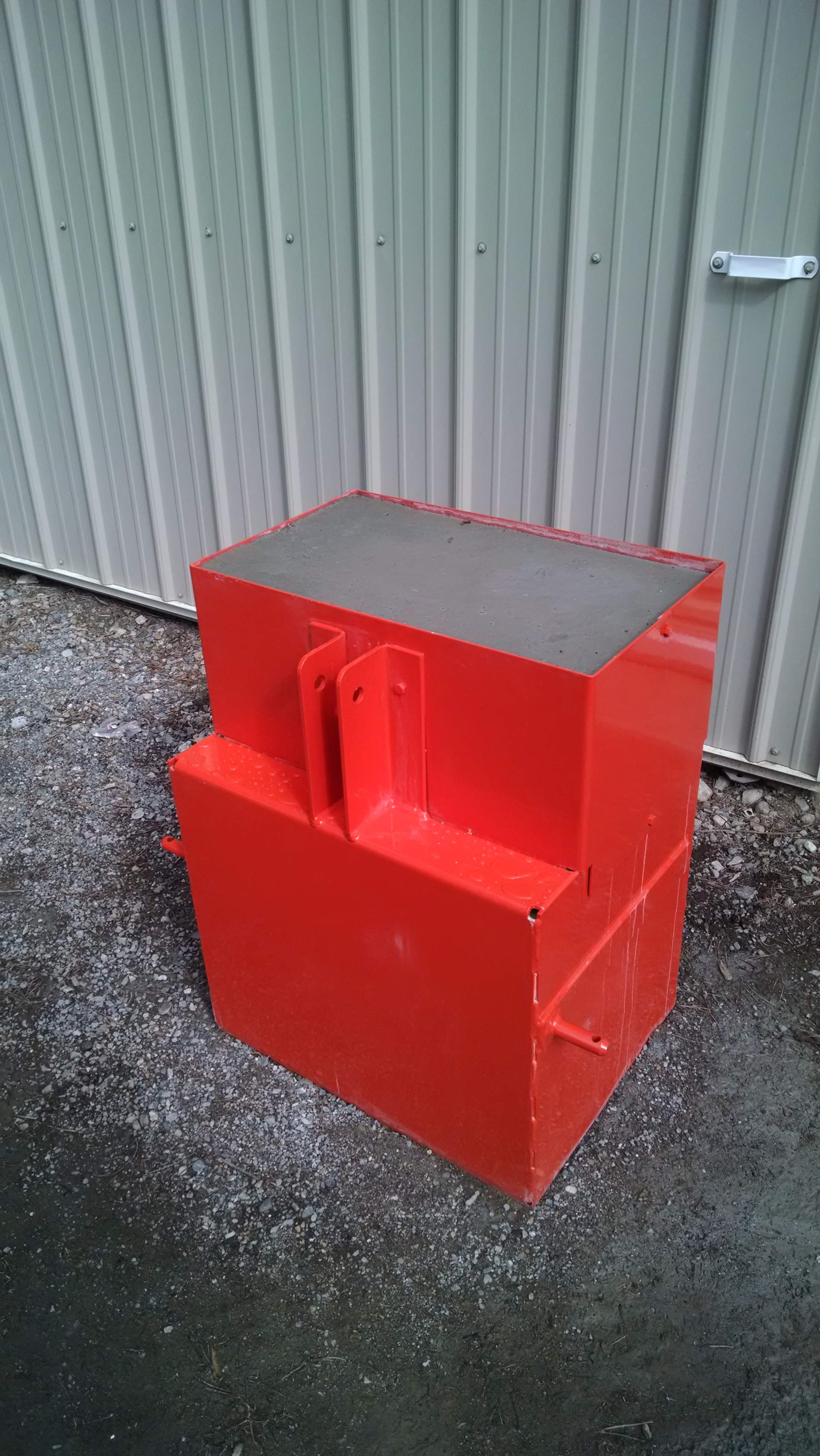

This is the BB I made for my tractor. It's filled with cement and some steel pates and reinforcement. It has a tow point imbedded so I can tow my trailers/log splitter and it weighs 650 lbs w/out including the chains or tools carried in it. I have room to add more sand/gravel/cement or carry tools. In winter I had a 5 gal pail of sand/salt mix.
I only paid for the cement mix and the pipe used as the lift pins.

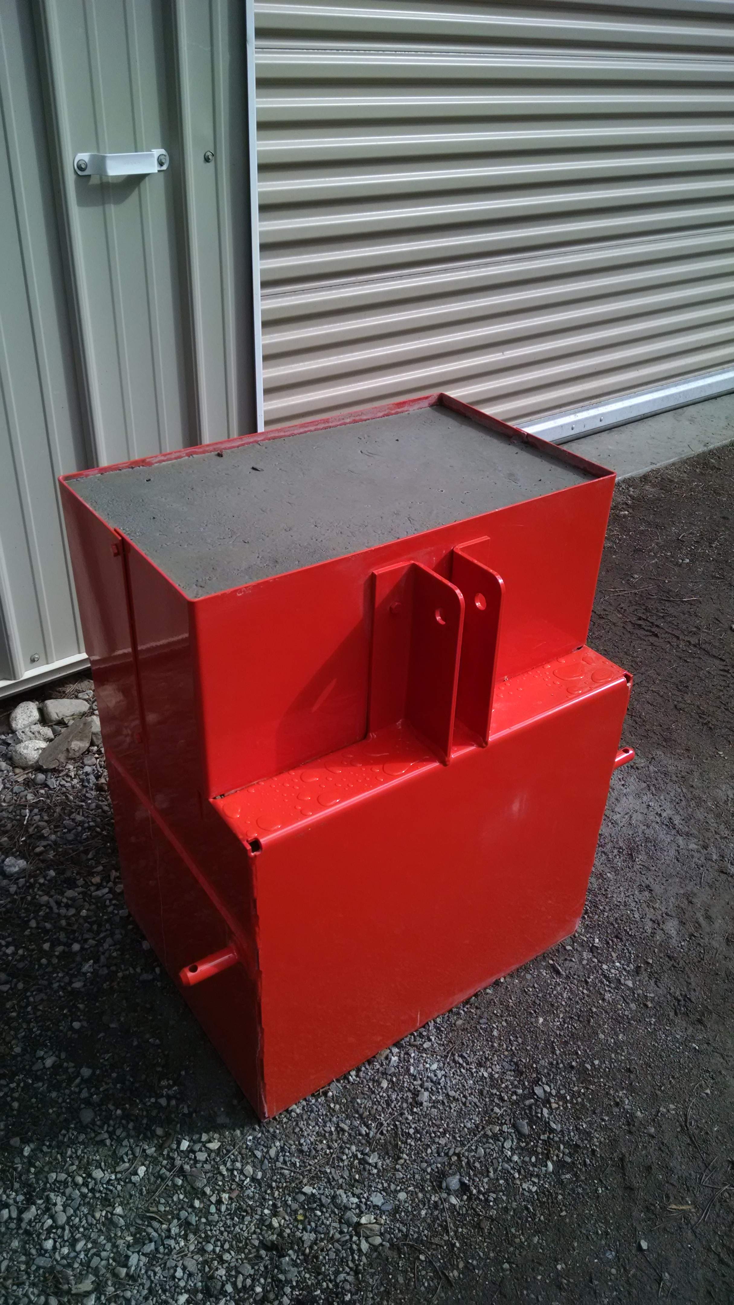

Well that would explain why i couldn't find it. I thought for sure i was just missing it. And I'm honestly not sure how heavy the thing is. But when i lift the 3pt i can see and feel the weight come off the front end. I'm sure I'm losing traction ability with the front but man alive is it ever more stable with a load in the bucket now. I'm going to try to get it over to the local ag scales at the elevator and get a solid number on it.
The base is made out of I beam, and the sides out of what was left of a car dolly after i made my cultipacker. Then i put 8 brake rotors in it and filled with ready mix. Four 60lb bags and one 80lb bag. (it's what i had lying around.)
It needs another coat of paint but i had stuff to do.

That is heavy duty. And the fact that it extends past the lift arms probably make it more effective. Mine is centered on the lift arms for compactness. I weighed each rock and steel plate as I added it and it comes up to 635 IIRC. With the chains and tools I figure 650. The bucket can't lift the rear wheels off the ground so I figure it's enough.
Which also makes me wonder if my hydraulic valve relief is set correctly. But I have no way to check. I assume it's set at the factory. If it's set by the assembling dealer than it needs checking. Cuz the set-up dealer sucked.

My original plan was to have it more centered on the lift arms and more compact but i wasn't thinking right when i made the spot for the top link connection and put it right out at the edge so i had to make the lower link spots out the front too. I'll admit though, having the slide through pin set up like i do for the lower links makes hooking up to it a breeze.
And again, had i been thinking i would've weighed it all as i put it together like you did too so i would know. I just got too wrapped up in getting to the finished product i didn't even think about doing that.
