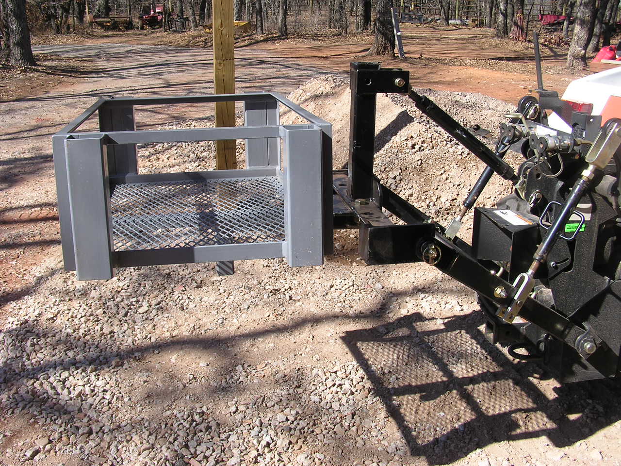

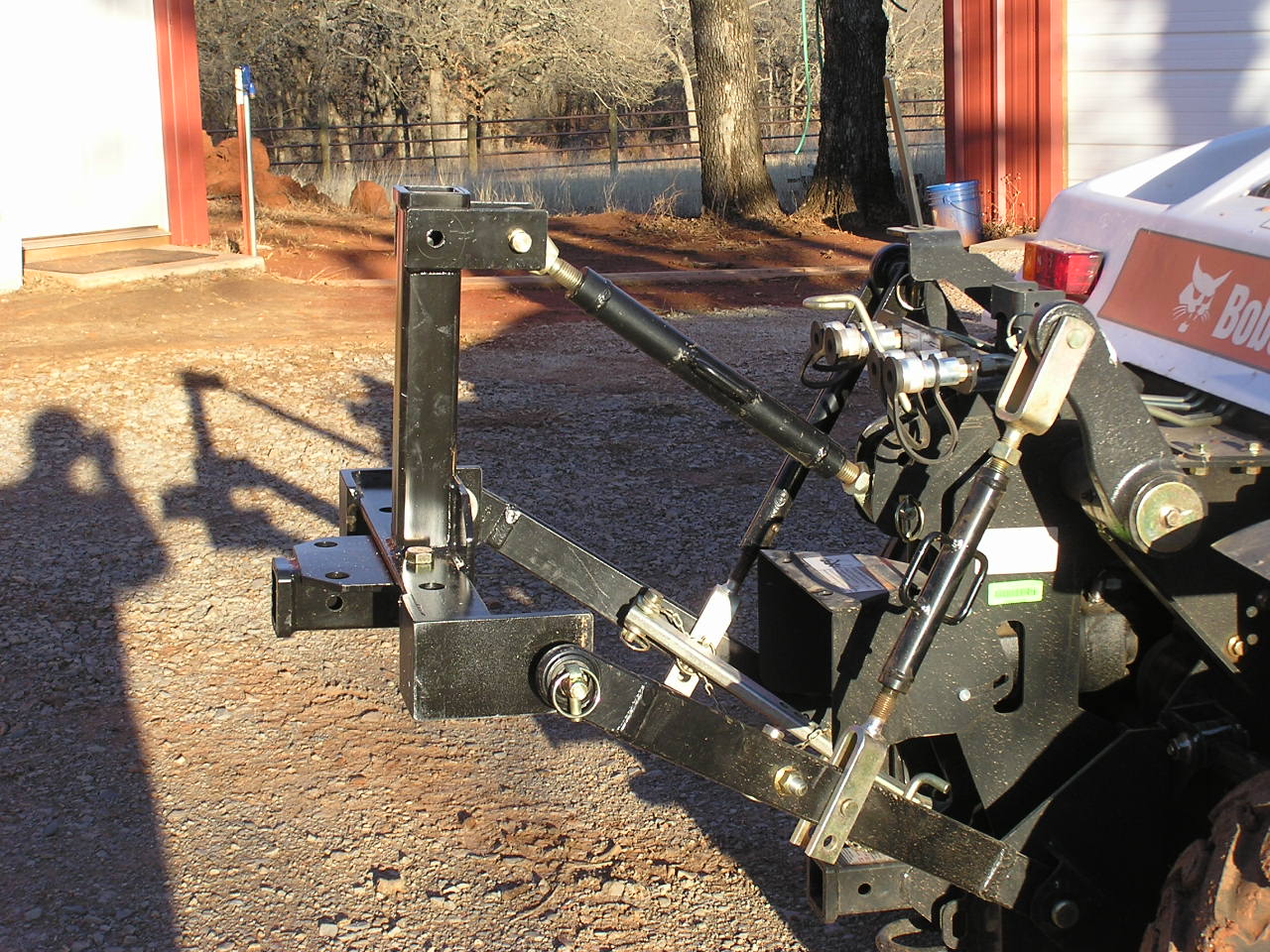

Like this?
OMNI Counter Weight Rack - OMNI Mfg LLC

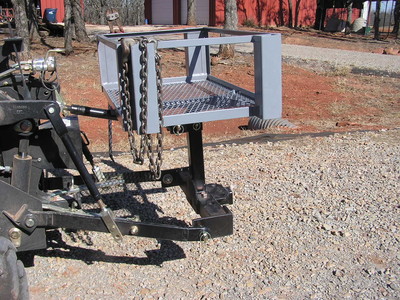

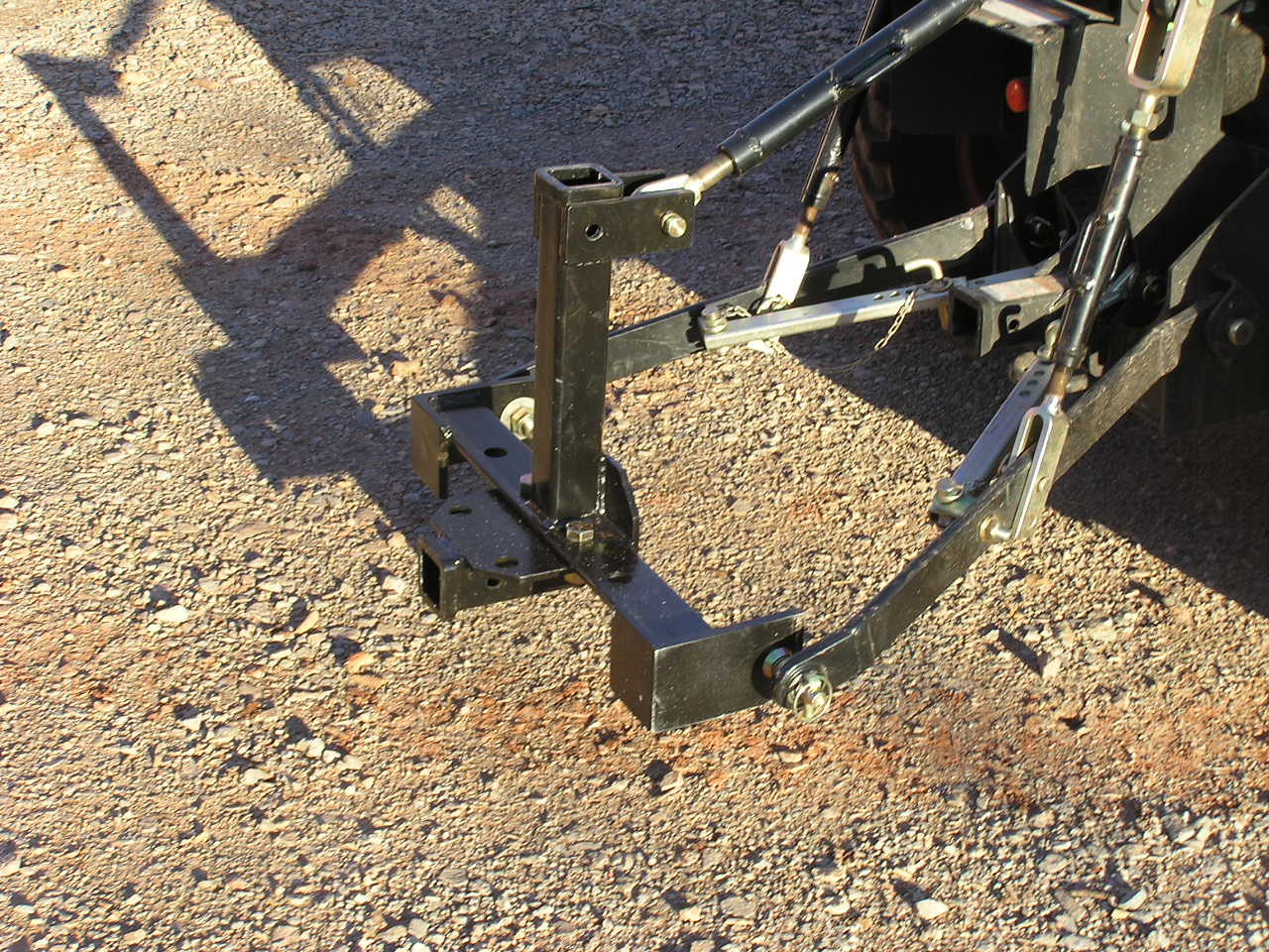

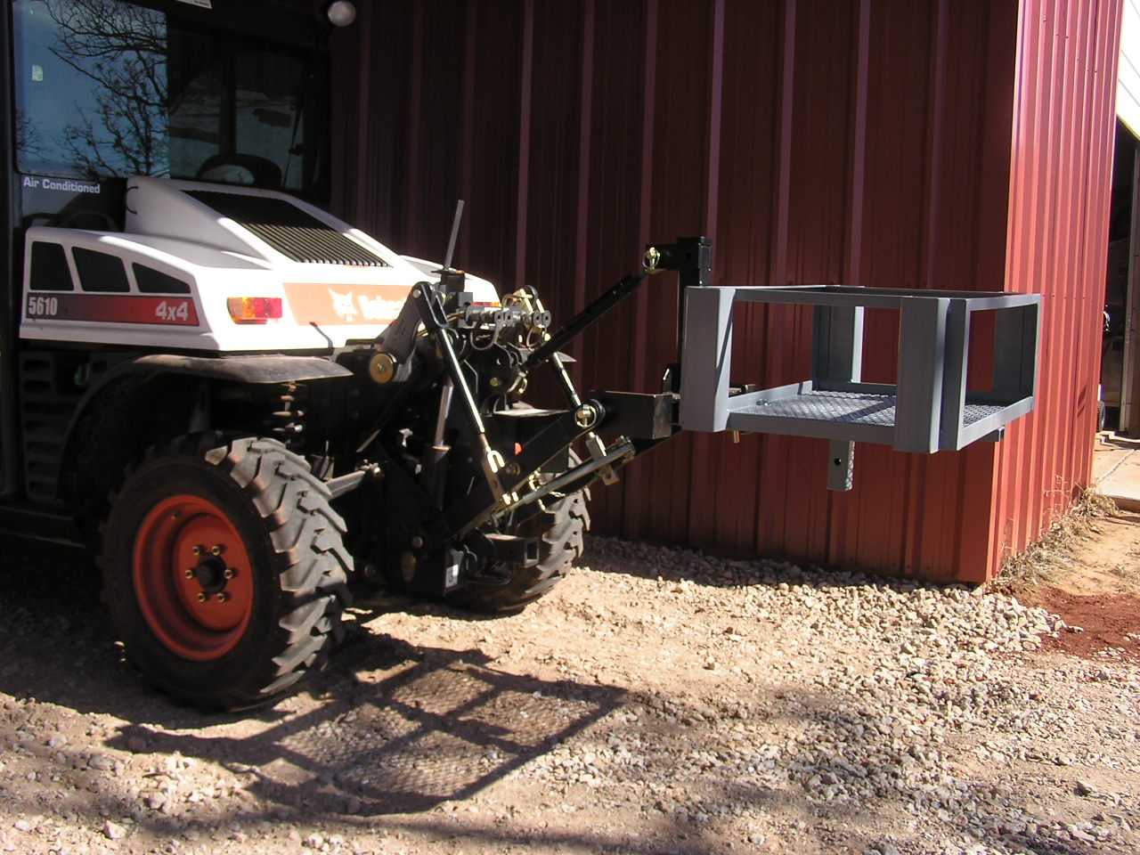

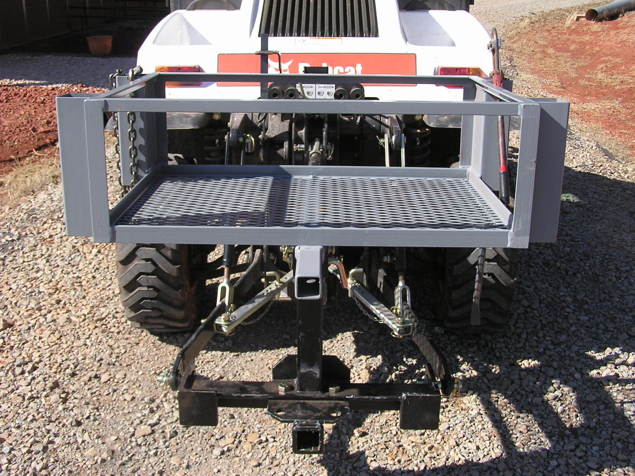

Xfaxman - Exactly like that.
The neat thing about it is, when you don't need the weights, you can put something else in the top receiver.
I have both of these, but haven't taken any pictures of mine.
Here are their pictures of the bale spear they made for me.
TX Bale Spear 001 (Large).jpg TX Bale Spear 002 (Large).jpg TX Bale Spear 003 (Large).jpg
