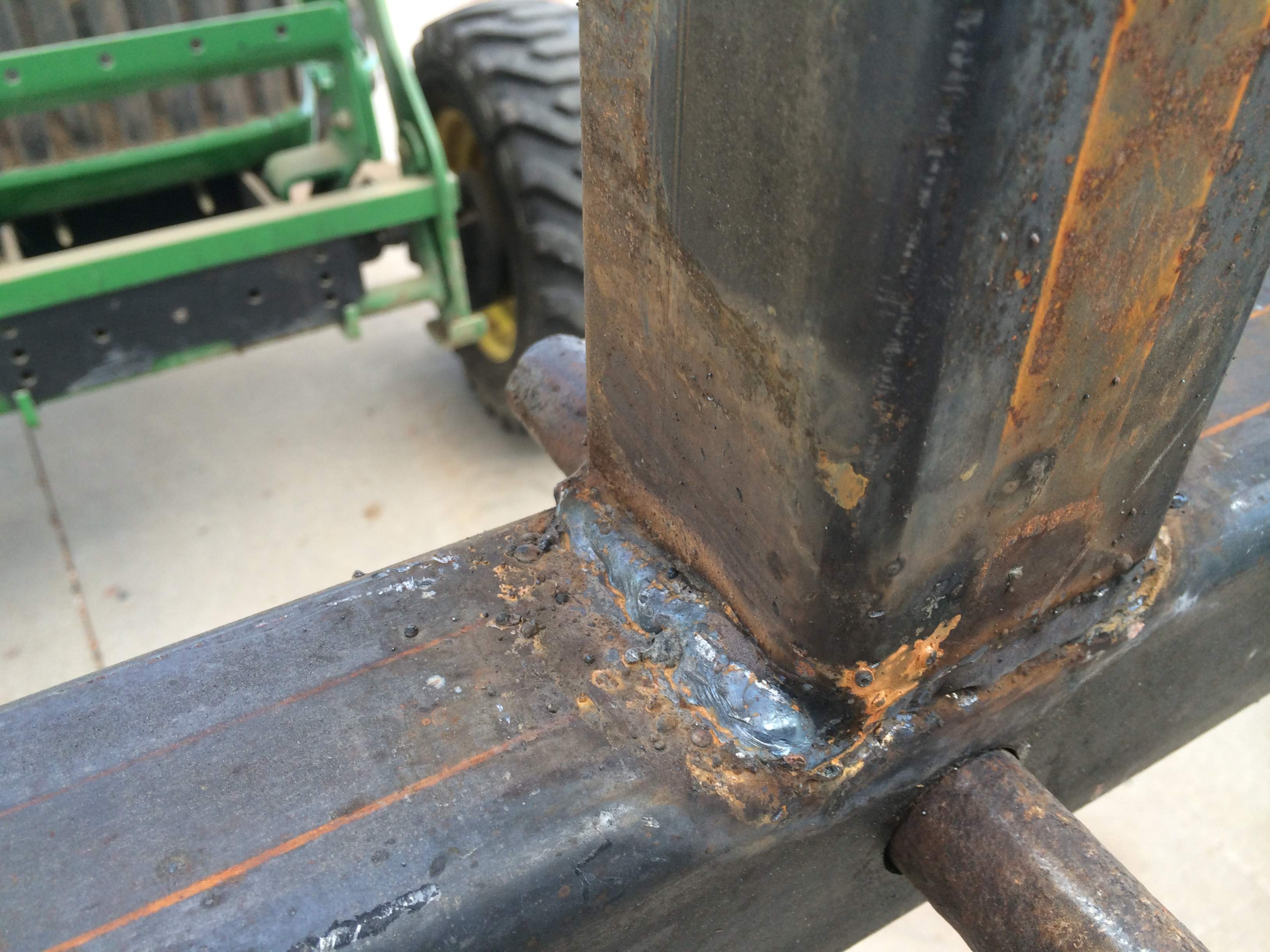

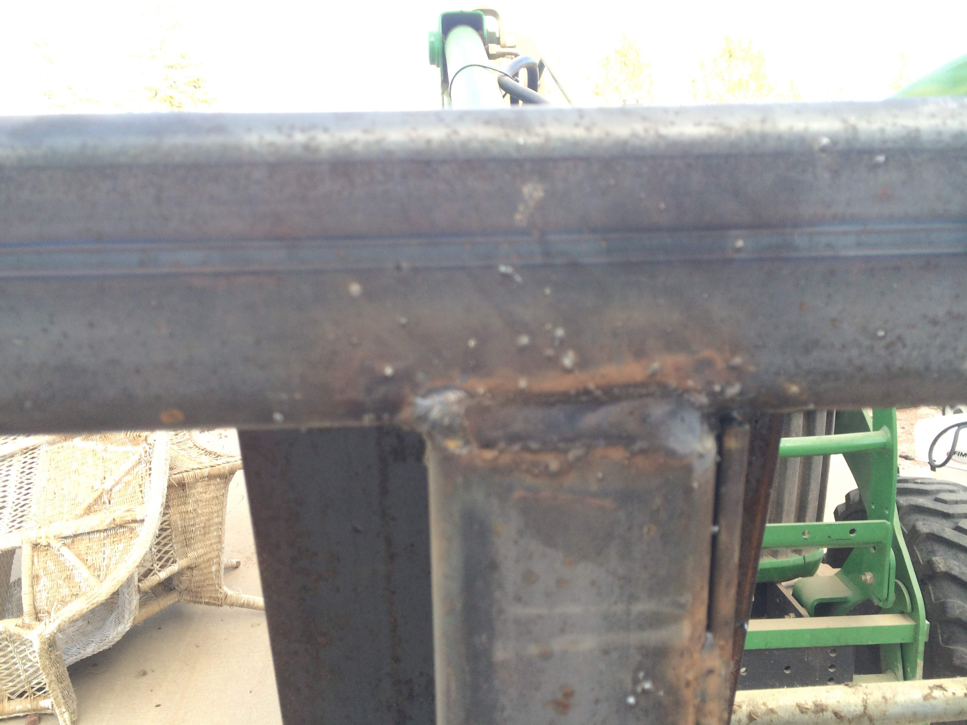

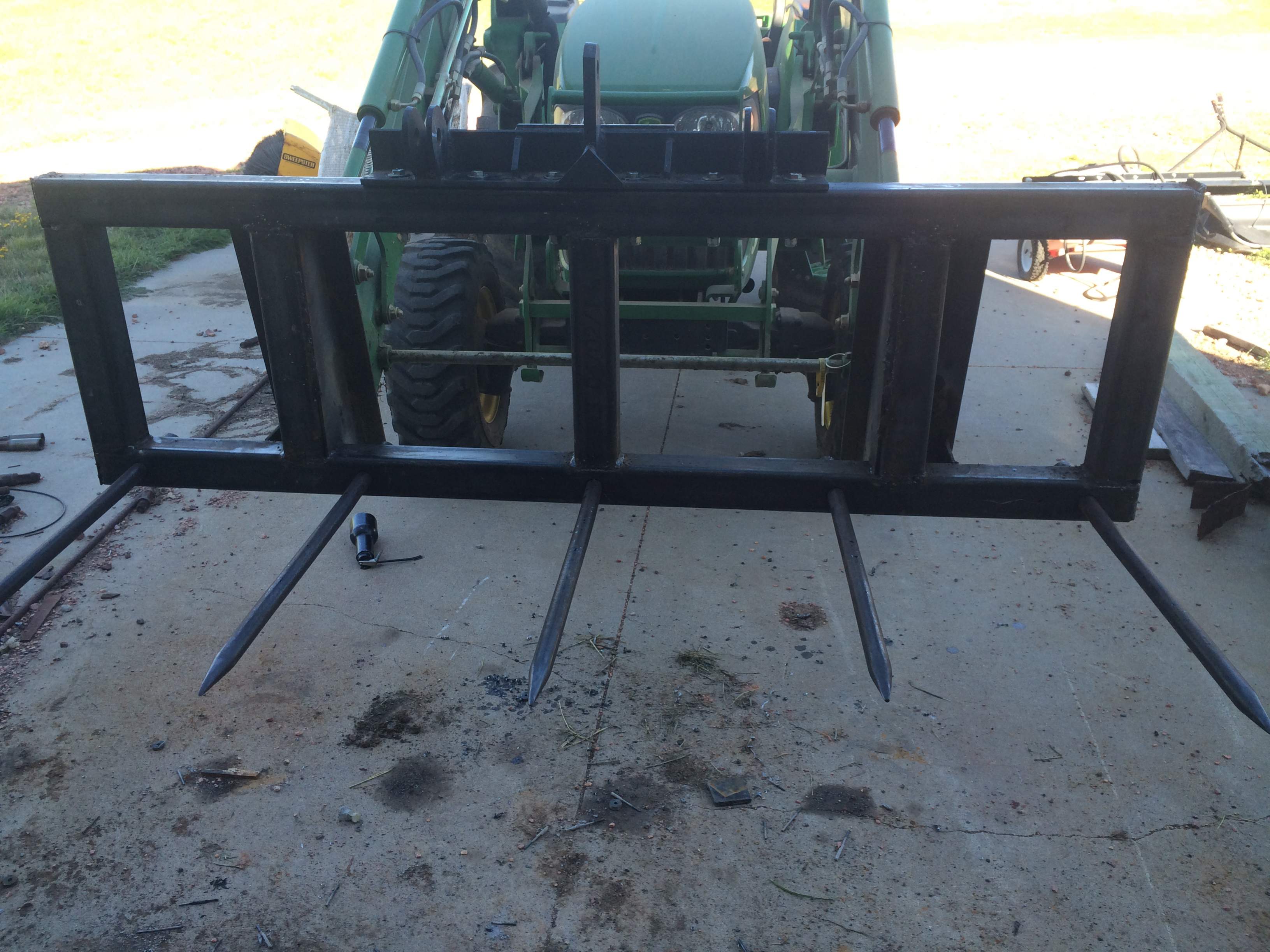

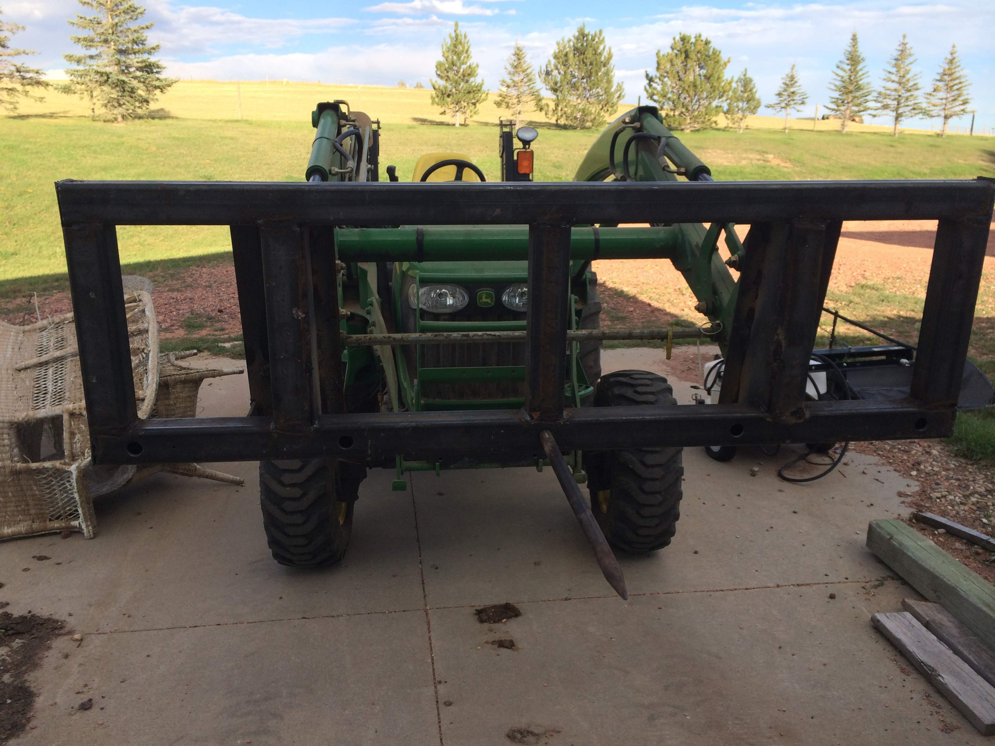

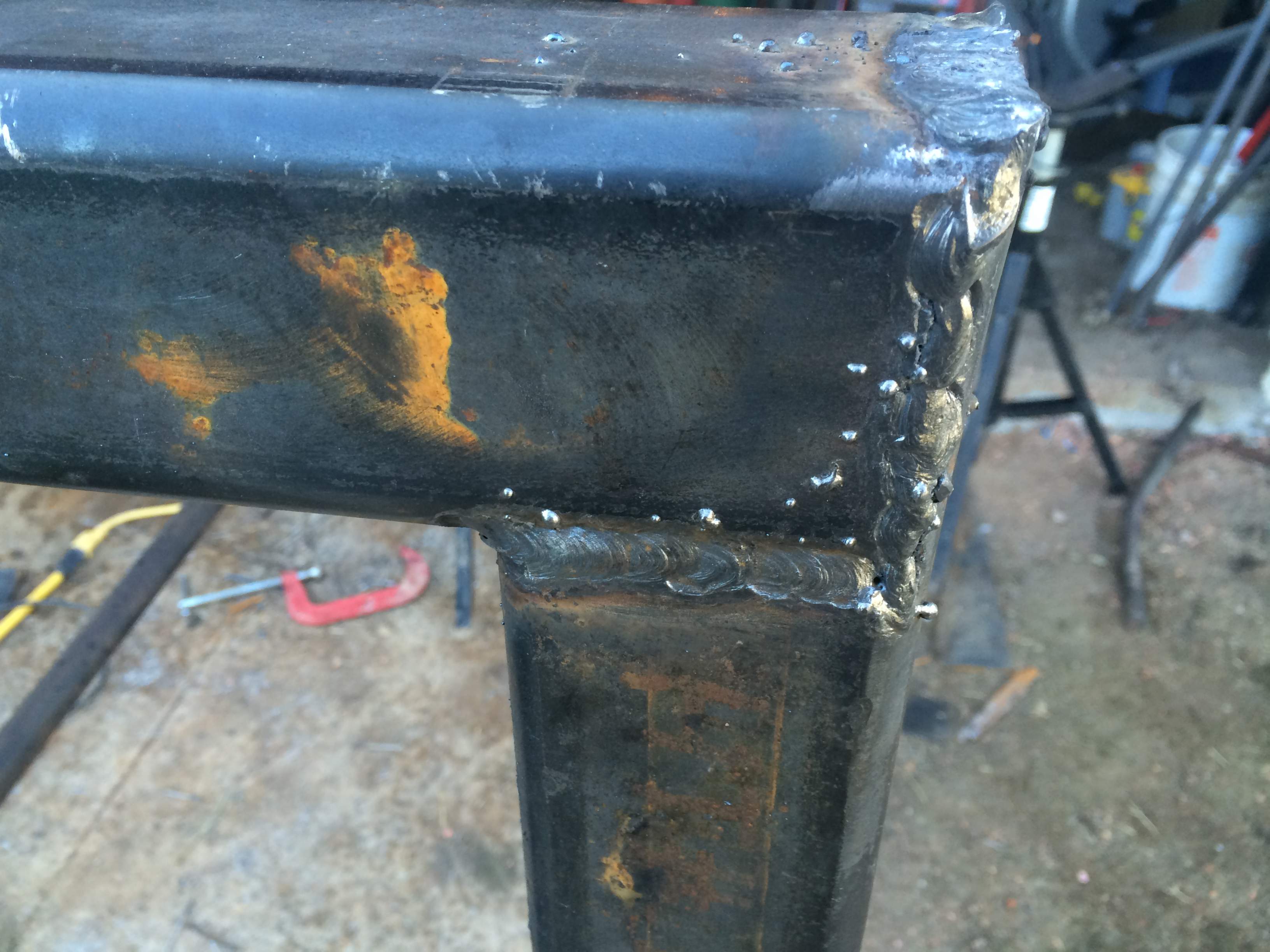

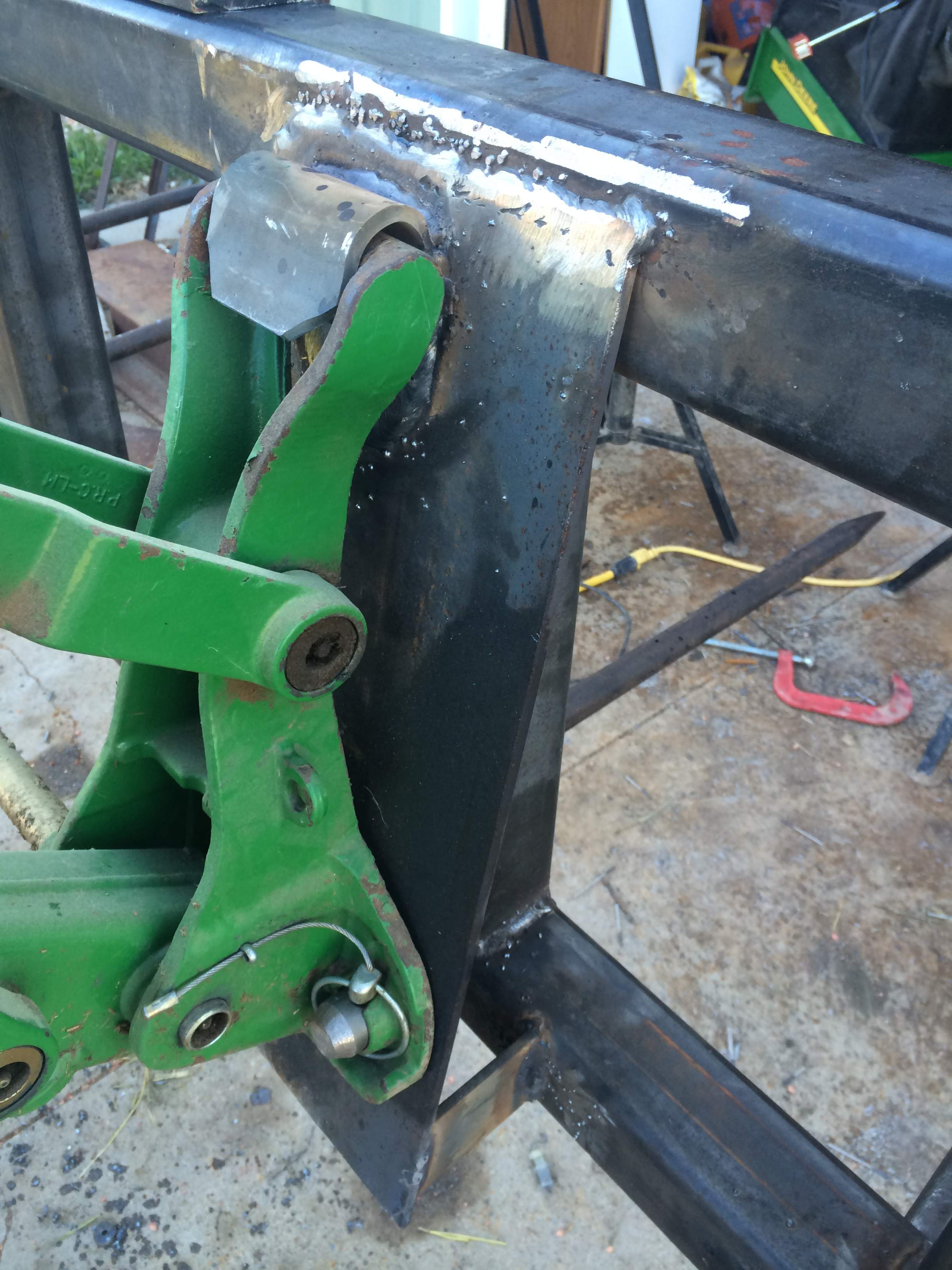

I just thought I would share a recent project of mine. I haven't posted pictures of my projects before and I am open to anyone looking at the welds and offering suggestions. I built this to lift 1200# 3X4X8 bales of hay. My previous spear only had 2 tines about 40 inches apart and it was difficult to lift the bales because they would sag. So here is the 6' 5 tine improved model.

Looks pretty darn good to me. :thumbsup: Are you gonna sleeve those spears so you can replace them easily? I wish I could weld so I could build one.

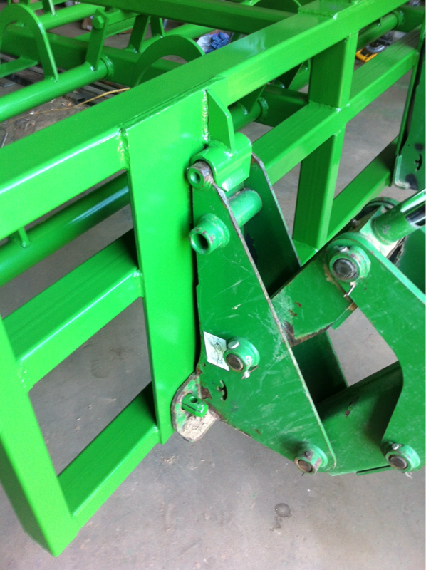

Nice build ... May want a gusset on top of the JD hook I've seen them roll up. I think u could have keep the plate flat against the frame ... Either way a job well done !!!

mjw357 yes the tines are sleeved, I took the picture of the attachment from the rear before I put the sleeves on.
blueriver yes I am going to gusset the top hooks, my snow blade has them reinforced so I will copy that. As far as the angle goes, I just copied my existing smaller bale spear and that is how it is. It allows the tines to go past parallel and tip down.

Looks like most farmer welding projects. Not real pretty but holds up just fine.

Most of my stuff isn't much for looks I am happy as long as it holds together and does what I need from it. I do have a rattle can of JD Green for it after a little grinding and touch up i spots. I was in a hurry because I should have a load of hay any day now.

UPDATE:
Just finished unloading 39 #1100 bales with no issues. No evidence of weld pulling or any other problems. On a side note if anyone has experience with Fasse valves I am in need of help with mine. It seems to be bypassing under pressure. With the button pushed it activates but at a certain point instead of the grapple gripping the curl function activates.
