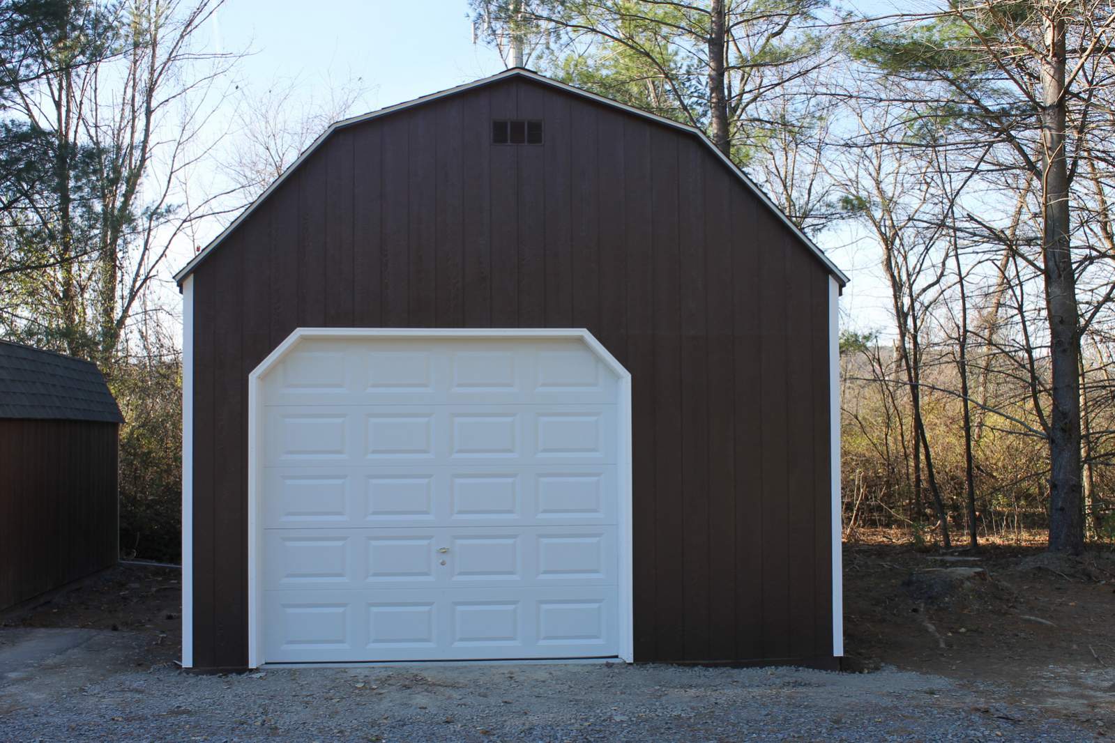

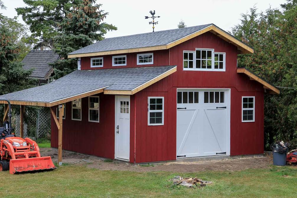

The paint is Ben Moore Ext Latex. I have the color written down somewhere - i'll have to dig it up. It had two coats applied when we built it in 2009. Six years later it''s still pretty good, there are some spots along the first floor where the dogs/humans/stuff have rubbed up against it and its beginning to look a little thin. Also, we have a lot of woodpeckers and they want the bugs hiding in the recesses of the T-1-11 siding, so every year I have to touch those up. I will use the same paint again the next time we paint, either next year or the year after. I'll see what it looks like in the spring.

Your building is a work of art and craftsmanship. I noticed the 2x10 headers over the window on the non-loading gable wall. That is over-kill and the way things should be built! I have a question, Is the stone work on the foundation and apron, stamped concrete or veneer?

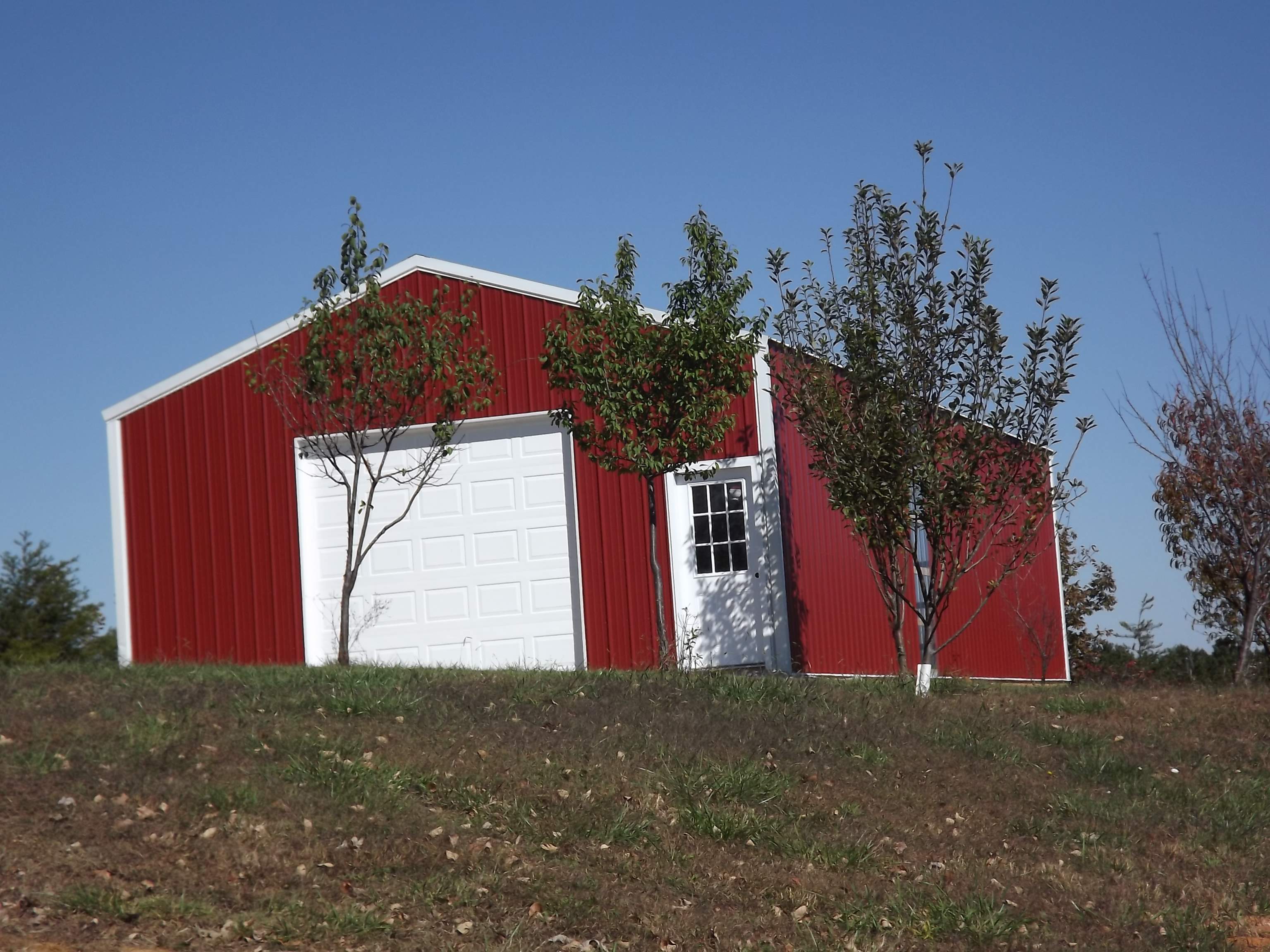

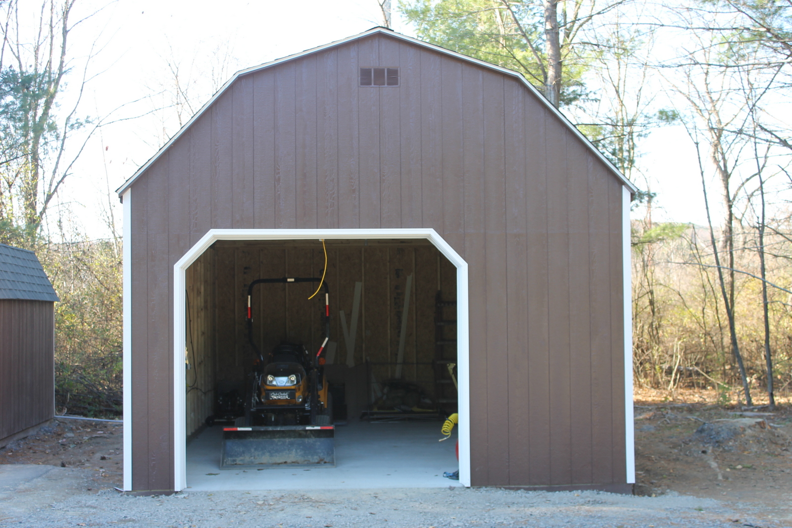

I had a 24' x 48' metal building built for me last month which uses the pole barn method of posts dug in the ground with framing and then metal added. Wife, me and neighbors think it looks good. Gravel floor and can add wood, concrete or combination of both later and probably will.
/ Backyard Shed for BX Tractor #64
Nice neat building. Mind sharing what it cost? Any photos of the construction process?
The patio/apron surface is PA bluestone puzzled on (tiled) over flatwork. Prep the area normally (flat, vibrator-compacted, 3/4" clean base). Pour the slab but leave it rough, and don't forget to account for the thickness of the bluestone -- which can vary from piece to piece. By rough, I mean just screed the surface to reasonably level, rake the mud a bit, and let it set without troweling/floating it. Take care with the prep and slab layout to provide a bit of pitch away from the structure, just as you would do with any garage work.
Once the slab cures for a day you can begin to set the stone on it. I don't want to tell you this is the easy part -- it's not. Puzzling the pieces together and then mortaring them in place is time-consuming, heavy work. Some of those 1.5" thick pieces of flagstone can weigh 75 pounds. Lay out the stones and then mix and match in an effort to both minimize and make uniform the grout joints (gaps between the stones). Then mortar the stones in place, using a screed or similar board to set the height against a reference string. You will need to make some effort to prevent any sort of "lippage", where one stone is significantly higher (proud) compared to an adjacent stone -- you really want to avoid this as it is a tripping hazard. Once the mortar sets you can go back around and grout the joints. I would suggest adding a hint of tint to the grout, as it prevents the result from looking like a DOT project and makes for a better blend with the surrounding stone. For a large area you may need to make a relief cut or two (using a diamond blade masonry saw) once everything is set. Backfill the relief with Sikaflex or equivalent.

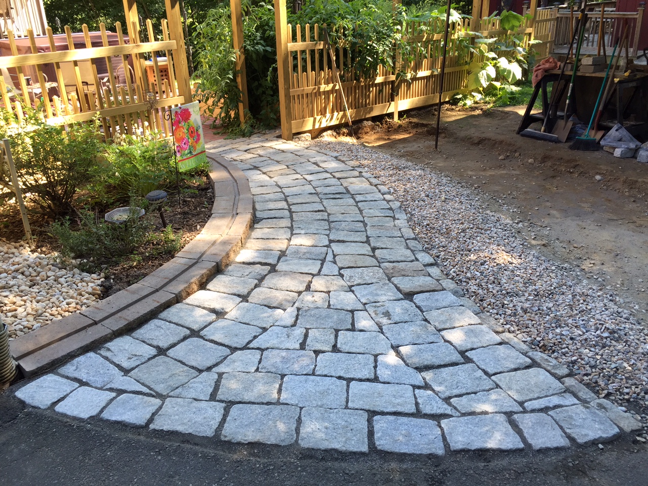

Comparison with driveway apron (note width of joints). That is 3 full days of cutting work!
Not sure you were asking about my building but if you were I had it built by some Mennonites. There were 3 to five that showed up for two very short days and one long day. I provided the 36" front door and they provided all other materials. $8300 with a 9' high roll up door instead of 7' and 10' ceilings and a bit extra for the best primed painted metal with the extended warranty. They showed up first evening with mini walk behind skid steer and within 30 minutes had the 17 PT 4"x4"s holes dug and standing in the holes. The next day they had the lower /strappingframing, trusses, roof strapping, roof metal and some lower metal installed. Third day they finished the project in a few hours and the the garage door two guys showed up and installed the garage door. I usually build everything myself but age, weight and shoulder keeps me on the sidelines now. I built my original 12'x20' two story tractor building 12 years ago when I bought my first tractor, a BX2200 and learned about changing the door height. :D My wife now gets my old tractor building because this one can hold all my Kubotas plus generator and compressor and much more "stuff".

No, I am an engineer with OCD! :laughing:
The work you see above is about 25% my labor and 50% my vision; the remaining part is the output of an old Irish mason (he's about 70) and two young guys who do the digging, lifting, cutting, and placing.

Wrooster, Nice work - everything looks great, first class all the way. I did a fair share of stonecutting this past summer so I know what it takes to do what you did. One project involved re-purposing a few hundred Belgian block edgers into a walkway from the drive to the patio.
There are twenty 80 lb retaining wall blocks buried under the 3/4" stone on the right side to keep the cobblestones in place. The cobblestones are 4" thick - too thick and hard for my 10" diamond saw, I wound up scoring them an inch deep, then used splitting chisels to cleave them through. I then hammered the sharp edges to make them look worn. I used a flexible sealer grout made for wider gaps between the stones.
