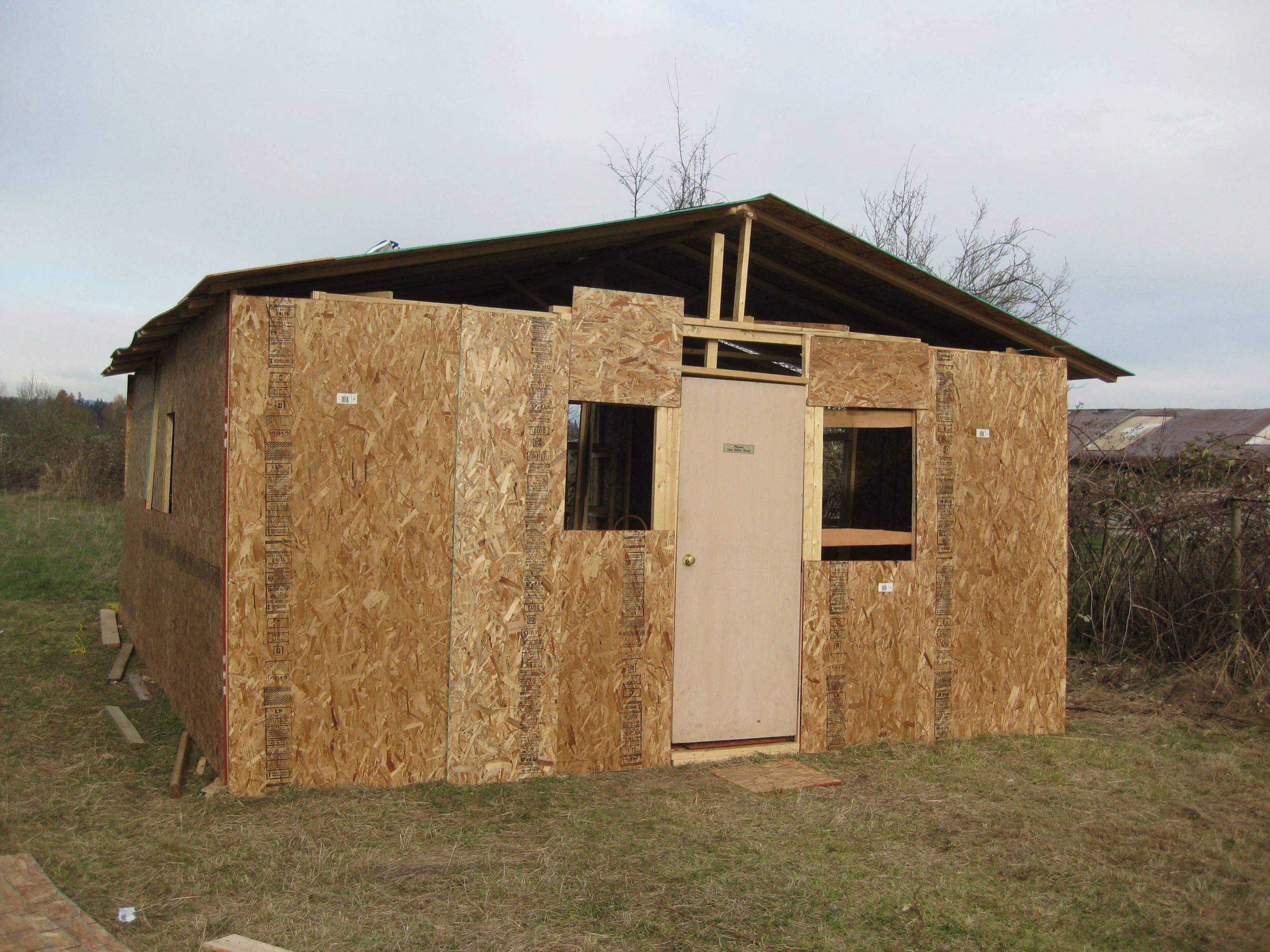

Will this work, a little extra room for upsizing. :confused3:

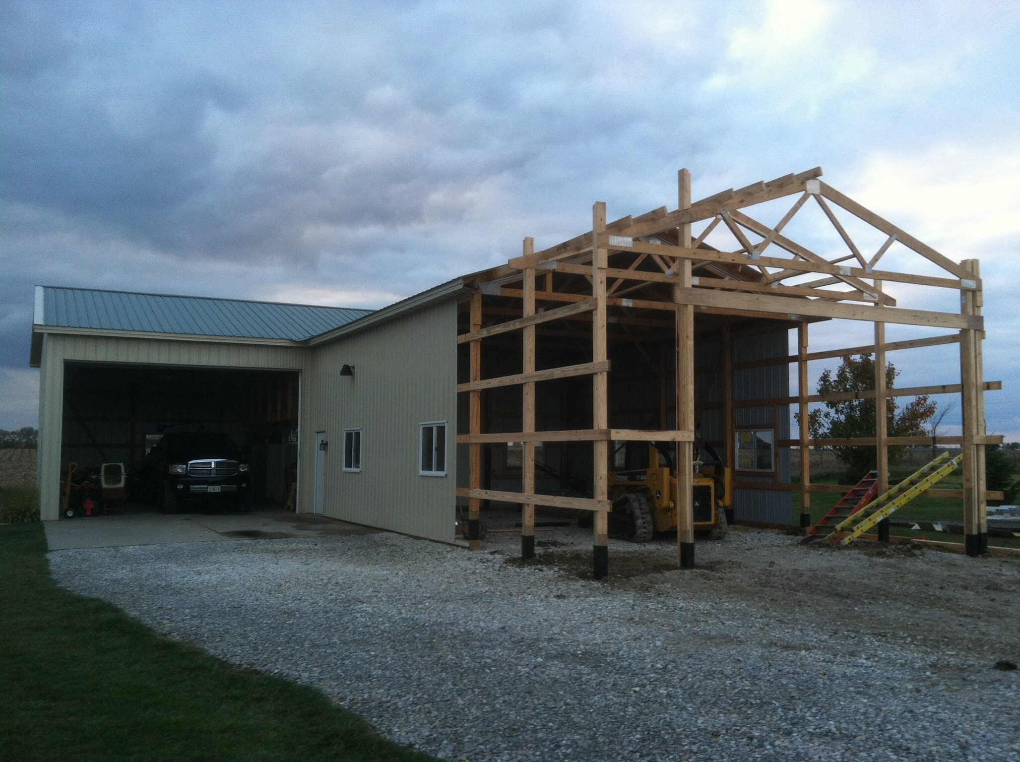

How about this design??? It looks cheap and very solid. Whoever built it should be designing skyscrapers in NYC.

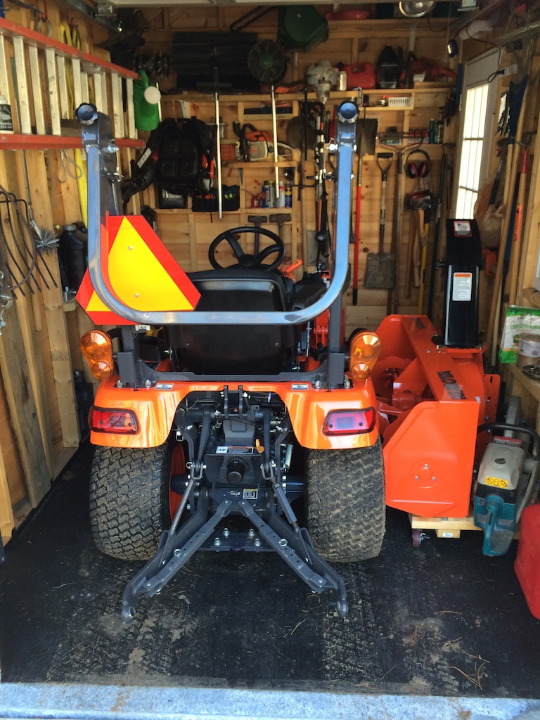

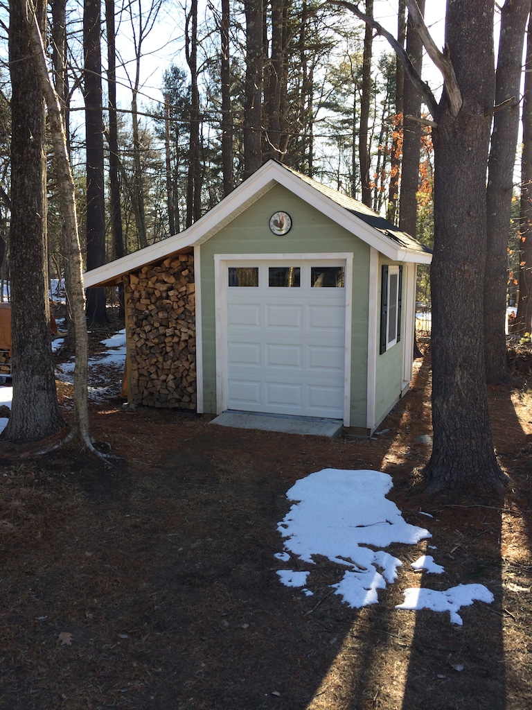

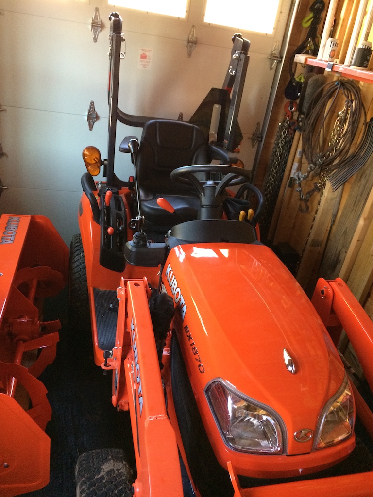

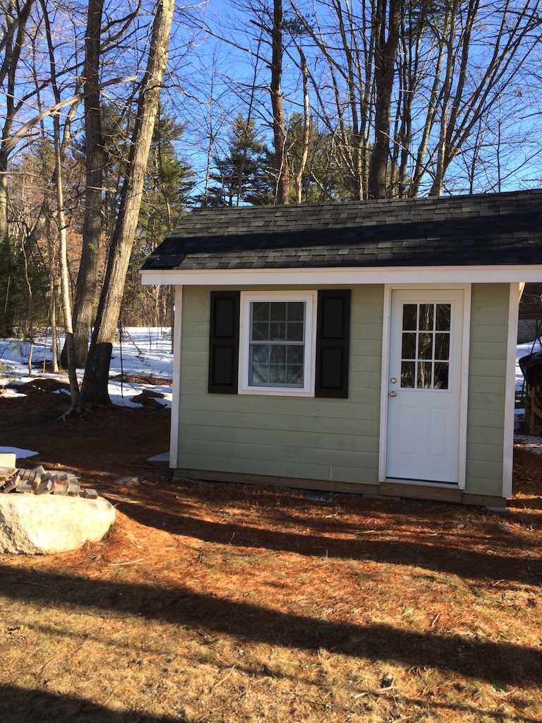

Local building codes played into the size and location of my shed, I would have liked to go bigger but then the setbacks would have increased and the placement of the shed would be closer to the house. I went with a small shed, it is 12x8 and I have a 4' lean-to off the back for firewood. The wall's are ~7'6" high and roof is 8/12 pitch. I have a 6' wide by 7' tall overhead door on the end. I have the bx1870-1 which has the newer style fold-able ROPS, I have it folded down but have been seriously debating on getting the 1860 ROPS from whole goods which is rigid and will fit. The tractor, 3PT, and FEL with the quick attach just fit, I have maybe 2" of wiggle room but it fits. I also have 2x8 PT joists 16" o.c. with 3/4" PT plywood for decking, I used construction adhesive when I put it down, no problems so far. I put that herculiner down on the floor a year after I built it and it is holding up great so far.
So, I guess consider the cost of switching out the ROPS to building the shed taller with an 8' door and also consider what else you want to fit in there. a 10x14 would be the minimum I would build it to be able to hang up the MMM or store the snow blower on the side. I would go as big as you can and be done with it.

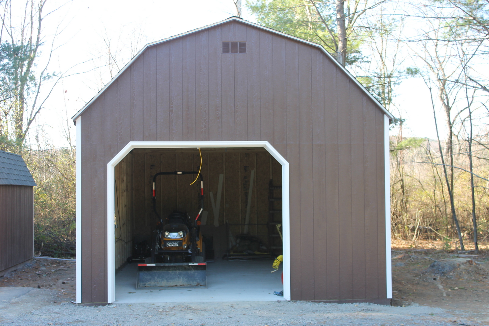

When I added on a garage for my BX tractor in the back - two things that sticks out in my mind - the height of door with rops up, and enough room with a implement still attached and still can walk around the tractor from all sides. If you say a couple feet is enough in front of FEL with door closed, you will kick yourself in a few years.
door height needs to be 9 feet min 10 feet is better. 25 feet length is min. I dont have a concrete floor, but would love one , but dont need it now.

Thanks, I forgot to mention that the garage door is 8' tall. the left side is storage of implements all on dollies. I just rotate for the seasons.
/ Backyard Shed for BX Tractor
#17
The off-centre door is a great idea - driving the tractor down the centre would be a space waster. Very functional.

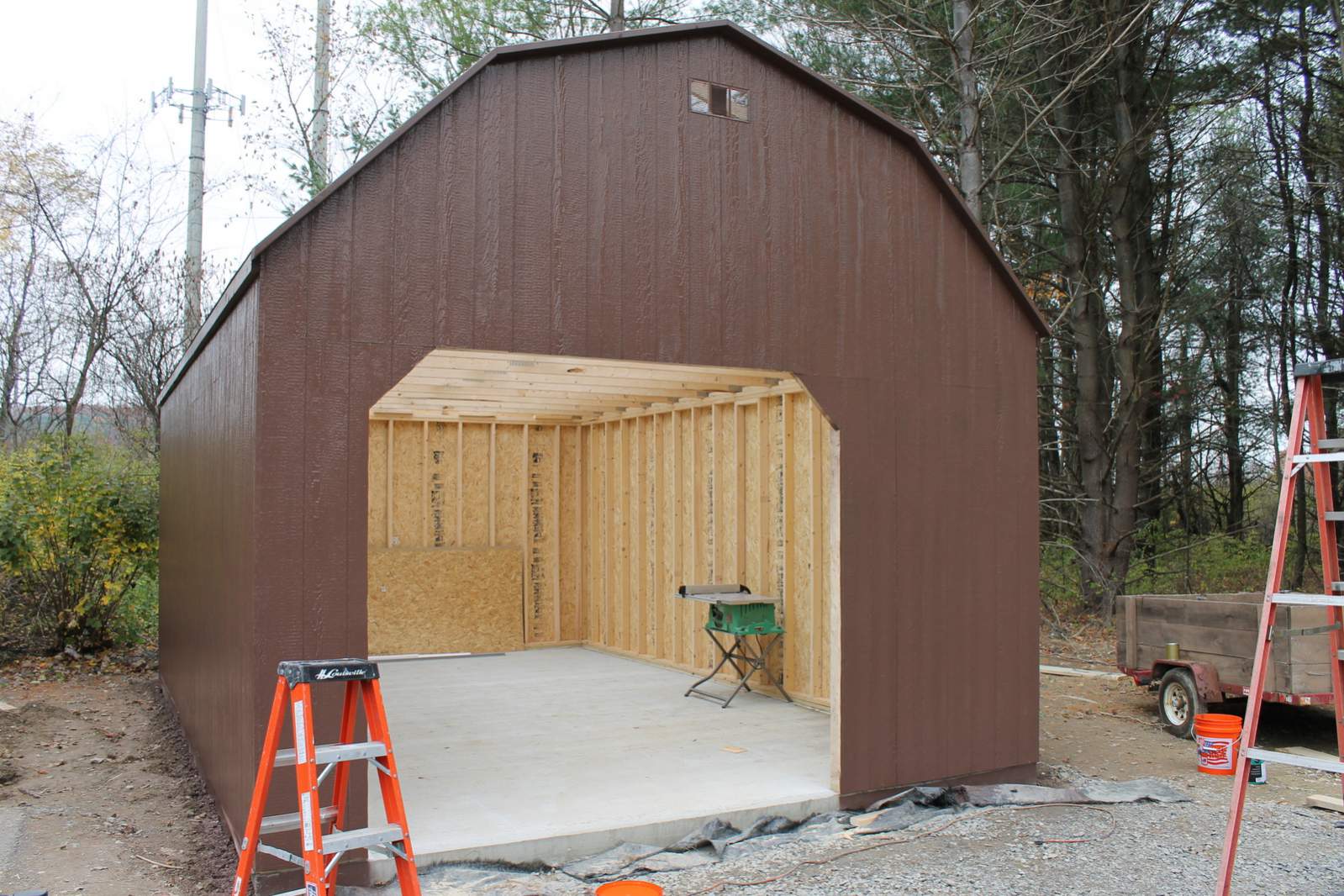

Did not use any plans, had a rough sketch in on paper, My brother is a contractor he has built many larger buildings. He helped with labor and layout of the building. Knew I needed a 8' high door and wanted the door off center so I could store implements and have access to
the tractor without having to move anything.
The reason it is 16' wide and 24' feet deep with 9' walls was to reduce the amount of wood wasted. To keep the cost down. Lumber comes 8', 10',12'.
The trusses ordered from the lumber yard, sheathing comes 4'x8' sheets same for the plywood for the roof.
In the end I took all the scrap from building the entire project to the dump and the scrap only weight 100 pounds.
The total cost with the cement floor was just under $8000 and that included paying my brother his hourly wadge.
The siding is Smartsiding composite panel siding It has a 5 year nu-painted warranty and a 50 year painted warranty.
I used my tractor with the backhoe to dig out the foundation. Used 4000 psi cement with fiberglass mixed in.
It was not hard to build, it was only the two of us doing all the work. I have more pictures of it being built if you are going to build something let me know and I can post them and answer any question you might have.
