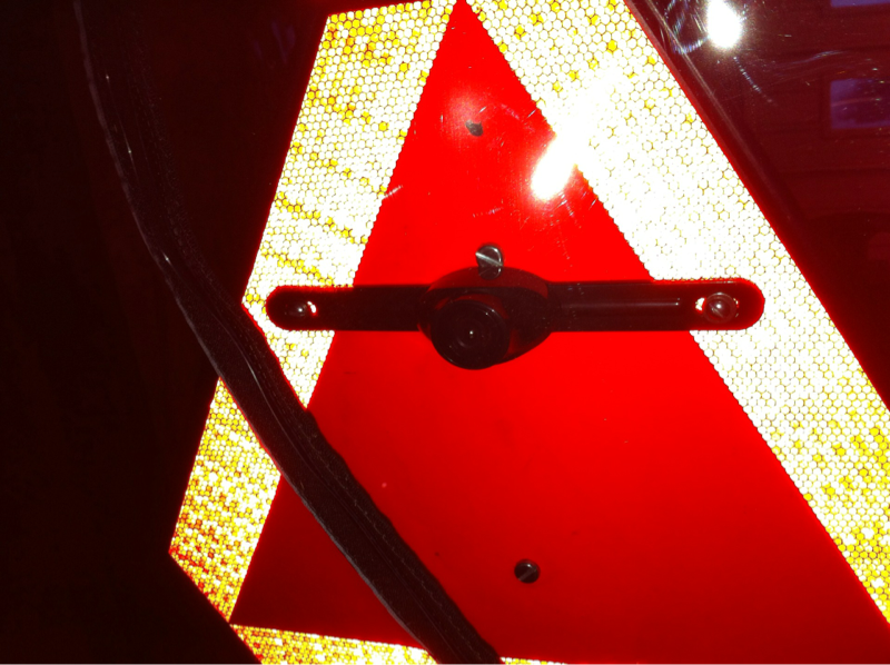

Thought I would share a few things I've done to make my snow removal work easier.

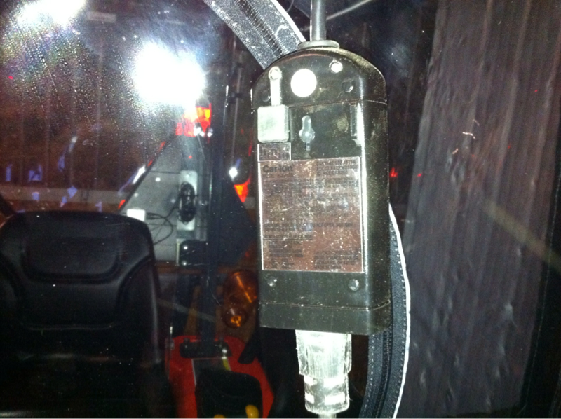

1) I installed a block heater this fall on my BX2360. My barn is about 125ft from the house and I wanted a way to turn on the block heater an hour or so before I bundled up and headed out to the barn. I thought about a timer but didn't want to needlessly run it on day's when I wasn't going to blow snow. Next I looked at a temperature controlled plug adapter (found it on Amazon) but same issue that it would run needlessly when I didn't need to remove any snow. So I ended up with a remotely controlled switch (Amazon link: http://www.amazon.com/gp/product/B000BQRHMM/ref=oh_o06_s00_i01_details) and now I can look outside from the house and if I need to remove snow turn on the block heater from I side the house. Have a cup of coffee and when I go out to the barn it's ready to fire up.

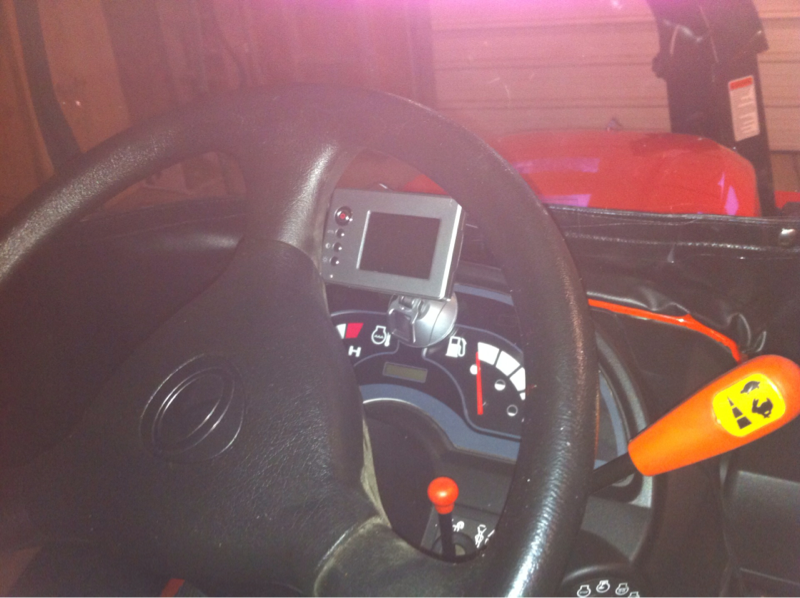

2) I purchased a cheap car backup camera. I got mine from Advance Auto Parts. I used a 40% of coupon (www.slickdeals.net) so it cost around $50. Getting older so having to turn and look behind me a lot while snowplowing is somewhat painful. This should help reduce that a lot.
Now I'll probably find out you TBN folks have found much better solutions but that is good as I'll, once again, be able to learn from your experience!

That's a great idea. I like the monitor mounting location.

I love it when a plan comes together! Do you have heat in the cab? The screen may not work well if you do not have heat as it is a liquid crystal display screen rather than a conventional television/gun type.

Great idea on the outdoor remote switch. I didn't even know these things existed but they make perfect sense. 150 feet seems like the max range. I'm going to try to locate one of these here as amazon.com won't ship to us in Canada. 150 feet will do it for me.

It is a three prong plug.
/ Backup camera and remote control blockheater #7
I use one of the remote switches. I find it useful to plug in an adapter between the heater cable and the outlet to accept a small light bulb, so I can see from the house if the switch made. The tractor's in an open shed facing the house. I have to aim through some bushes so if they're snow-covered the remote sometimes doesn't activate the switch.

I was considering a backup camera for my rear snowblower as well. I wasn't sure if it would get snow covered or not. I have one on my Jeep and it works well, but I do have to wipe the lens off once in a while. Let me know how it works.

I had one of those remote switch things too. I hooked it up last year but it didn't seem to want to work half the time & I couldn't tell if it "took" or not so I had to put a drop light out there & try to see if the drop light came on. I may try to do something again in the future but it was a pain in the butt & I gave up on it. Not too hard to run out & plug the thing in.
I want ot see how the back up camera works for you because I have a rear moutn snowblower & get wicked "owl neck". I'd like to try something like that.
