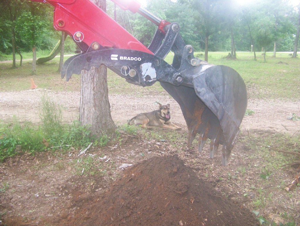

My Bradco/Mahindra 511 is spec for the 7520 and 6520. When I bought mine, I didn't realize the difference in pump gpm between the two tractors is 6 gpm. I have to run my tractor at full rpm to get good results, were as the 7520 can be run around 12-1500 rpm. I wish I would have bought the 7520 with it's 17 gpm pump.
I hope I am wrong, but I think I see a PTO pump in your future. Sorry to be so bleak.
hugs, Brandi

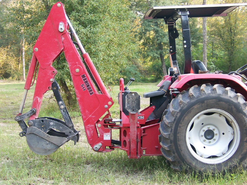

I have a 3510 with a 509 bh. The backhoe runs off a pto pump, rpms are usually around 1200-1500. The 509 is a beast. When I first got it, I refered to it as getting a backhoe with a tractor attached. I'll try to post a photo or two tomorrow anything in particular you'd like to see (bh is off tractor now)?
http://www.tractorbynet.com/forums/...ting/71178d1172530452-3510-lift-kit-after.jpg
Is your pump a Mahindra or after market? If aftermarket- Mfg and model of tank and pump.
I would like to see the lift arms with subframe and how the chains are removed to mount unit.
how high off ground to set BH after unhooking for ease of hooking up
Thanks and your rig looks like mine- bad to the bone!!
/ BACKHOES LETS SEE THEM #318
My pump came with my tractor/bh, more than likely Mahindra. Mahindra's setup doesn't use the lift arms (they are taken off for BH installation). The subframe is aways on the tractor. Two pins hold the bh on the tractor--very easy on/off set up. I'll get some photos today-hopefully.
