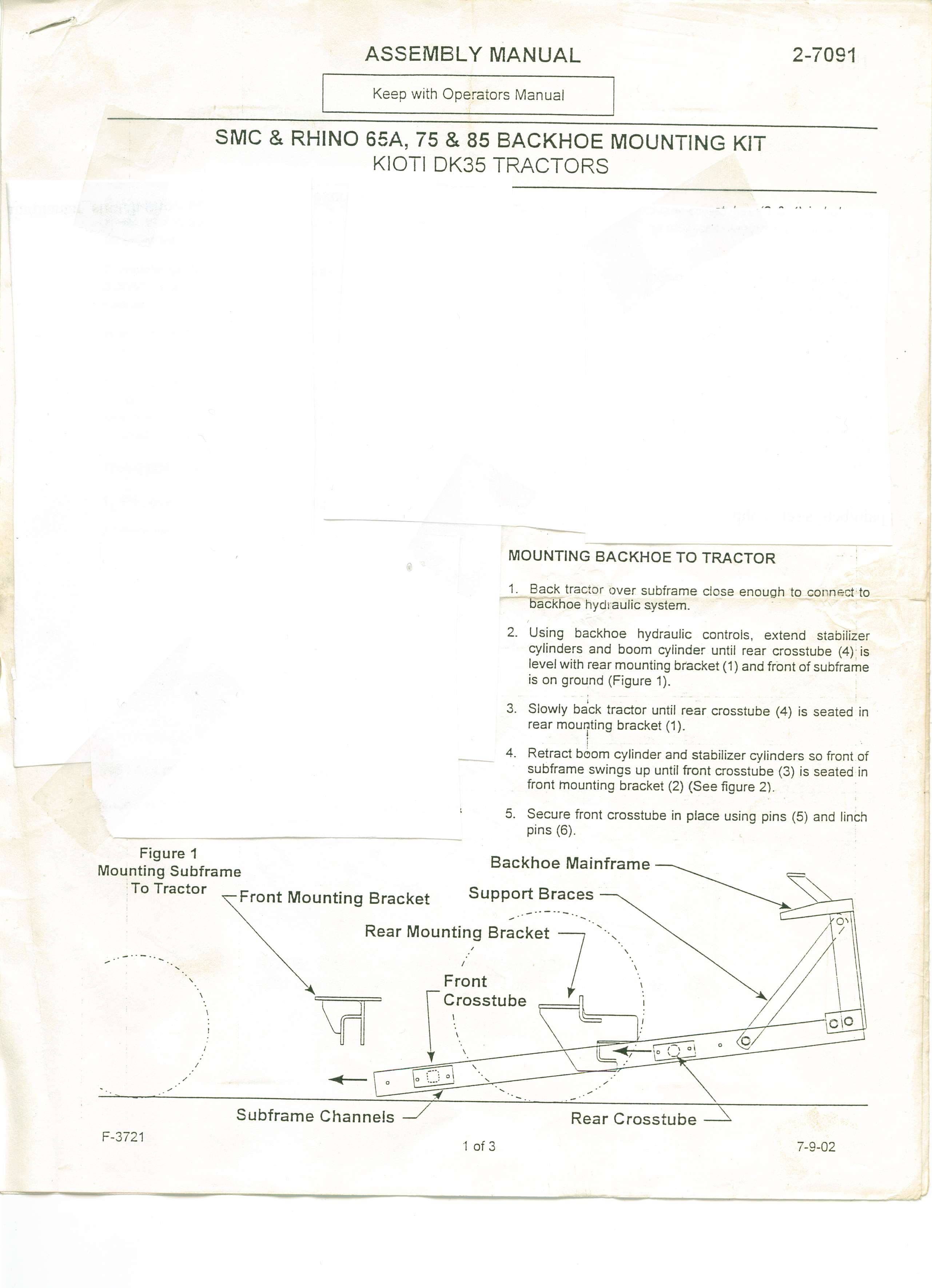

My manual does not mention anything about installing the top link.
I tryed to attach a page from my owners manual on mounting backhoe to tractor, but it does not seem to be working very well. (computers are not one my strong points).
It basicly just says to back over subframe, get rear subframe cross tube into rear mounting bracket on tractor, get front subframe crosstube into front tractor mounting bracket, install pins.
Doesn't say anything about installing a top link.

Does the 2365 have a 3/4" hole under the seat for this purpose?
Same question to Vince for the Rhino....is there a hole under the seat?
If you guys both bought the subframes and installed them yourselves, it
seems no special toplink came with it, correct?
/ Backhoe - What is normal slack? #18
My Rhino does have a hole for a top link under the seat.
It also has holes for lower lift arm pins.
The backhoe is made so it can be used as a 3 point hoe or attached to a subframe.
I ordered a subframe kit for a DK 35 as an extra.
No special top link is included with the kit.
