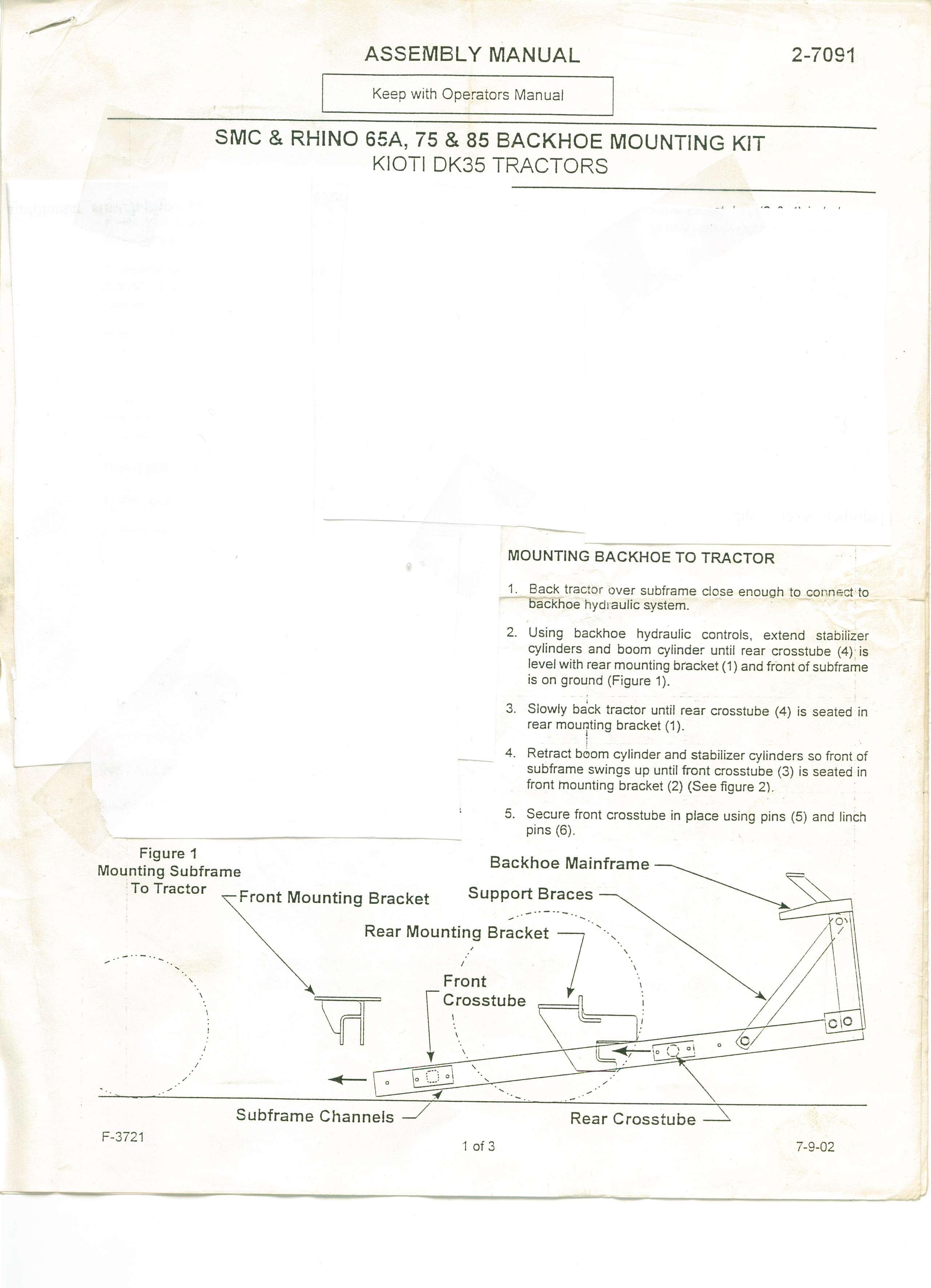

My 2485 does have a spot for a top link as well, also under the BH seat. And one of the pictures (drawing) in the BH manual does show a top link attached. The picture only shows the tractor end so I'm assuming the other end is attached to the BH.
I will plan on contacting Kioti this week and get an answer straight from the horses mouth. I can see how a top link could help with the "flex" issue but certainly don't want to damage the tractor.

Many of these backhoes are made so they can be mounted several ways and on differant type machines.
My Rhino 85 has the holes for mounting on a tractor 3 point hitch (3 point hitch bracket kit sold seperatly).
It can be mounted on a tractor subframe (subframe optional, sold sepearately).
I think you can even get a kit so the same backhoe can be mounted on a skid steer.

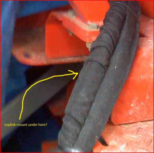

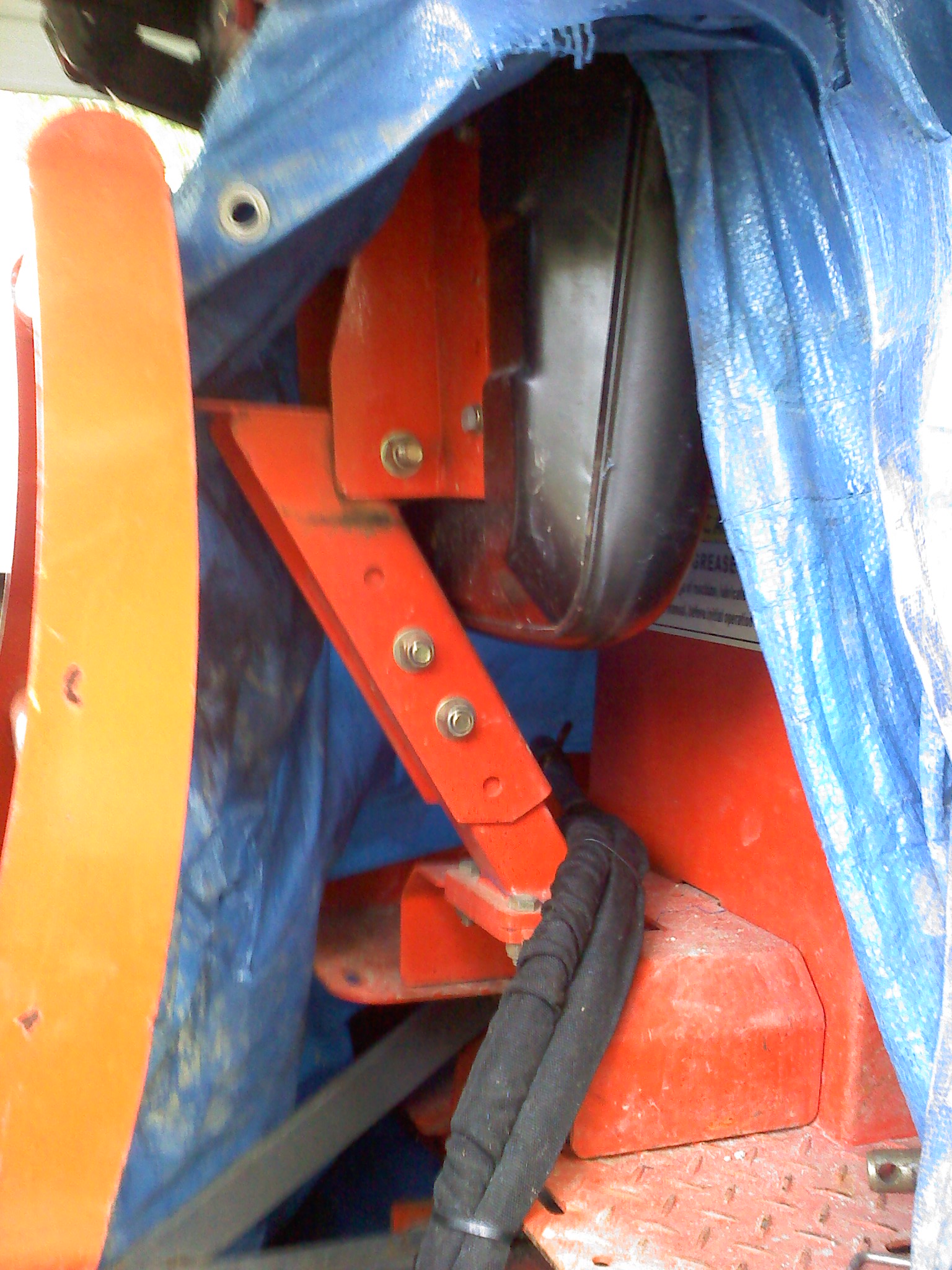

I just went outside and looked at my backhoe which is still in storage and there is NO mount for a top-link. The only holes under the seat in the general area that a top link would mount are for adjusting the height of the seat. This is a 2006 model Kioti KB2365 backhoe.
I assume you looked way under the floorboards, Derek.
Note that GIL's upgraded hoe of the same size, the BL2465, does have
toplink holes, and the BL2475 does, too.
