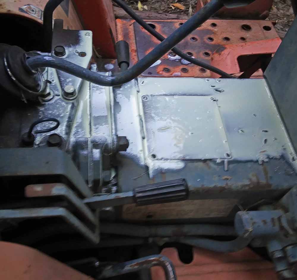

The overflowing pipe in pic #2 is on the tractor? Try running the tractor with pto on and at the engine speed that corresponds to 540 rpm at the pto, without putting the BH's pump on the pto. Maybe you ran the post hole digger at low rpms or not long enough to show the problem.
Overfilling the tractor's transmission could cause oil frothing which could make some oil come out the breather. But the pump on the pto shaft can't put pressure or oil into the transmission.
I'll pull the pump and try it. I always ran the posthole digger with the lever at the 540 position, and the tachometer in the "green".

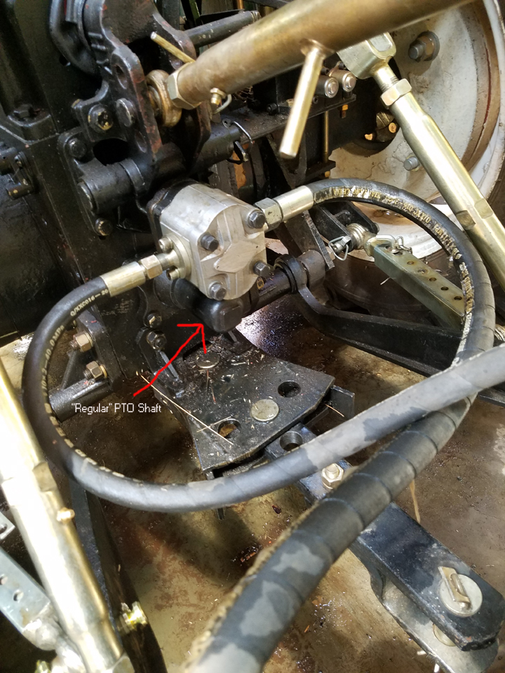

I will have to post more specific pics Tomorrow. The PTO pump fits on a small shaft up above the main PTO shaft (the large, splined shaft). I pulled the pump this evening, and clean hydraulic oil came running out around the small shaft on the tractor (flowed out for a good 10 minutes...at least a couple gallons). Backhoe sump is way down. So, it appears the pump was definitely driving fluid into the tractor.

Hmm....Two PTO shafts? One larger (diameter) than the other? That's a new one on me. But like others, I am not familiar with the Jinma.
On most domestic tractors the PTO-driven pump simply slides over the PTO splines and is kept in place with a short chain. How does your hydraulic pump mount?
If there are two shafts both parallel and close to one another I have to wonder if they are directly geared together. If so, the rotations would be opposite one another. As you have the pump off now, it may be possible to rotate the shafts with your fingers if the PTO clutch is disengaged.
Here's a re-oriented pic (labelled). The pump bolts to the tractor above the regular PTO shaft, and has a slotted adaptor that joins the shaft to the pump. pump 2.jpg
This is the type of interface on the back of the pump: cbt-e3.jpg
The PTO lever has 2 speeds (540 and 720). Posthole Digger was run at 540.

Could you show us where the pump fit on the tractor?
The usual PTO pumps have a hollow splined port where the typical 6 spline PTO stub fits. The pump is sealed as is the PTO stub on the tractor. There's no way oil from the pump can get in the tractor unless seals on both the pump and the PTO stub are totally missing and even then most of the oil would end up on the ground. Your pump looks very different. It may be special for jinma. This may be why people are confused, we all assumed you had the typical pump.

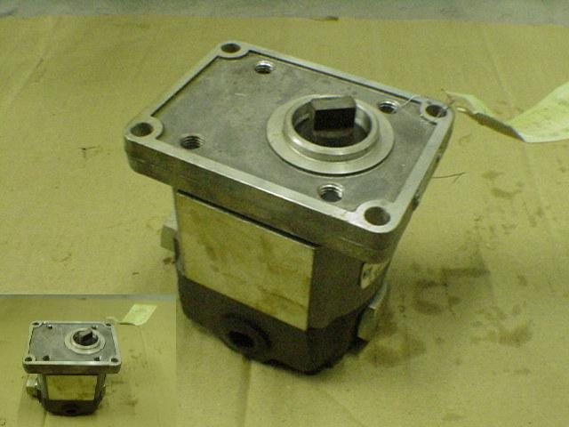

Your pump looks very different. It may be special for jinma.[/url]
Yes, apparently it's unusual. I called Circle G Tractors, and they were not too surprised. Apparently I need to rebuild the pump, there are several seals in it that can fail. Ordering a rebuild kit.
That Jinma is indeed very unusual. Like you, I do not see how oil would get from the failed pump into the tractor sump. TWO seals would have to fail, I would think.
Note that Deere x55 tractors also put their implement pumps hanging off the back, right above the normal PTO shaft.

Looking at the picture of the pump it is clockwise rotation as viewed looking at the tang on the drive shaft. Which way does the PTO spin on your tractor
I.e. while looking at rear of tractor where the pump mounts it would be counterclockwise

I was told by the Circle G parts guy, that the upper tang shaft where the pump mounts, goes the opposite direction of the PTO shaft. The hydraulic pump was supposed to be designed for that, but who knows? I need to check it thoroughly after I kit it.
/ Backhoe Pump Deadheaded??? #38
Knowing which way the tang is turning will probably tell you which of the hoses is feed and which is pressure. You will confirm that when you kit it & actually see the internal gears. The way that the tang is off-center on the pump makes it a sure bet that you have a typical spur gear type hydraulic pump. So find the direction of rotation of the tang, then study this link and you will see how to tell which hose is your pressure hose to the BH controls and which is inlet supply. Note that the oil flows around the outside of the gears... carried by the space ibetween the gear teeth and case. Oil is NOT squeezed between the gear teeth to any great or effective amount..
Hydraulic Spur Gear Pump | Hydraulic Pump
I'm not surprised that the upper tang turns reverse of the PTO - all that means is that tang and PTO are geared together without an idler gear in between. That makes for less parts, easier to design, and enables the PTO clutch or actuation to work both systems.
