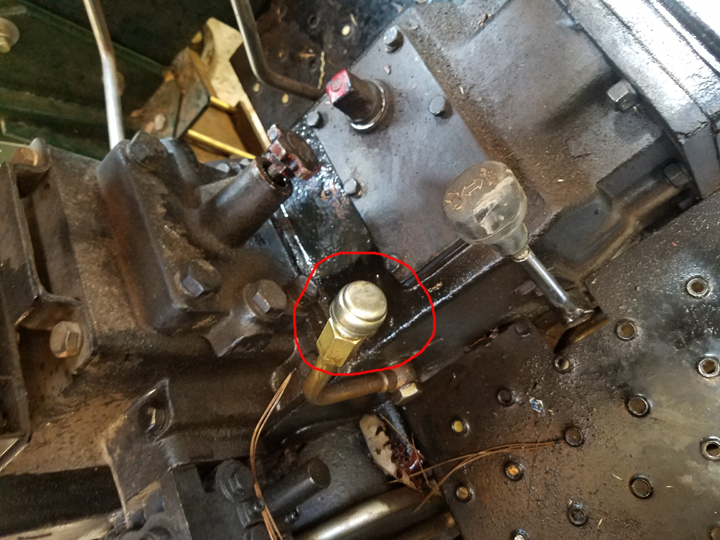

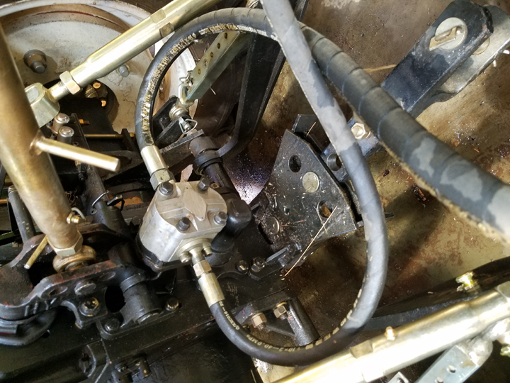

Rookie operator here. Checked the direction of flow on LW6 backhoe's pump before hooking up to my Jinma 554, by putting a clear tubing filled with fluid, on the outlet ports of the pump. Had to cross the lines to hook up correctly (suction side = large hose). See Image #1
After pressurization, hydraulic fluid is flowing (rapidly) out of the circled area in Image #2 (could someone tell me what this pipe's name and function is)? I'm assuming it's some sort of overflow valve.
Valve under the seat is completely screwed down tight. Tractor never had this leak, until I hooked up the hoe.
Wondering how I would locate a new seal for this pump, and if that would solve the problem? Thanks in advance.

It looks like your hoe is using a PTO pump, according to your first photo. Your second shows a pipe connected to what looks like your tractor's sump. The 2 systems' hydraulics should be independent. If you connect your hoe backwards, and run it, you can blow a seal in the hoe valve.
That said, it looks like the pipe in your 2nd photo is some kind of tank vent, as you said. But it uses a hi-pressure hardline and banjo fitting. Strange.

You're correct dfkrug, it's a pto pump on the rear of the tractor. Since they are supposed to be independent (the pto pump is supposed to use the backhoe sump)...I'm assuming that the seal on the pto pump must have blown, and is pressurizing the tractor sump?

Is the oil coming out the vent foamy or milky?
/ Backhoe Pump Deadheaded???
But they are not connected hydraulically at all.
I would say definitely "milky".

Where is the pump inlet hose connected for the back hoe pump? If connected to a reservoir on the back hoe then all of the lines on the back hoe should remain connected to the hoe. If one is the the hoe and the other to the tractor you will over fill one reservoir and drain the other.
If connected to the sump or reservoir on the tractor then the return or tank line from the back hoe must also be connected to the tractor sump preferably below oil level and as far away as possible from the pump inlet.
Returning oil above the oil level can cause foaming and aerate the oil.
Another potential problem is the back hoe pump flow rate vs the sump size of your tractor. To much flow rate can also cause aeration - foaming of the oil.

Oh-oh, water in the oil.

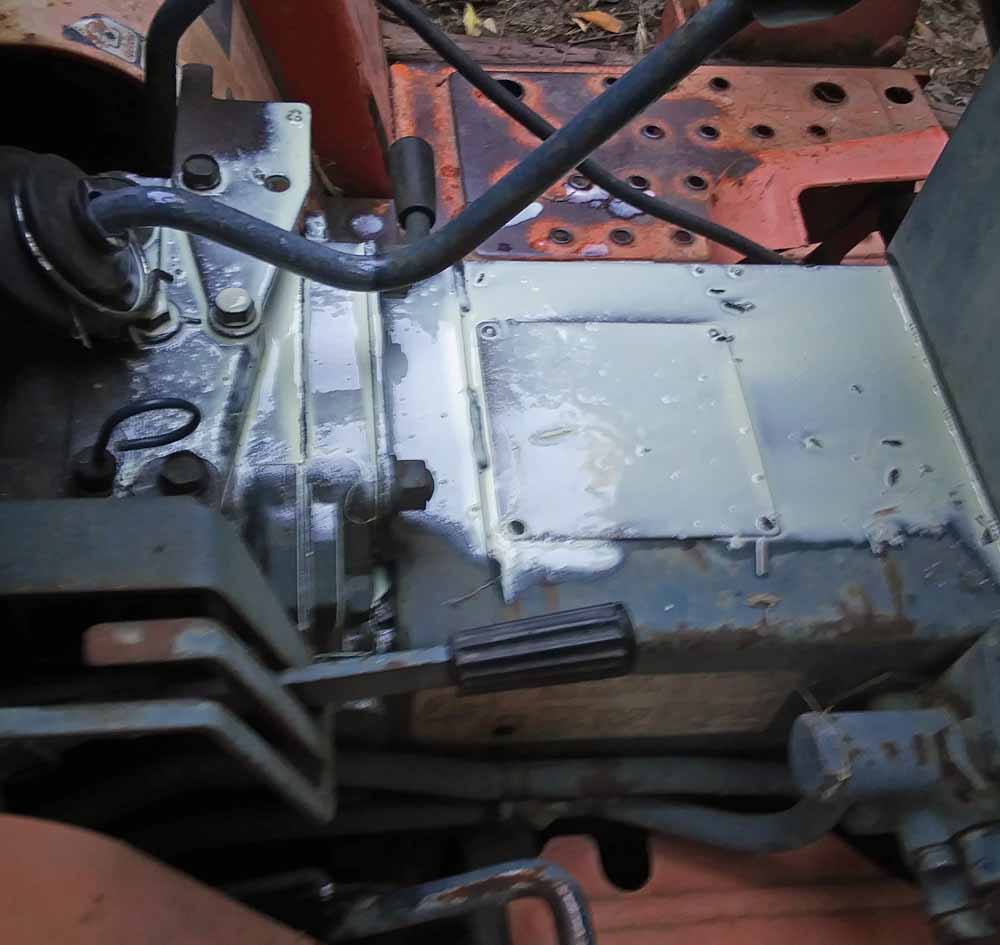

This is probably unrelated to your PTO pump system. Water got into the sump, possibly from a torn shifter boot, and the volume of oil/water is such that it overflows when operating the loader.
This photo shows what came out of the shifter boot when I ran an old neglected Kubota I picked up this summer.

Probably impossible. This Tractor is stored in my Workshop Year Round, and is never left out in the weather. Like I mentioned earlier, I never had this leak until I hooked up the backhoe. It seems the "milkyness" could be from air pressure (possibly from the pto pump)?

Yep, that looks typical. When water mixes with the oil you always get an emulsion that looks like milk after it gets stirred up. The color can range from dark chocolate milk to as white as your picture....but that's water sure enough. I've wondered if the peculiar milkiness is due to the detergents in modern oil.
Trans/hydraulic oil doesn't see any combustion and there isn't much inside a tractor to contaminate it. Generally it should look the same after 1000 hrs as it did new.
And yes, the shifter boot is the prime offender. It's crazy that they aren't better sealed. Also, if you have milky trans/hydraulic fluid you may also find water in the steering box at the base of the steering column. Water can enter the center of the steering wheel nut and fill up that steering column until it eventually makes it past the bearing seal into the steering box.

99% of pumps can only rotate one direction,,
rotating the pump the opposite direction will cause the pump to blow the seal at the input shaft,,
The pump can be an exact replacement, but speced for the wrong rotation,, and you have a problem.
Some pumps can have the rotation changed by the user,,, by flipping some part of the pump.
Also, if the inlet and outlet to the control valve are swapped at the time of connection, the pump will have no relief valve, and the seal at the pump will blow.
Having the correct pump (rotation) and having the correct fluid direction flow is critical,, do not guess,,,
