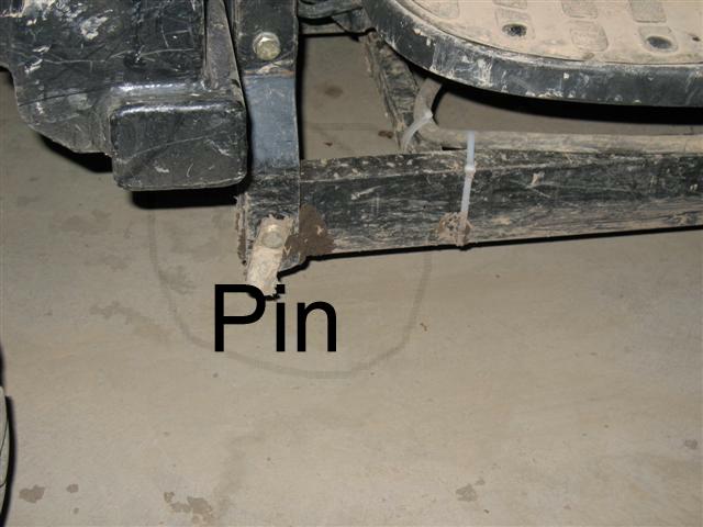

GuglioLS said:
Did the hose blow when the quick connect became disconnected?
Instead of using nylon tiewraps on the Quick Connnects - use a hose clamp to prevent them from coming undone. They are much stronger than plastic and are re-usable.
The hose breaking was on the loader
The quick conn is on my BH poping off issue.
Do they make a hose clamp that will fit over the frame?

I don't know how your pin attatches on the other end, (threaded/nut, hole for lynch pin), but on larger equipment, there is a hole in the end of the strap that is welded to pin (the end showing in pic). Drill a hole for a 3/8 bolt to fit through, turn strap and mark hole in bracket/channel, drill and tap/or drill for 3/8 bolt (see attatchment), then fasten in place with bolt. Hope this works for you.

If the pin is the one shown a bolt and nylon lock nut should work.
