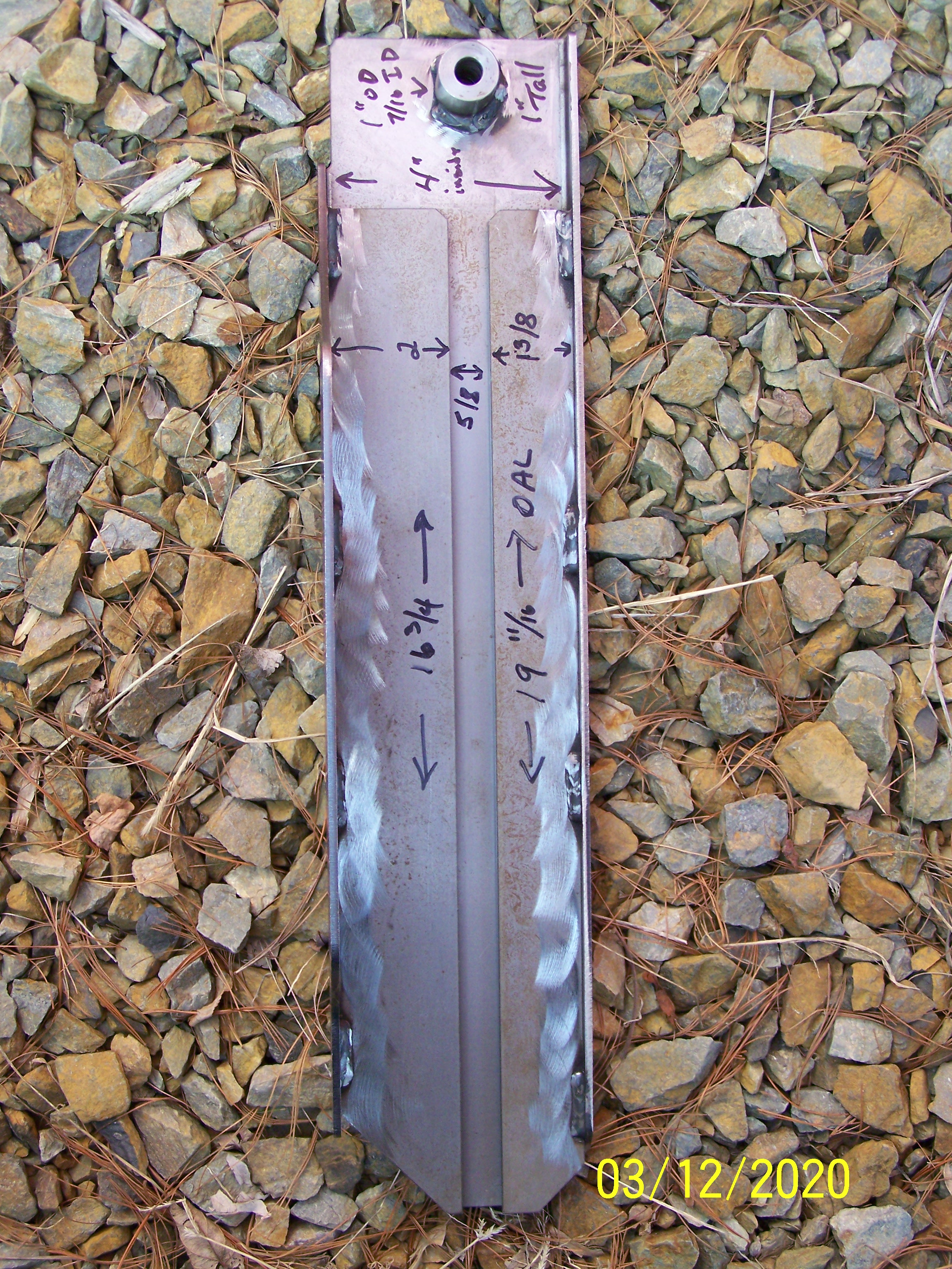

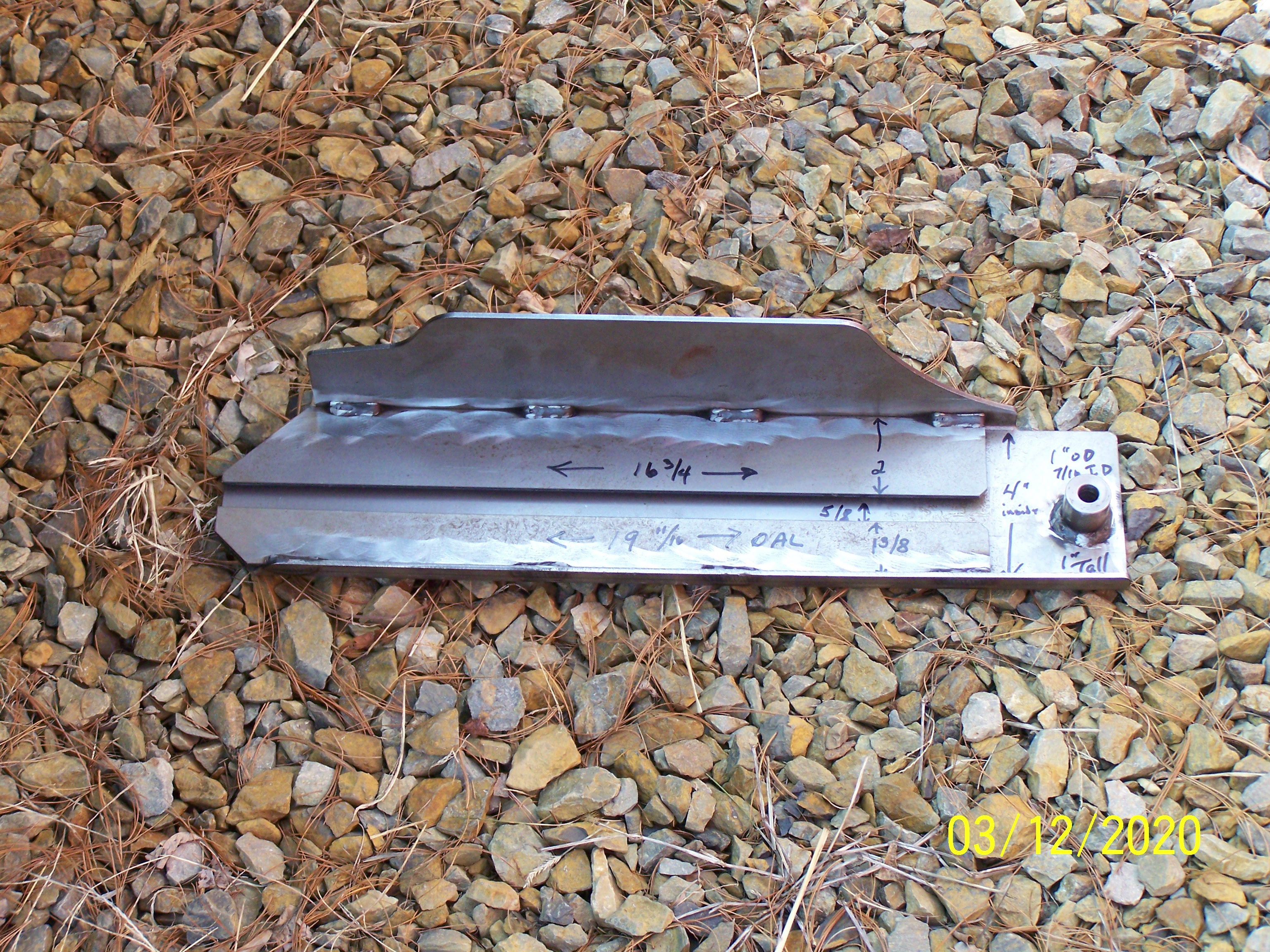

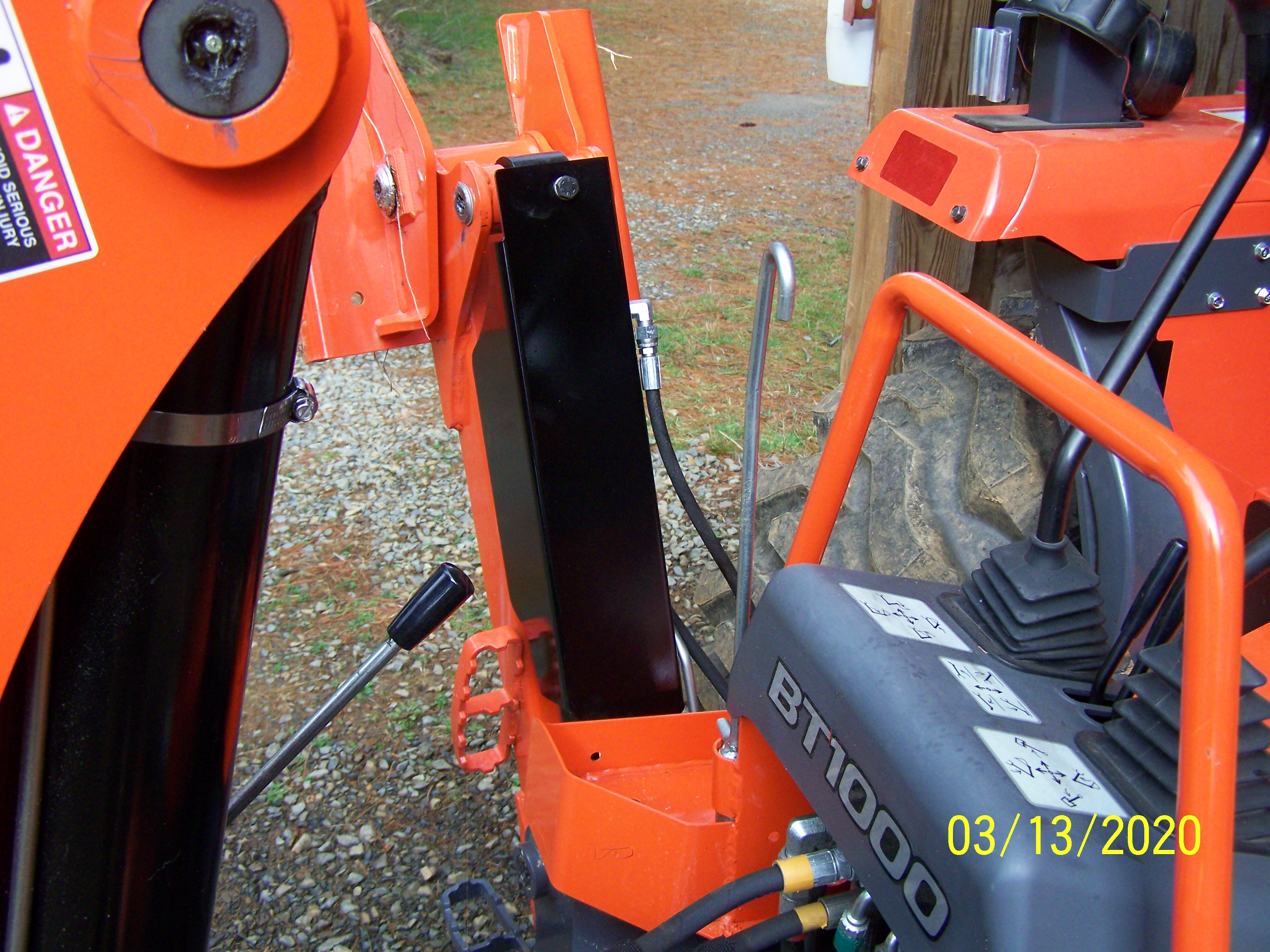

As I mentioned in post #16 I ordered a set of covers. They arrived today. I hope the measurements help. If more are needed, let me know.
I am thinking I might be able to modify a set of those to fit my L48

I expect that the outrigger cylinders are the same size, or very close. The only thing you would need to make, or have made, is the mushroom shaped piece that's welded to the cylinder body.
That’s great. Thanks for taking the pics for us. Could you show them mounted when you get them on? Thanks!
/ Backhoe outrigger protection? #24
Sure, I can do that.

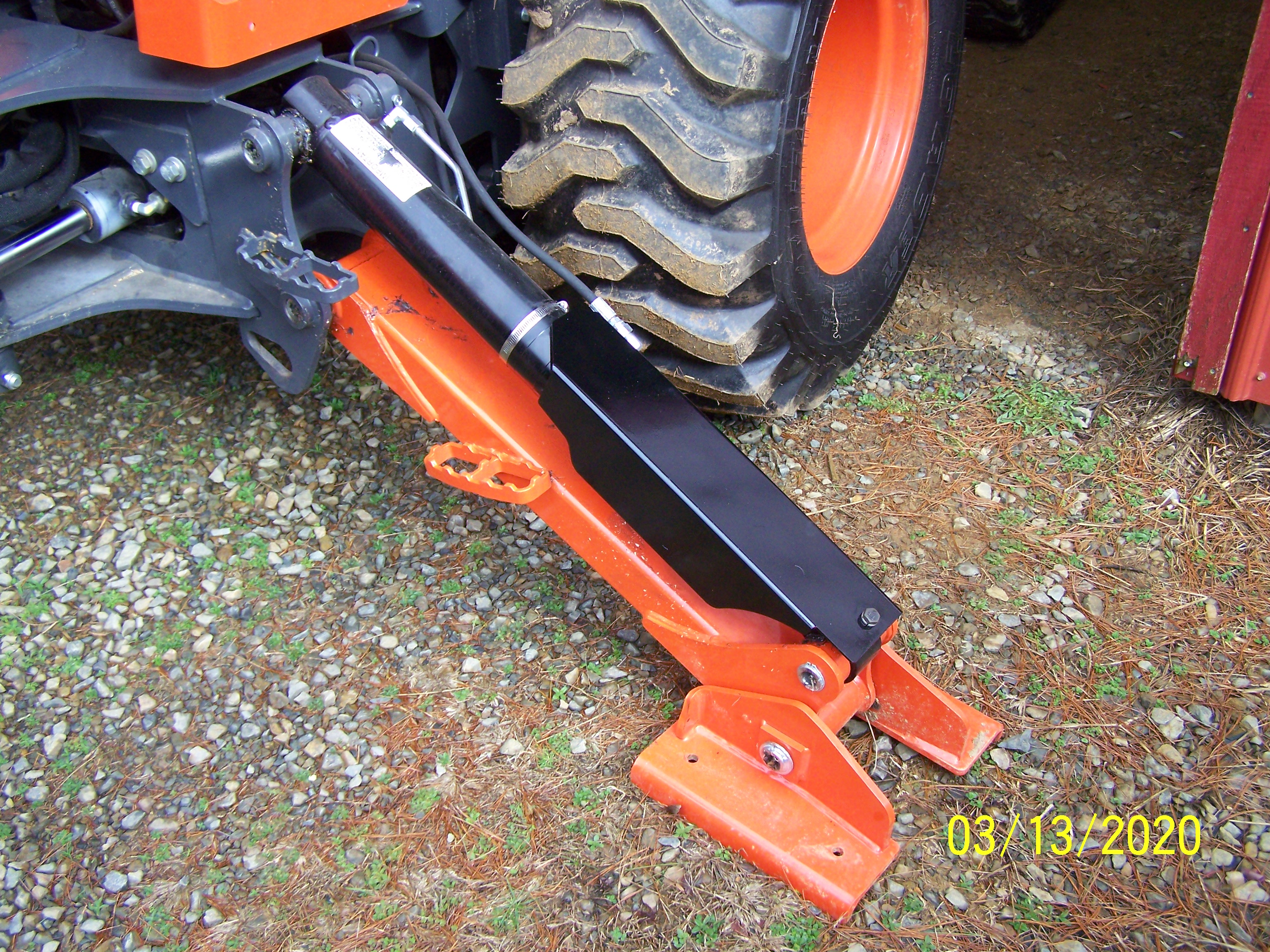

As you can see, they came unpainted. Fortunately it was pretty warm today, so I was able to paint. I should be installing them some time tomorrow.

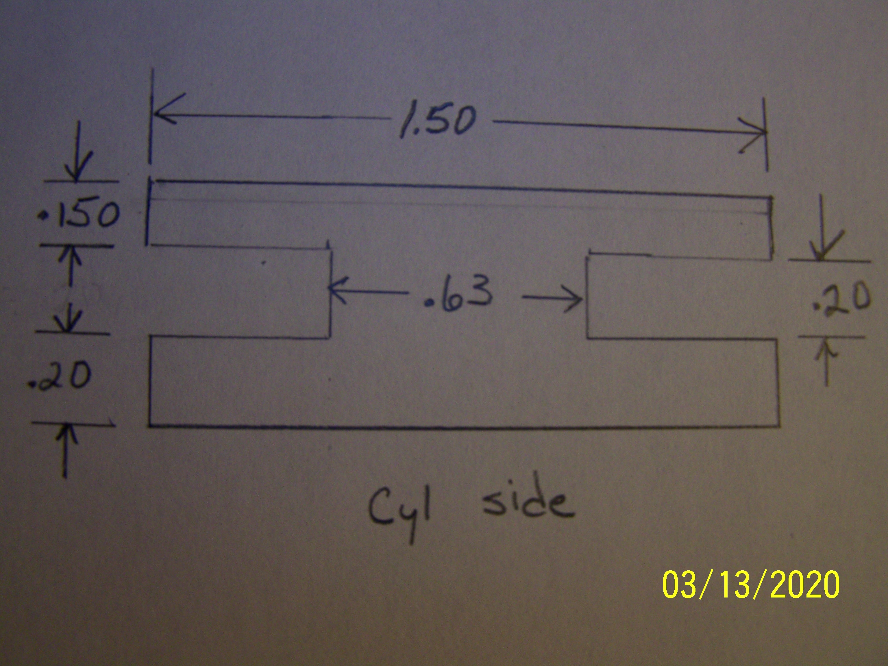

BTW here are the measurements for the "mushroom" that needs to be attached to your outrigger cylinders.
Please forgive my drawing skills. My one and only class was in 1968.:laughing:

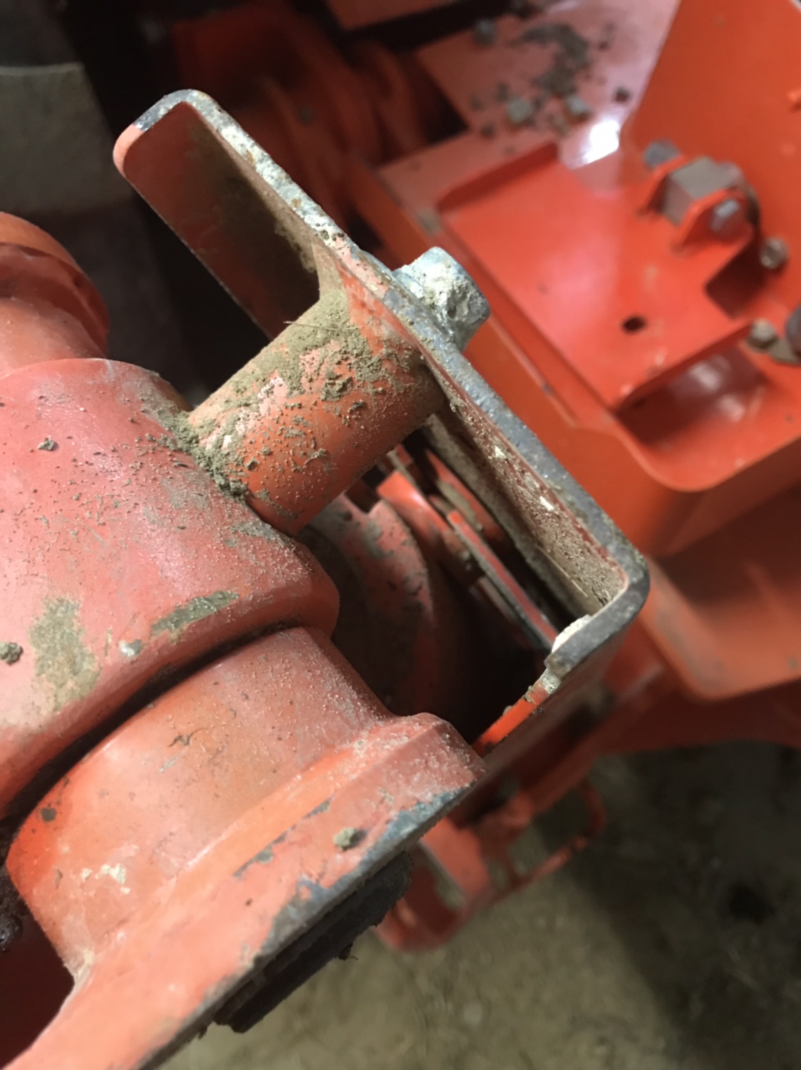

The egging out at the pivot is not really due to wear, it's distortion from the pressure applied. I actually tried increasing the size of the pins to one inch and made them grease-able. I think they lasted about two minutes longer. I think brass will distort even sooner.
There just isn't enough bearing surface. I think the grapple arm is 3/8 in, sandwiched between two 1/4 in stationary plates. By comparison the HD model grapple arm pivot is 3 1/2 in and the outer stationary points are 1 1/4 inches wide on each side. The pivot pin is 1 1/4 in.
What I thought of doing to the E grapple was to make the pin stationary on the grapple arm and weld on 1 inch id bushings 1 1/2 inches long on either side of the stationary plates, giving the pin 3 1/2 in of bearing surface

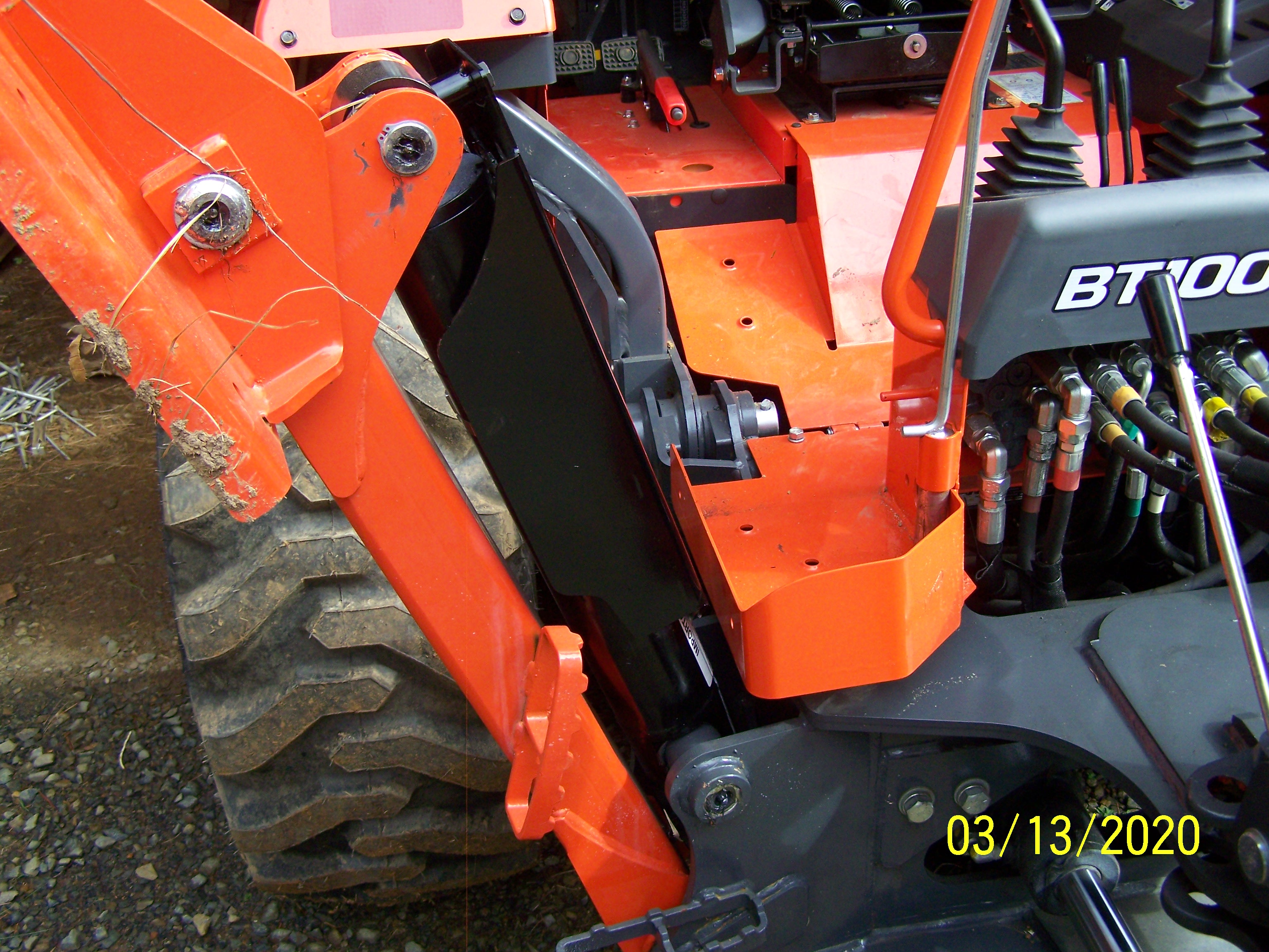

Here are photos of the guards installed.
