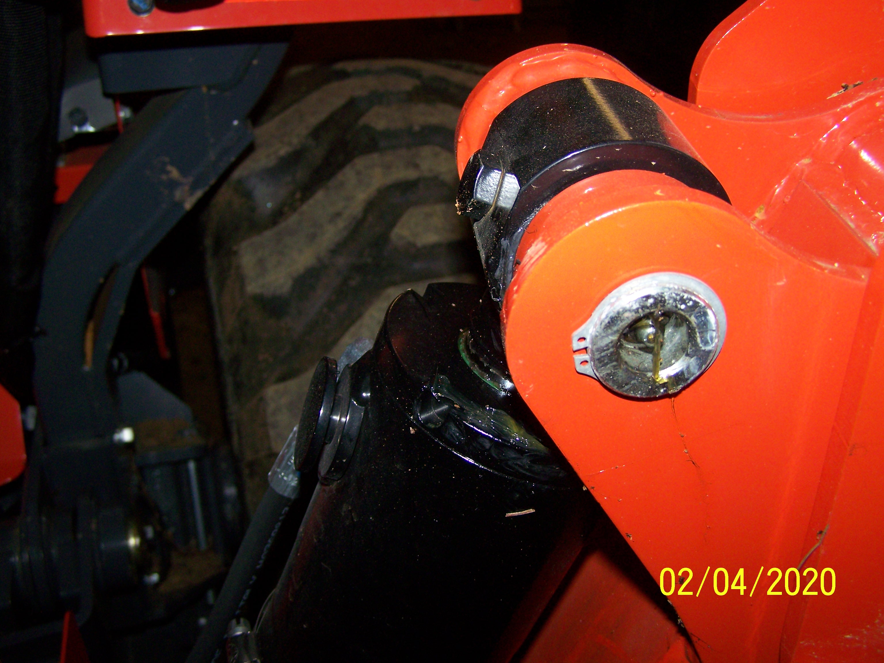

/ Backhoe outrigger protection? #7
Looking at the parts drawings for the BT1000 and the BT1100 it appears that there are attachment points on the 1000 that don't exist on the 1100.
The cover bolts to the end of the cylinder and has a track that slides along a mushroom shaped piece which is welded to the cylinder body.
Please excuse my terminology, hydraulics is my second language.
It's really a simple design, that could be adapted easily as long as the bolt hole could be drilled and tapped and the mushroom could be eather welded on or attached with a band to the cylinder.

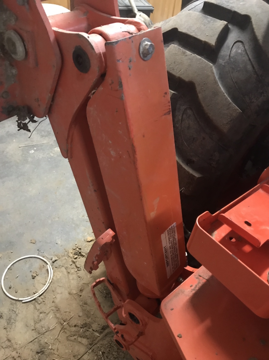

They have a slider on the cylinder body that you’ll probably have to weld on but it doesn’t look like a hard retrofit. The length is the only part I see that might be different. How much difference is there in a bt1200 stabilizer and a bt1000 stabilizer?IMG_8289.JPG

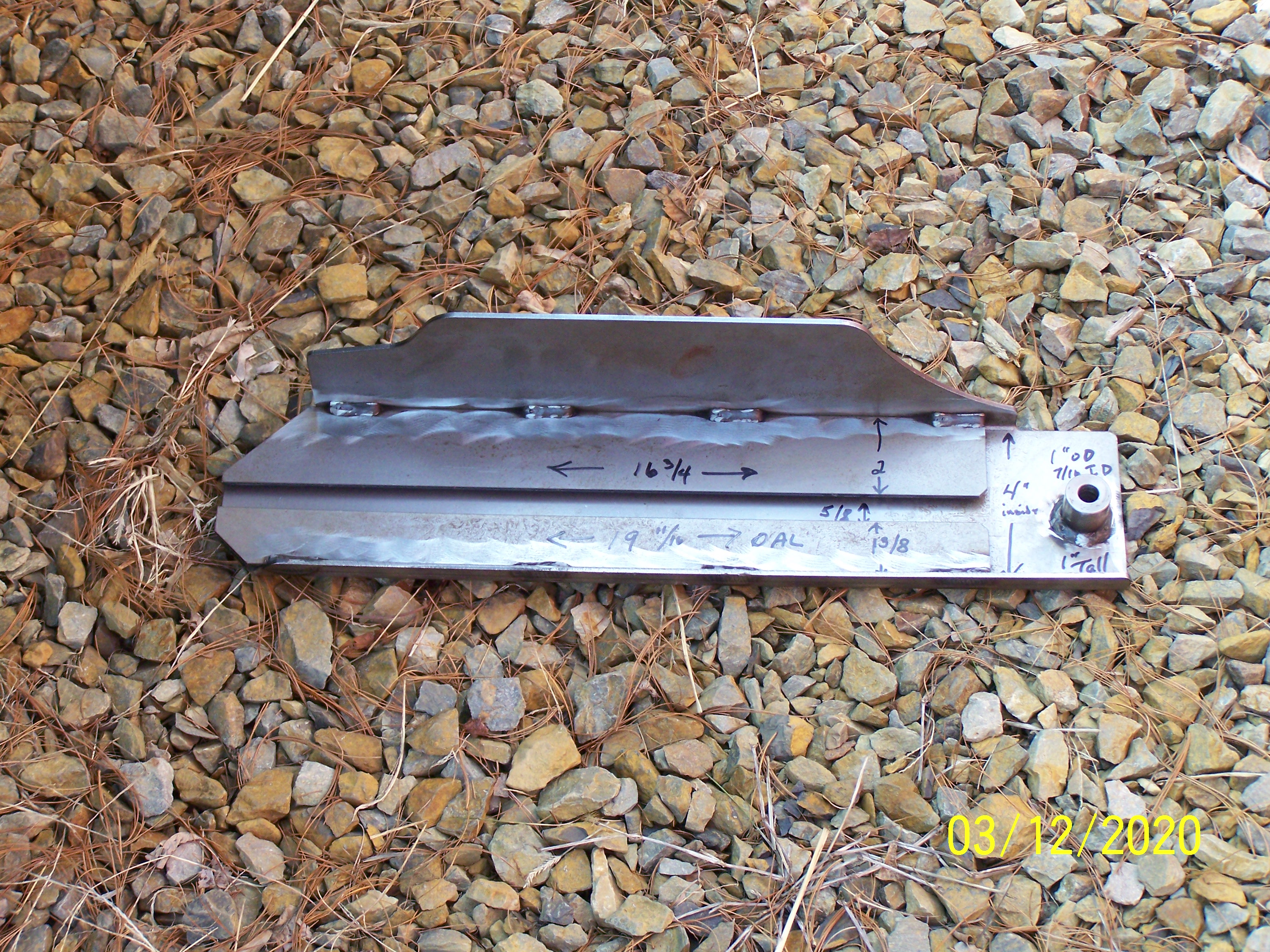

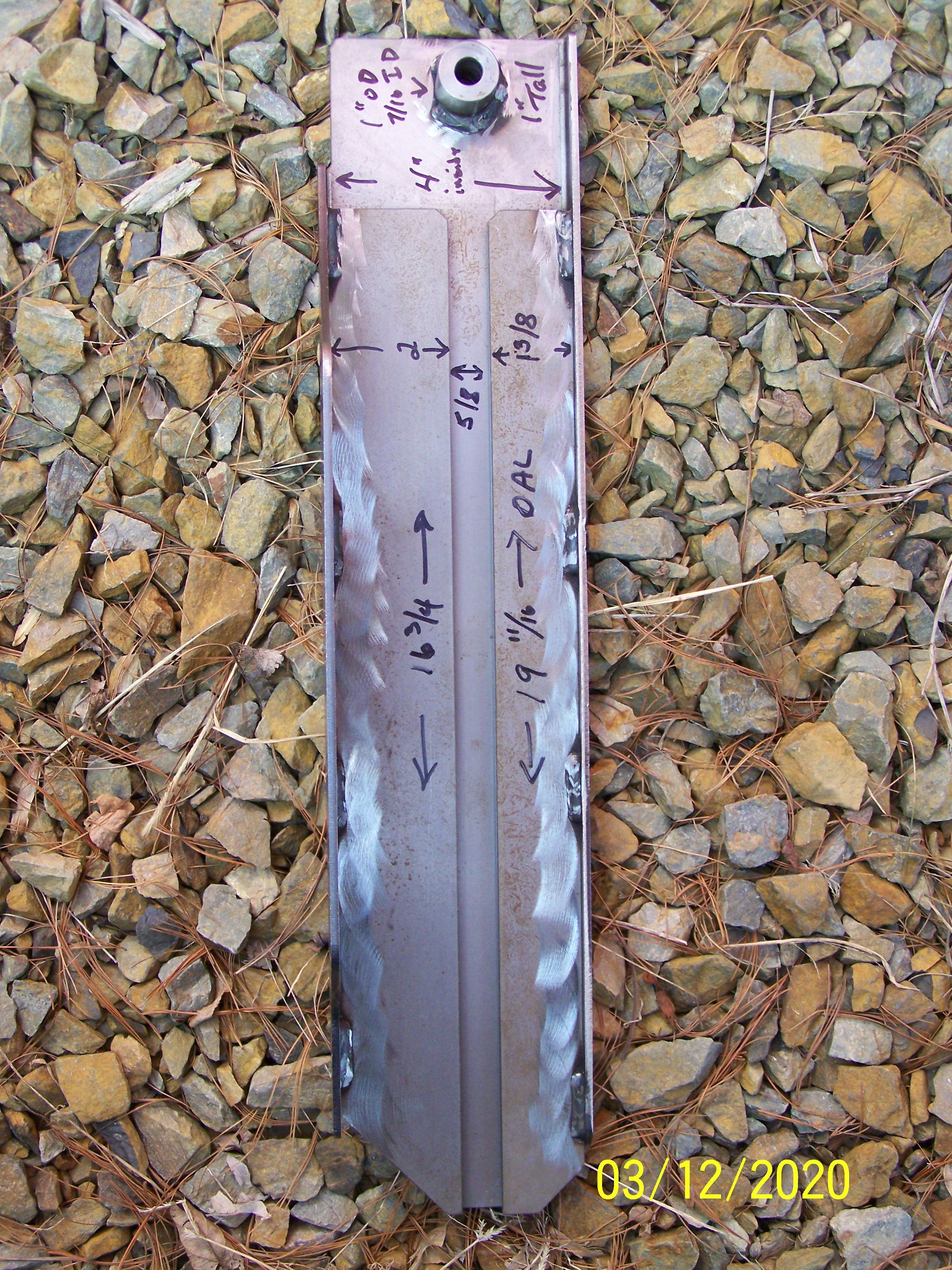

As I mentioned in post #16 I ordered a set of covers. They arrived today. I hope the measurements help. If more are needed, let me know.
