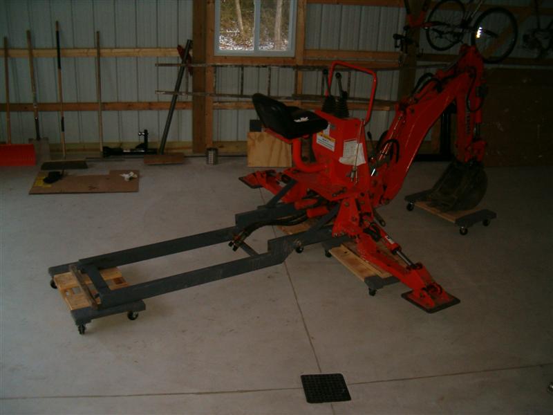

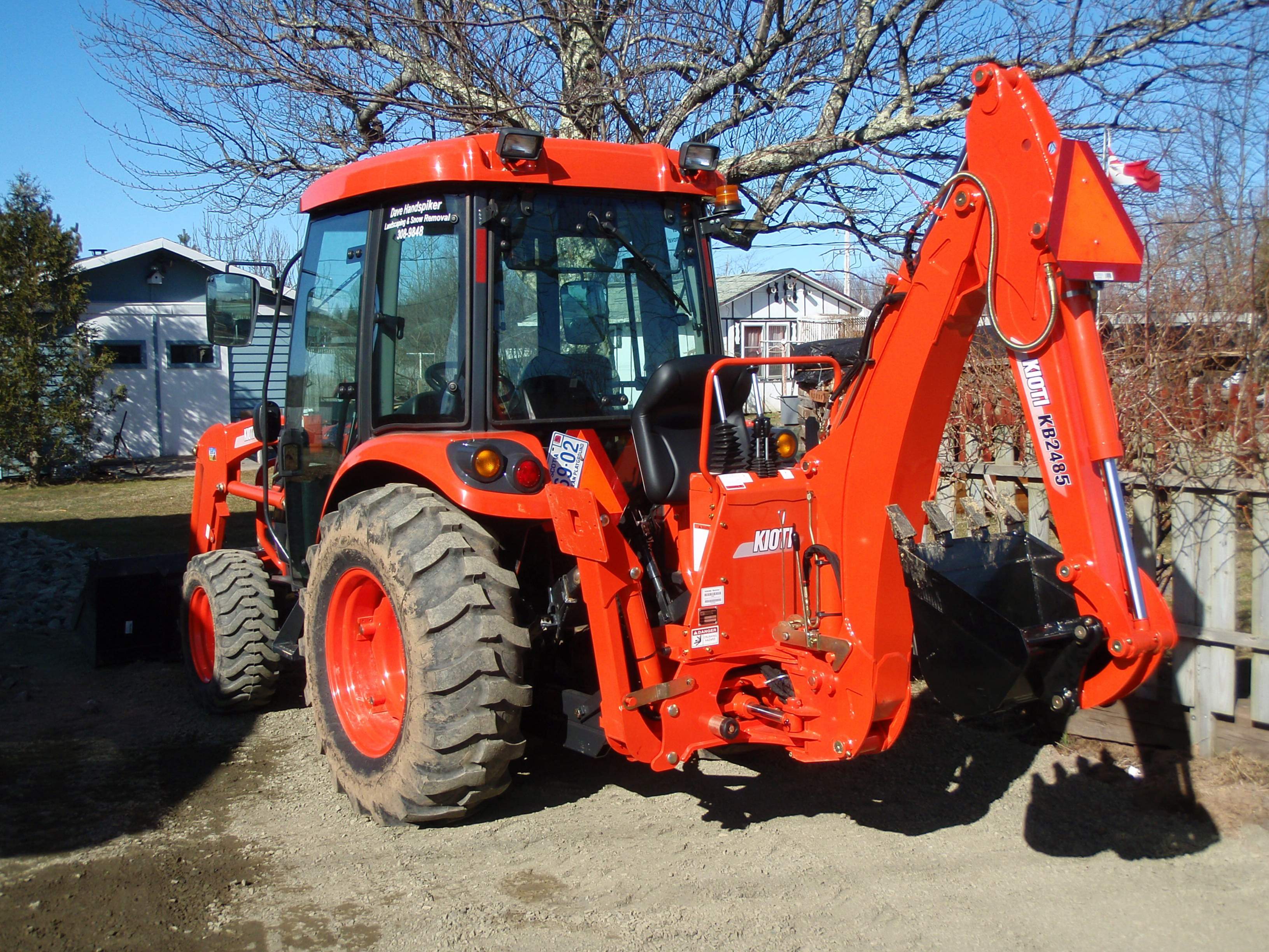

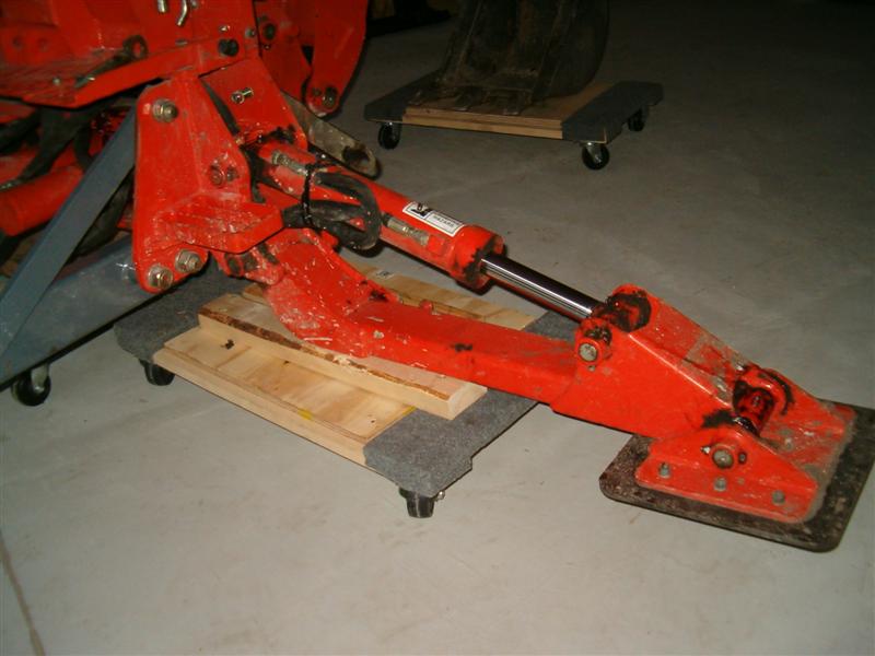

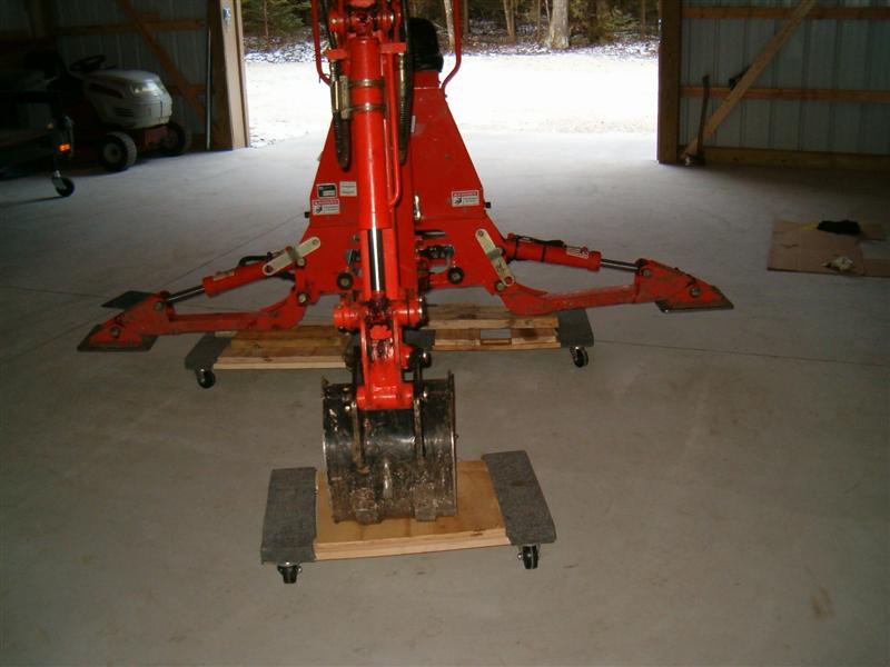

Final it's here, my new KB2475 backhoe. I have the 18 in bucket and had the bigfoot pads installed. Now just have to get used to operating this thing:D:laughing:
Nice hoe, Karl. Are you going to connect up the toplink, too?

I did alot of shopping around before buying, every dealer in the province of quebec quoted 7000-7500$ + tx for the KB2475, 18 in bucket and subframe, bigfoot pads another 395$. Rather expensive i though, and seeing what others are paying for elsewhere, a dealer in another province quoted me a NEW KB2475, 18 inch bucket, subframe, AND bigfoot pads for 6150$ +tx.:shocked: Boy do we get ripped off in quebec. Of coarse it was a 5hr away drive, but my 2 closest dealers are 2.5hr and 3.5 hr away.
Now that i have the BH installed gotta find some work for it:D i think i will be needing practice:laughing:
