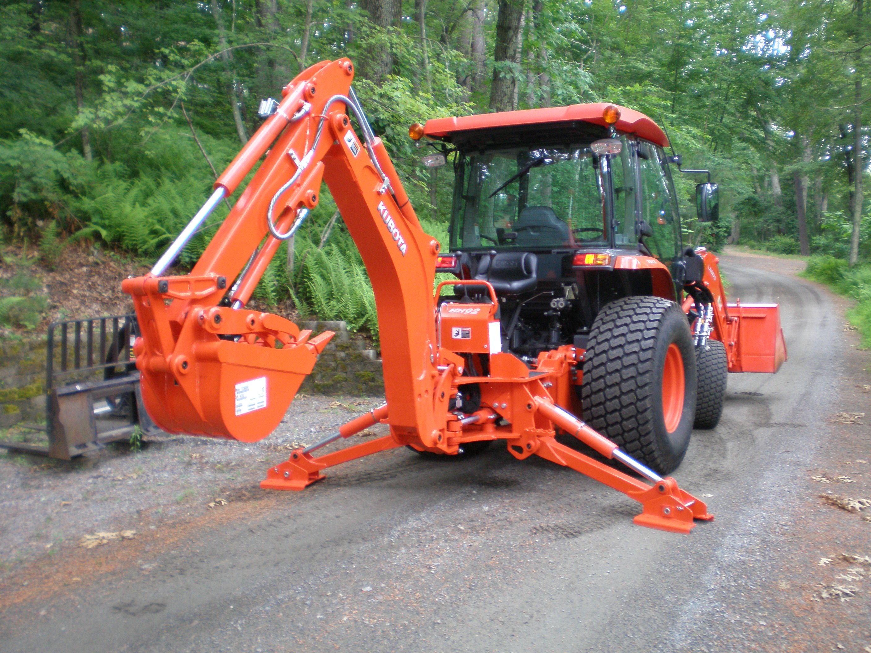

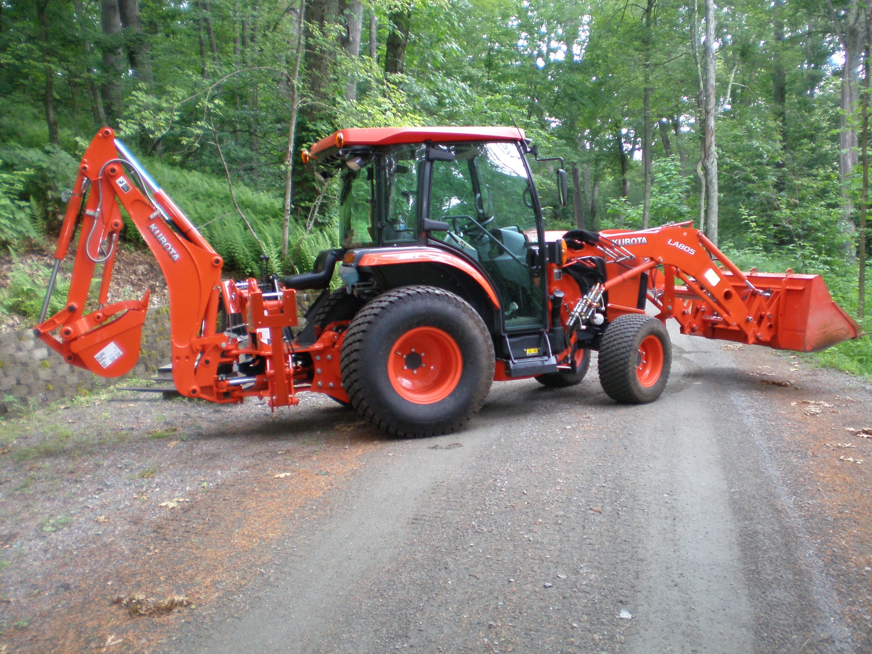

I went round and round like you last year. After seriously considering the WoodMax, I went with the Kubota with the sub-frame. Like you I don't have an everyday use for it, but it really has come in handy moving boulders with the hyd. thumb. It does take a little time to take off the 3-pt. hitch and put it back on, but I have it down to about 20 min. I know a lot of the pro tractor owners really shy away from the 3-pt. hitch backhoe, and after using my unit with the sub-frame, I can see why. A lot of stress is put on the tractor using a backhoe. I also looked at a real backhoe unit, but around here the cost was way to high and for the amount of use the attachment option was the way to go.P6280025.JPGP6280023.JPG
