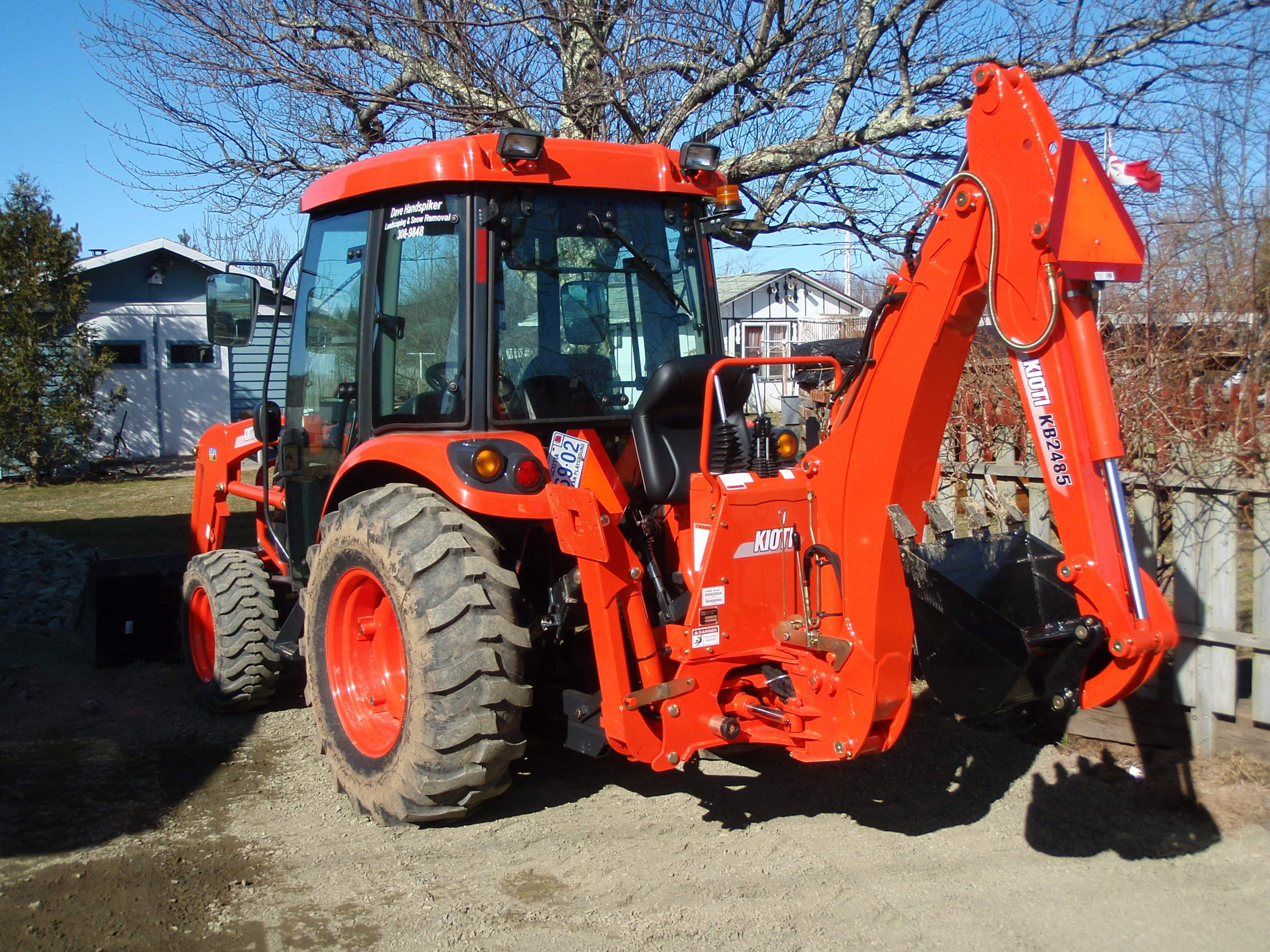

For comparison, I just had a KB2485 installed for $7500 + tax. This is on my DK40se with cab.

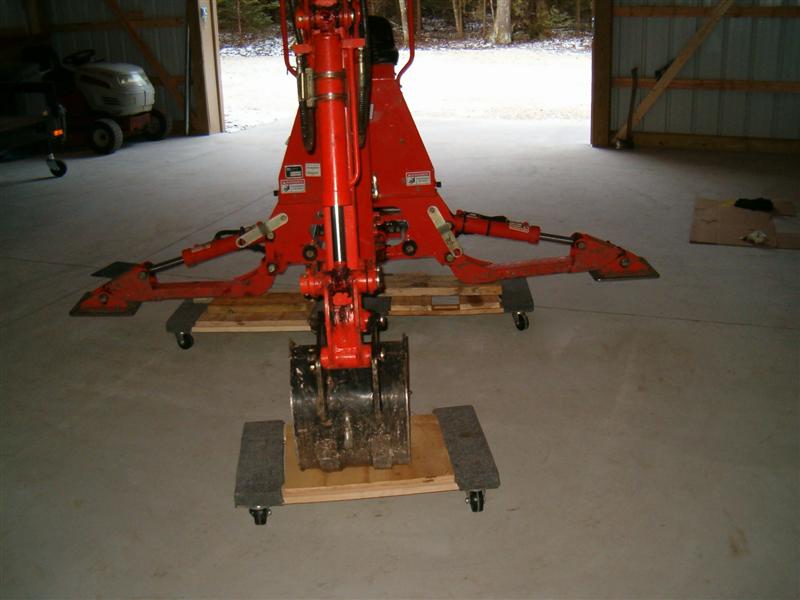

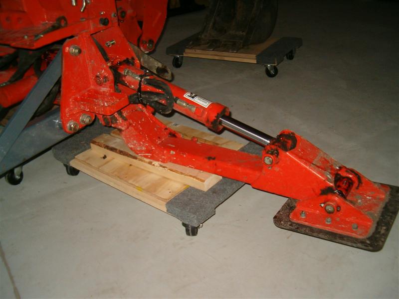

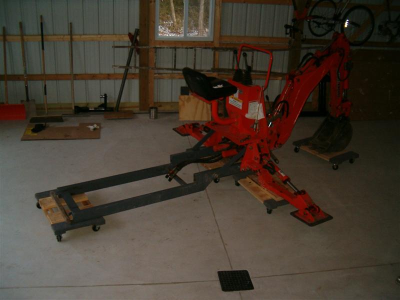

I don't know why more folks don't store their backhoes on furniture dollies. If you are fortunate enough to have a concrete floor beneath your stored subframe backhoe it might be a good consideration.
It makes reattachment a breeze. Instead of trial and error back up approaches to re attach I am able to just roll the works beneath the tractor right in the appropriate location for repinning. It is also nice to be able to roll backhoe around in order to be able to access other stored items.
Maybe it won't work for everybody but it's a good thing for me. (Kioti KB2465)

Rimshot, I admire your ingenuity and am flat out jealous of your concrete pad. I keep my BH covered outside but despite blocking it I invariably spend 15-20 minutes jiggering to get things lined up. The Kioti BH would be easier than my Woods to line up so I would really benefit even more.

Thanks Island,
Some have told me they chain up the outriggers to keep them from drooping flat like my outriggers did in the photo. You will note mine have drooped down over the long Winter causing the backhoe to sprawl out taking up excess real estate. You will also notice the point of bearing is directly below the outrigger hinge pin. Sometimes I need to slip a block or two beneath the backhoe pad which transfers down force back to the pad where it is intended to be
To me, one of the most difficult things about remounting the backhoe is the fact that the backing of the tractor has to be perfectly parallel to the frame. With the furniture dollies those wheels bring the mountain to Muhammed. During the Summer months the dollies host my snowblower.
