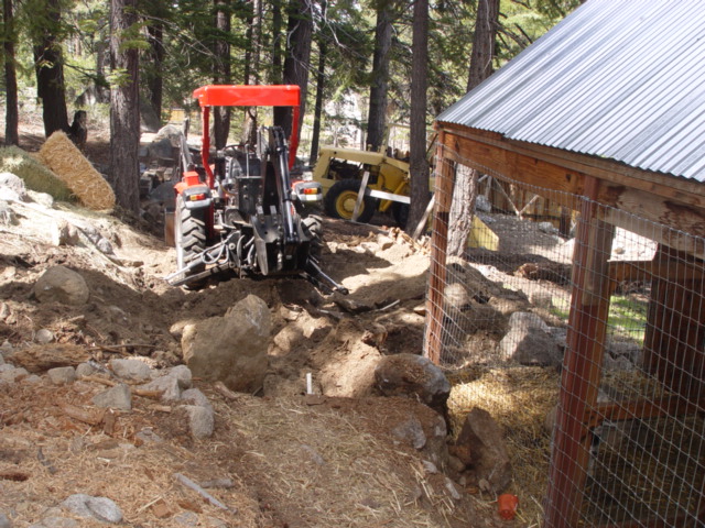

Here are some shots of the work.

Ron, All that pressure through the small hole in the banjo bolt may be some of the reason oil wants to come out the fill hole. Richard

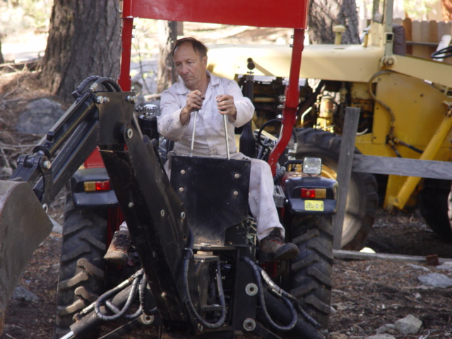

here is a shot showing that the tank is above the footrests. I'll put up with that. I think the next thing I do would be to arrange for less pressure on the return line. Richard I just looked at the picture, it doesn't show the tank.
/ Backhoe first time!
#40
I think you can see it in this shot. Richard
