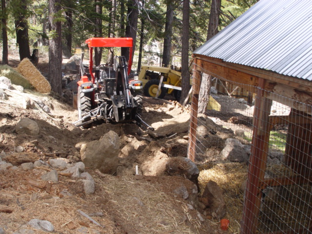

Backhoe Backhoe first time!
/ Backhoe first time! #1
valley
Platinum Member
Jan 3, 2008
867
mountain valley near Tahoe
Michigan 55A, Foton 254
"And in manor of fashion I frown, when I first stuck the teeth in the ground. I was both sad and shy as I felt every eye" Sung to the tune of my sweet little Alice Blue Gown.

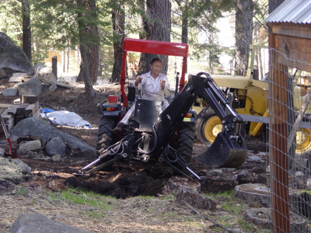

#2
This feels like the first time you back up a semi. Everything going in the wrong direction.
There are some really big *** rocks here. I think I'll have to move them with the Michigan or dig a hole and bury them.

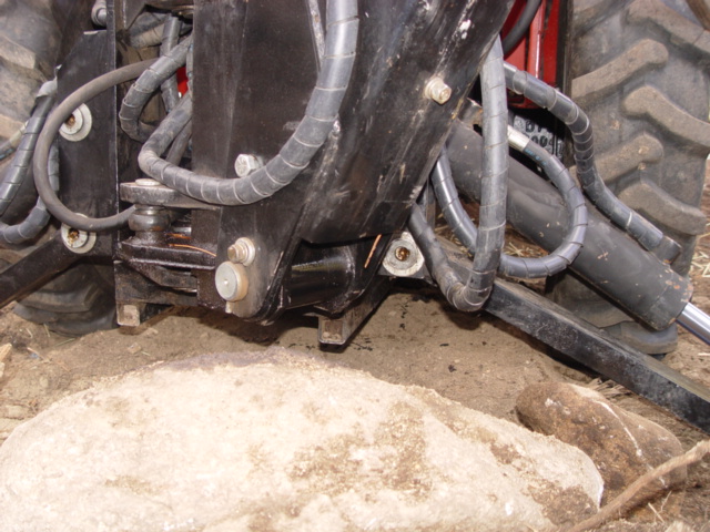

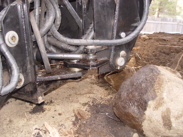

dfkrug, The backhoe is a: JW03. Working OK! but I just blew a hose. The hydraulic fluid is coming out the bottom took a glance couldn't see it. It is up in side. I'm going to start a thread maybe I can find some one who has replaced that hose. Hope its a hose. Here are a couple shots to show where the fluid is coming from.
The fluid is coming out of the bottom of the moving arm. In the book they also call it a:Backhoe boom Assembly. I wonder if I hold the bucket arm up with a ,come a long to a beam,if I can work it on the tractor. I saw it had a small leak when I started, its not small now. Richard
/ Backhoe first time! #11
Richard
You might not have blown a hose, you might just have a loose fitting. I have the same hoe as you do. These hoes use an "O" ring face seal on the hose ends. One might have worked loose. There are 3 cylinder circuits in the boom. The first is the boom cylinder, the second is the Dipper and the third is the bucket curl. IF the fluid is leaking out of the base of the boom arm, I would guess it is probably from the bucket curl lines. These start at the valve as hoses and run up into the base of the boom. Here the hoses have fittings that connect to hard metal pipes. Up near the top of the boom arm section, the pipes connect back to hoses to pass over the boom-dipper arm pivot. One of these 4 fittings may have come loose. Unfortunatly they are not all that easy to get to. The upper two fittings are not all that bad, but if the bottom two are loose, you may have to stretch the boom all the way out and lay it down on something solid, then remove the boom cylinder fittings and the end pins and lift the boom cylinder up out of the way to get to the bottom bucket curl fittings:(
The main boom cylinder is the most stressed in the system, lifting all the boom weight and whatever you have put in the bucket. It is also doing this in it's retract mode, which has less available force than in it's extension mode. The pressure doing this heavy work is exposed to the rod seal, and this seal could be failing and allowing fluid to pass along the rod when you lift the boom. This would also leak fluid where you have indicated.
Get in there with a rag and wipe things clean, then fire the unit up and look for fresh fluid. Be sure you wear eye protection. Hydraulic fluid has a nasty habit of squirting places you don't want, when you least expect it. Make sure all the weight is off the parts and all the valve controls have been cycled to relieve pressure before you go to remove any fittings.
Good luck
#12
Ron, I just looked at the backhoe, what you described sounds right. I'll bring it around tomorrow and lay it down by the shop. Can't see anything from the outside must be under everything. Thanks for the help I was hoping for someone who has had to get in there to come on. I'll post what I find. Richard
/ Backhoe first time! #13
I also blew a hose leaked in the same place. The hose was rubbing on part of the frame{rough spot}. I replaced the hose and ground off the rough spot. I have also had the swing arms start to losen so watch them.
I did alot of work with the jw3 but if I had to purchase again I'd run like the wind in the other direction from that BH.
#15
Ron, You were right, it was a loose fitting where the hose joined to the metal tube on the lower end. The cylinder for bucket curl. Not very easy to get at but I was able to tighten it. Thanks! Richard
