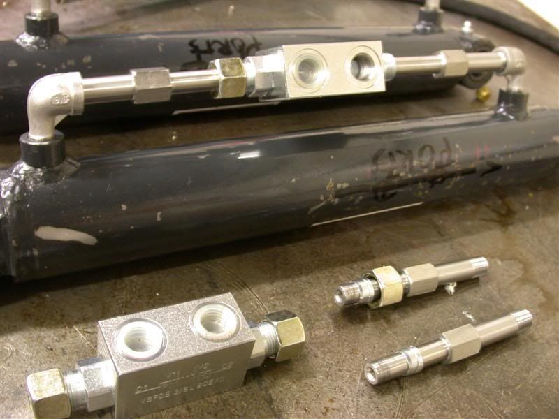

I mounted them the way they are in the photos above, parallel to the leg so they don't flip over when the hoe wants to drag the tractor. But that is putting more stress on the welds in that direction. I hope they hold up and I think they will.

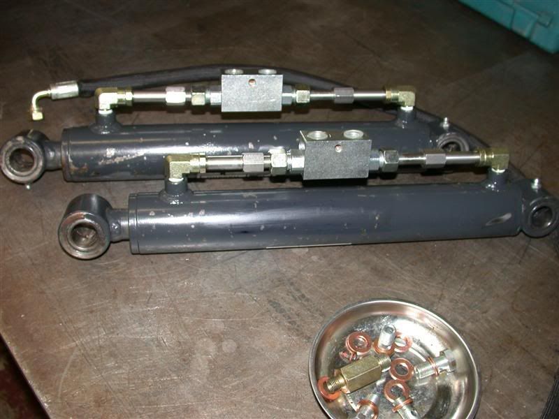

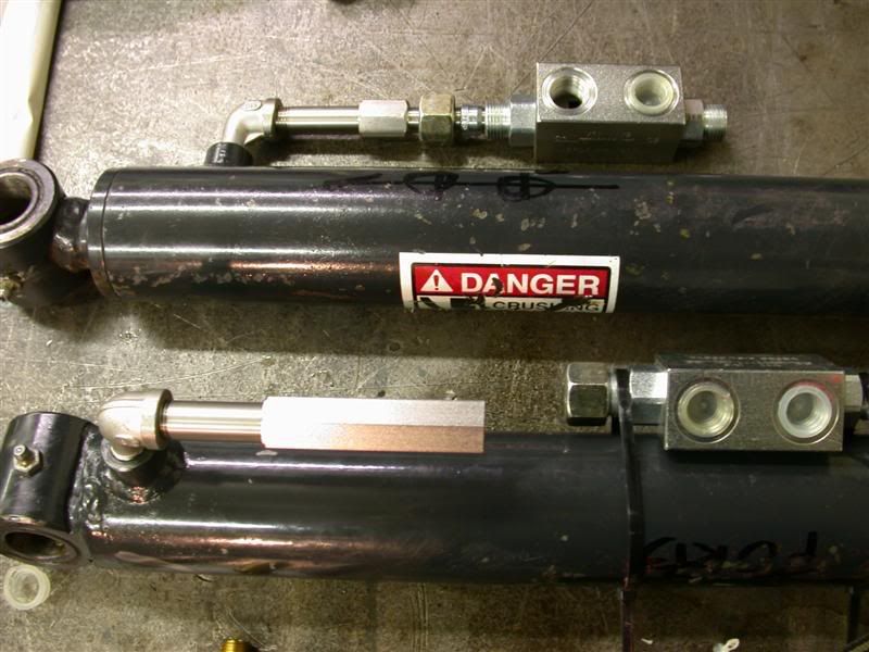

Well, no huge boulders but I tried digging the footing for my water tank concrete pad. The decomposed granite was hard as a rock and I did very little damage to it. I managed to scoot the hoe and tractor around plenty trying to penetrate it though. No damage to the red pumps at all. Best thing was the legs did not leak down at all either. Before adding the check valves, I bet I hit them every 5 minutes or so to reset.
