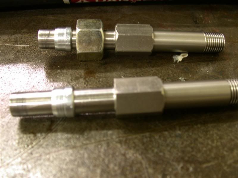

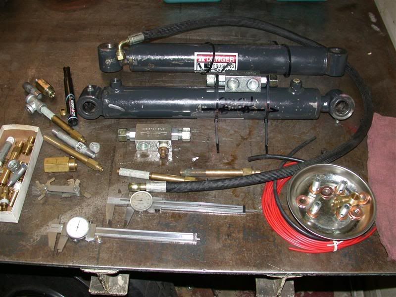

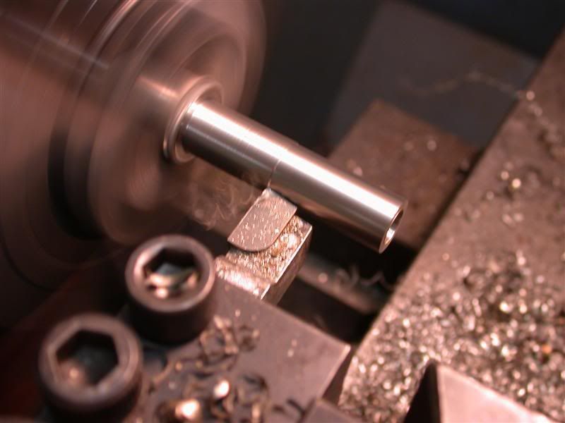

The general idea is to have enough tube inside the DOPCV on each end so it fits in between the 90° elbows. So when I screw in the NPT thread, there is still tube inside the collar where the compression ring can seal off.
Here are the cylinders, one with the unfinished tube (bottom) and one with the finished tube (top).
So this is the basic idea to hard plumb the CPOCV onto the cylinders.
I am still waiting for the fittings I ordered from Discount hydraulics. These 90° elbows are just to show you the basic idea.

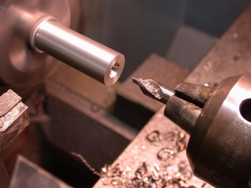

Guess what?
I dropped one of those tiny metric compression rings and can't find it now. What a bummer. I'll have to make one of those too! Just what I needed.

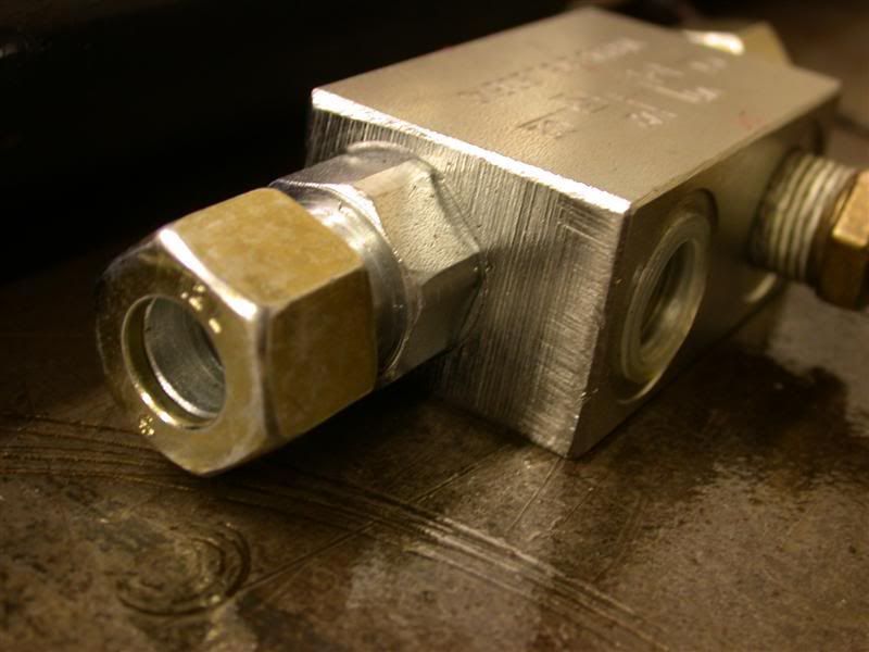

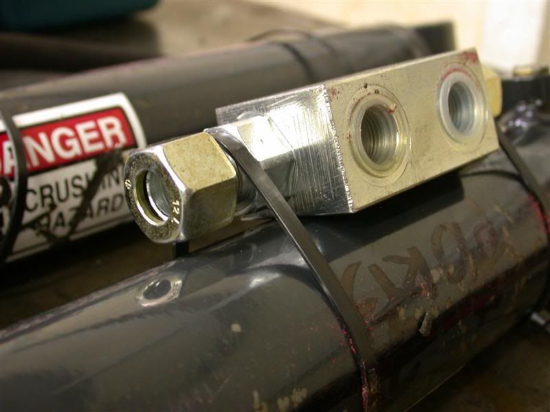

I found that compression bushing while sweeping up, under my lathe! Now I am jazzed.:) I was able to put the hard plumbing for the double pilot operated check valve addition together finally. I must say it came out excellent! Even if I say so myself.
I measured the distance between the elbows on each cylinder (they were different by .100") so I could cut the 303SS tubes to length. They need to slip between the elbows while set deeply into the DPOCV's. Then I bought some pipe seal hex nuts and put them over the NPT threads of the SS tube. I did this as a safety measure so I can get a positive seal, but mostly because I did not want to screw them into the elbows too far. Otherwise the compression end might come out of the DPOCV. I measured how much I could slip them out and still have enough to make a good compression seal. Then screwed them into the elbows while measuring to maintain that safety margin. Fortunately, there was enough travel to screw them in almost completely tight anyway. Then tightened up the elbow ends with the seal nuts.
Last, I had to center the DPOCV on each cylinder so that the compression ends were of equal engagement and tightened that end up. Now the hard lines with DPOCV are complete. Aren't they beautiful now? I think it is a super clean bridge.

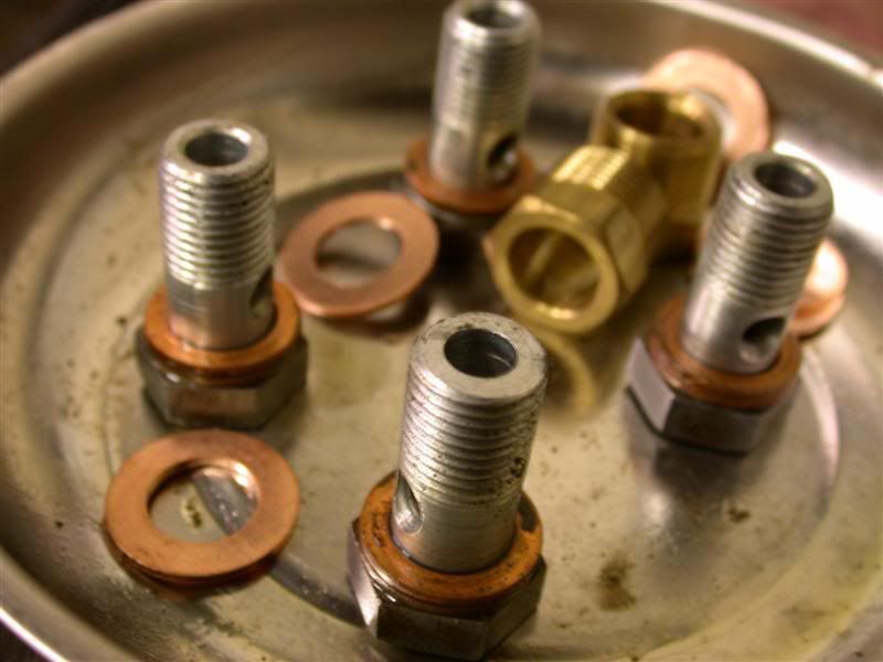

Now I can take them up to the property to install. But before hooking the hydraulics up, I am still waiting for a fitting from Discount Hydraulics. That is the reducer sleeve which goes into the 3/8 port of the DPOCV's. I bought 2 kinds. 3/8 NPT male to 1/4 BSS (British parallel pipe), and also 3/8 BSP male (taper) to 1/4 BSS (straight).
Obviously, I found out that the banjo bolt is British 1/4 parallel pipe thread, but I'm not sure what the 3/8 pipe is on the DPOCV's other than I know it is tapered. Both British 1/4 and 3/8 pipe have 19 threads per inch and American has 18 tpi. When I get them, I will install them at camp and reconnect the hydraulics, along with the feet and try her out again.
I will tell you what difference the DPOCV's make on the stabilizers after trying them out. I'm hoping they will work a lot better than the fast bleed down I had before. In other words, I'm hoping the bleed down is because of the valve and not through the cylinders themselves. This modification will tell me for sure.

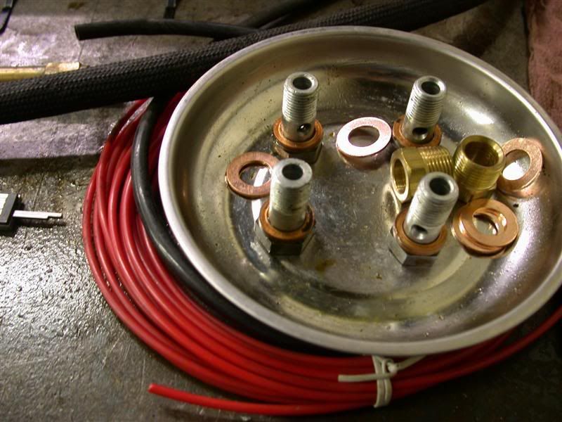

I finally got the fittings I've been waiting for. It only took Discount Hydraulics two weeks to send them next day air.
The one on the left is a 3/8 BSPT British Pipe Taper (male) to 3/8 BSPP British Pipe parallel (female).
The one on the right is 3/8 NPT (male) to 3/8 BSPP (female).
Which ones do you like better? Which one would win in a fight do you think?
The difference between the BSPT and NPT is not just a few thousands in diameter, but more so one thread per inch. Now that I got them, they will go up to camp with me this weekend to see which fits. Then I can start working the backhoe again and check out the new red shoes too. Not only will they be taller and offer more stability for Huge Kama, but the backhoe legs should not leak down anymore.

I got the fittings installed and re-connected the hydraulic lines. Then mounted the hoe to the tractor for a tryout.
Here are some photos of how the DPOCV mounting worked out.
The hoses fit perfectly and did not get squished.
I zip tied them together to keep them in position, but when screwed in and fastened, the hoses didn't move anyway.
The fittings turned out to be 3/8 BSPT that go into the check valves, not 3/8 NPT. They sealed perfectly and so did the BSPP (parallel) threads for the banjo bolts. They did not leak a drop.
