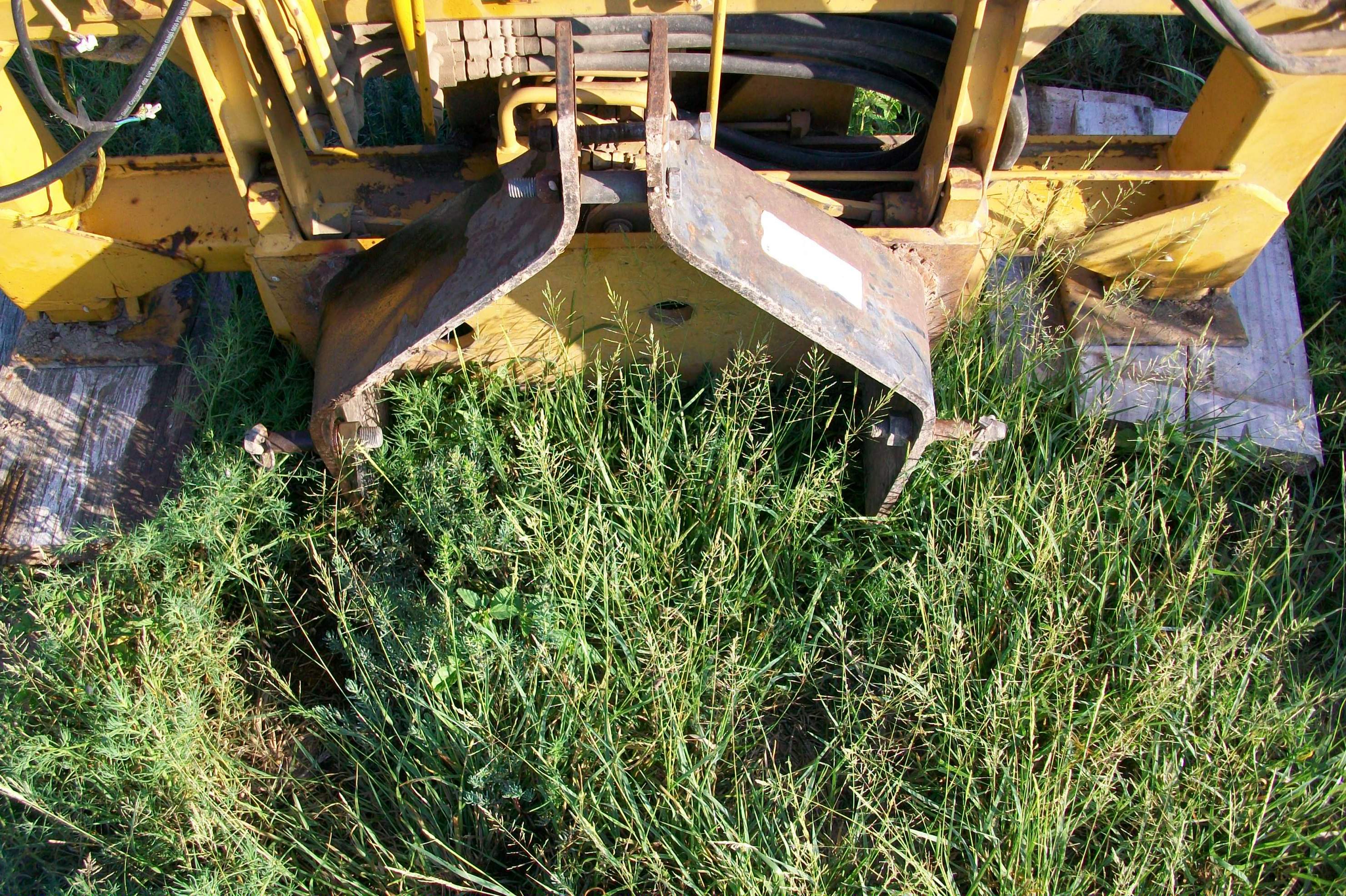

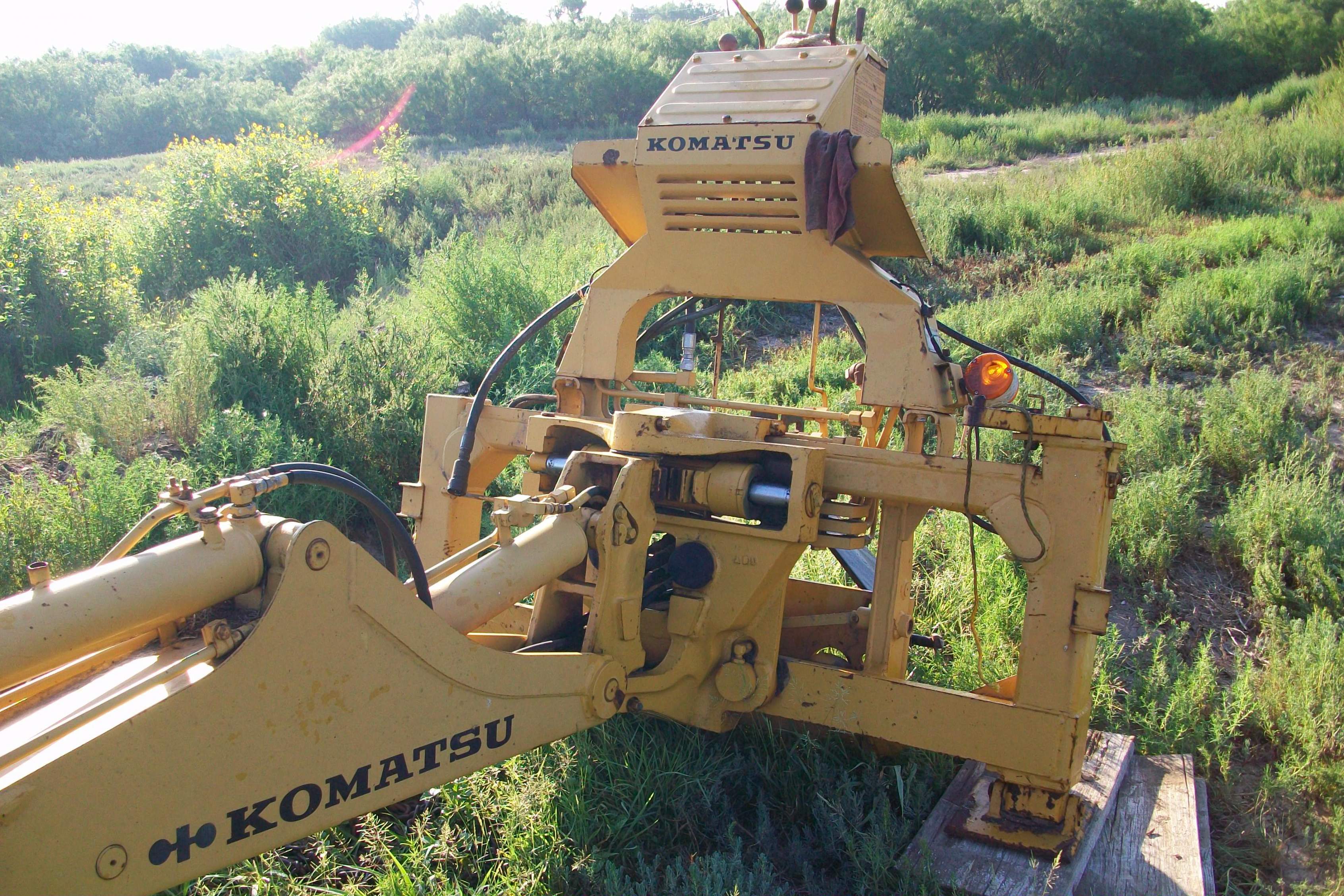

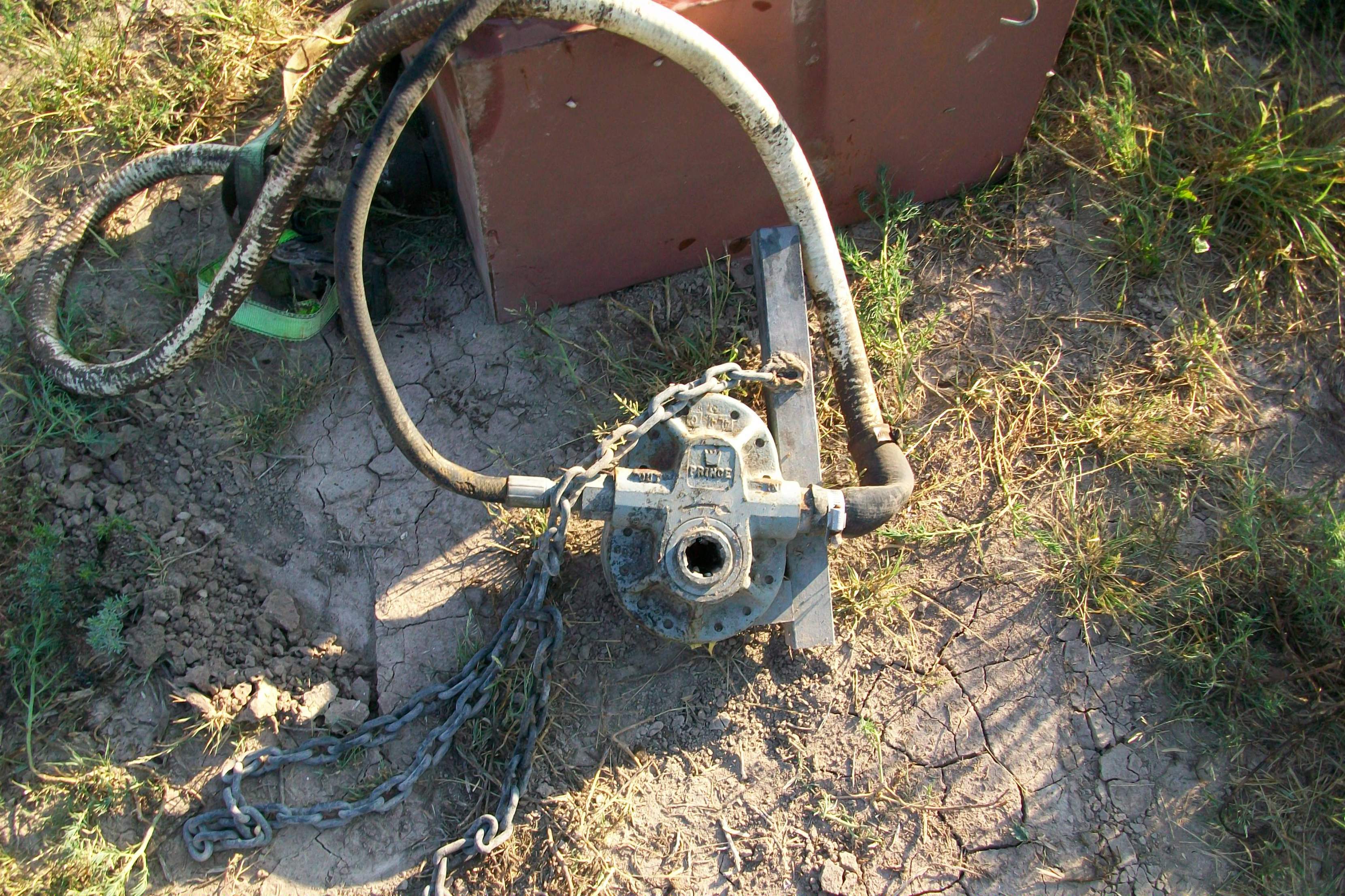

I've been looking for a backhoe for my Kubota 5040 (50 hp tractor). Finding used hoes is almost impossible but I've located one that I'm mulling. Hoe came off a Komatsu skid steer I believe. A 3 pt mount was welded to the mounting bracket an external pump/reservoir was added. I can get this setup for what I think is a good price $2000-2500. Some work does need to be finalized however such as incorporating the pump / reservoir in a more permanent setup and making a seat assembly. Any suggestions? I attached some pics. :(

From everything I have read on here about BH's it has two strikes against it. 3pt hoes can damage your tractor, you would be better off building a subframe and a way to attach it to your subframe. Those straight down feet have little clearance and can be a big pain when moving over uneven ground.

Usually, most Backhoes when sold on a tractor unit, have the subframe units. Units sold individually generally have the rigid 3 pt system and no top link is ever used. That looks like a bad accident ready to happen. When you go and start adding the costs for sub frame work where will you be?
Just my 2 cents, but I would give that a lot of thought before braking your unit in half. I've seen it done.

I would not do it. Don't like the stabilizers, where are you going to mount the tank?, What is the swing on it?, from the pics not sure how that would work. My opinion is you would be better off waiting for a more user friendly unit, I sold a 3PT back hoe last year for $2500 that was a "turn key" unit. Better deals out there unless you are dying for a project.;)

Are you planning on using the PTO pump or are you going to use the tractor hyd. I would use the tractor hyd. if possible. How wide are the out riggers? Will they be wider than your rear tires and how far down will thet extend. I went through this when I was looking for a hoe and found several setups like you are looking at and finally decided to wait and find exactly what I wanted.It saved a lot of headaches. If you look closely at the pics McGeesEquip posted the TPH mount is very rigid yet adjustable so you can have the hoe mounted at the proper angle. Also check your seat clearance.

I went and looked at the hoe today and it was just as advertised. Basically a brand new hoe that has been sitting a couple of years. All cylinders function as they should with no leakage and they were stored retracted so no rust or pitting at all. The hoe was not as big as it appeared in the pics. I measured total reach and it looks to be less than a Bradco 509 but similar to a Rhino 85. This is not the biggest hoe my 50 hp tractor could handle but with the skid steer mount extra weight it probably is a good thing it is a smaller hoe. The unit came with a separate PTO pump and reservoir but these are loose and will need to be incorporated into the unit in a permanent manner. Also no rigid 3 pt mounting or subframe so I'll need to remedy that. I gave $2,675 for the hoe which gives me some room to get it right and still have a nice hoe at a good total investment.
I would appreciate any additional thoughts on how to design a rigid 3 pt mount or some clever ideas to make a removable sub frame that wouldn't require pulling the 3 pt arms. I'm normally using a big tiller so the thought of pulling the arms isn't good. The tractor also has hydraulic cylinders on the top link and one of the arms so I really want to come up with a way to not disturb the 3 pt mounts. Please share any thoughts or pictures of your modifications in this regard. It really feels good to be in the hoe club.....:)

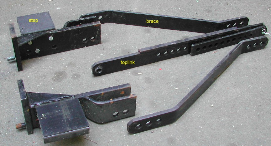

I have attached a picture of a Great Bend backhoe, and you will notice there is a long bar coming from the center. That is used instead of the top link. Once it is adjusted to fit your tractor, then the backhoe will not go up and down and it will cause the backhoe to be locked in position and the 3 Point lift can not go up and down.
Pretty much all of the 3rd party backhoe attachments that offer 3-pt
hookups do it that way. They provide what I call an "enhanced" toplink
to use instead of the standard cat 1 toplink one gets with their tractor.
The enhanced toplink is rigidly braced in the middle. Using a hoe
on the regular 3-pt hitch is dangerous as pushing down with the boom can
lift the hoe on the hitch and pinch the operator.
Here is a photo of the toplink and brace that you get with a Woods hoe.
I am no fan of using the proper 3-pt hitch setup (even with brace) over
a properly designed subframe.
The 5040 has plenty of room in the rear to install a subframe that
encircles the axle housings. Look at the "4-point" subframes from Kubota
(for the BH90), and Woods for ideas. It is easy to avoid the lower
3-pt arm pivots, as any good subframe design should, IMO. You can see
the Woods subframe in their installation manual on the Woods website.
More here:
http://www.tractorbynet.com/forums/build-yourself/171760-how-build-your-own-custom.html
