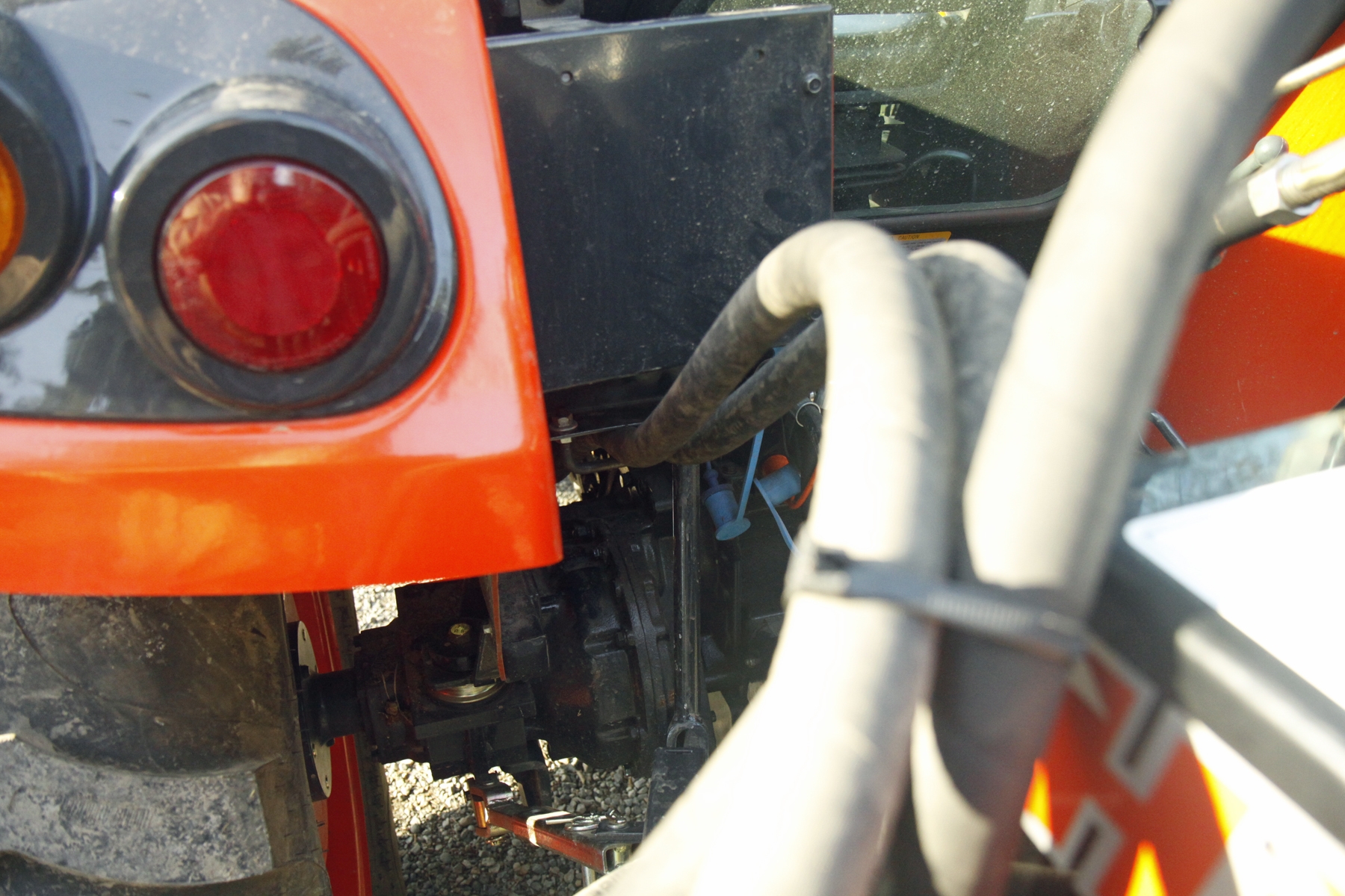

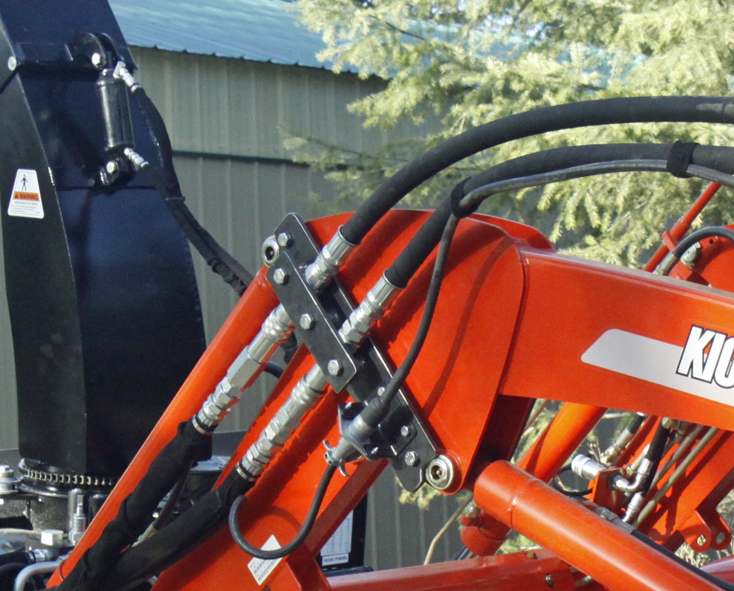

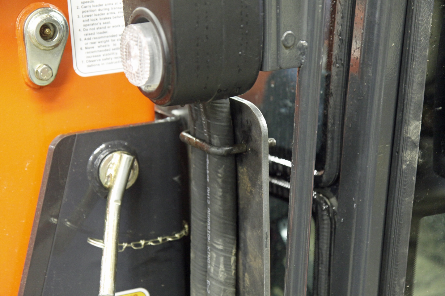

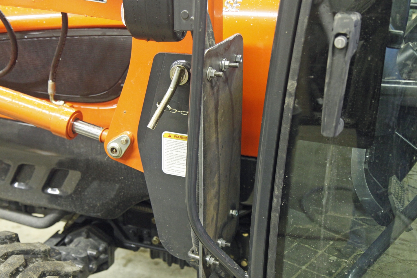

I had to make some connection plates on my tractor to pipe lines to front. they run under cab, up loader post and out to the connector. all custom made as no one sells these.
