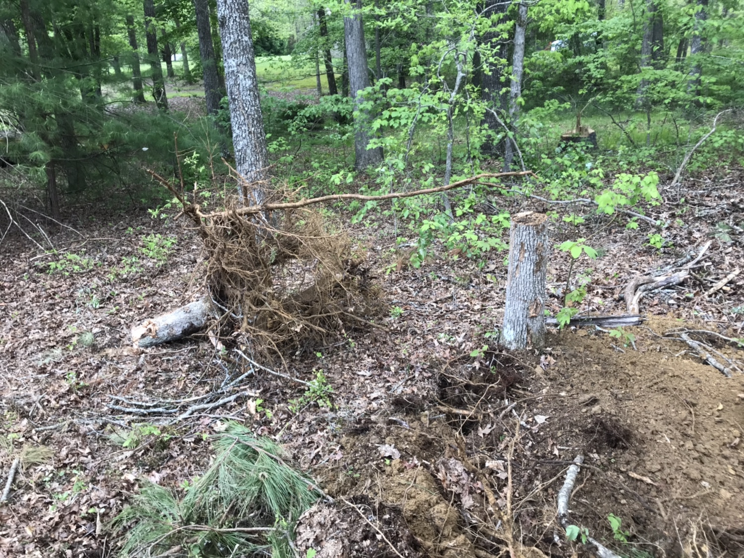

I have a SCUT with a BH and have taken out a 30" ash stump using the BH to dig out and a sawzall to cut roots. This took days and I could not get anything larger in as this was close to my pool fence line.
For 8" and smaller, I can pop a stump every 2-3 hours.
I would still say for a lot of 12" Ash , a good stump grinder or drill and rot would be my choice. Spending a whole day or more per stump would mean a lot of other stuff wont get done.
