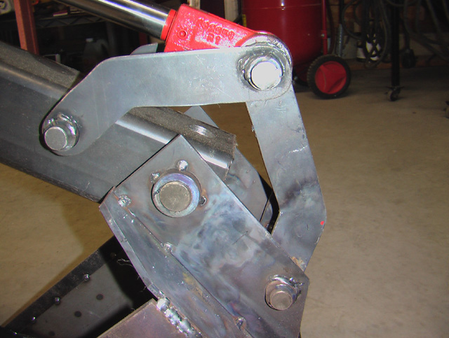

I am concerned about your main boom joint and believe that you should sandwich some steel plates on either side
Dave
I agree that there will be quite a bit of stress at that location and I will be welding plate on each side of that joint once I determine the attaching point of another cylinder. Thanks for your input, I appreciate and welcome all suggestions.

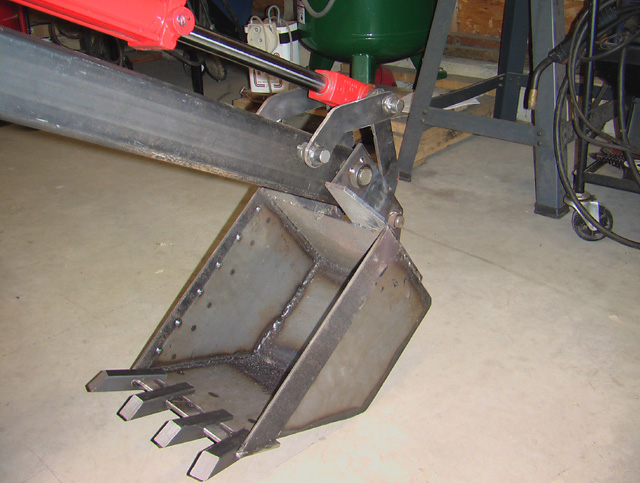

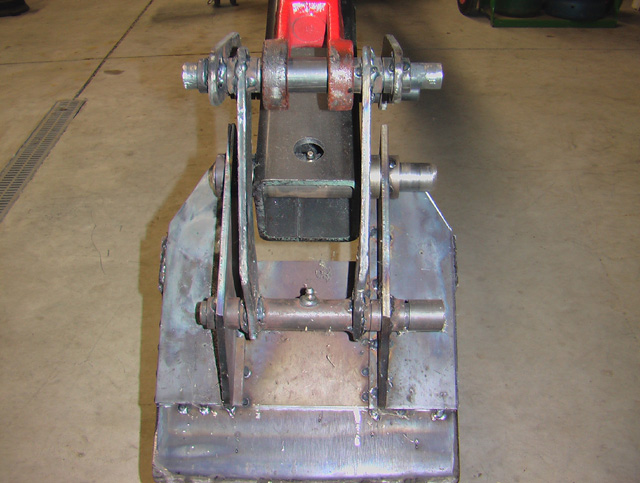

closeups of the bucket attachment would be nice.
Dave
Here are a few photos. Hope they help. Most welds are just tacked and the discolored metal is the result of "tweeking" with the torch. Thank goodness for paint, it covers a multitude of errors!:)

Thanks Jim. The idea for the teeth wasn't mine, it was suggested on the plans. Used 1" bar stock. I drilled a hole then cut out with my band saw. Will try hardening by heating up then quinching.

I will have to shape those boomerang pieces at the wrist cylinder to bucket with a grinder (no torches).
Dave
Actually, I cut them with a bandsaw then did a little grinding. I have since bought a plasma cutter that would have been handy in the beginning.

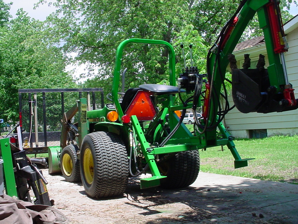

Have any pictures of your Caddigger?

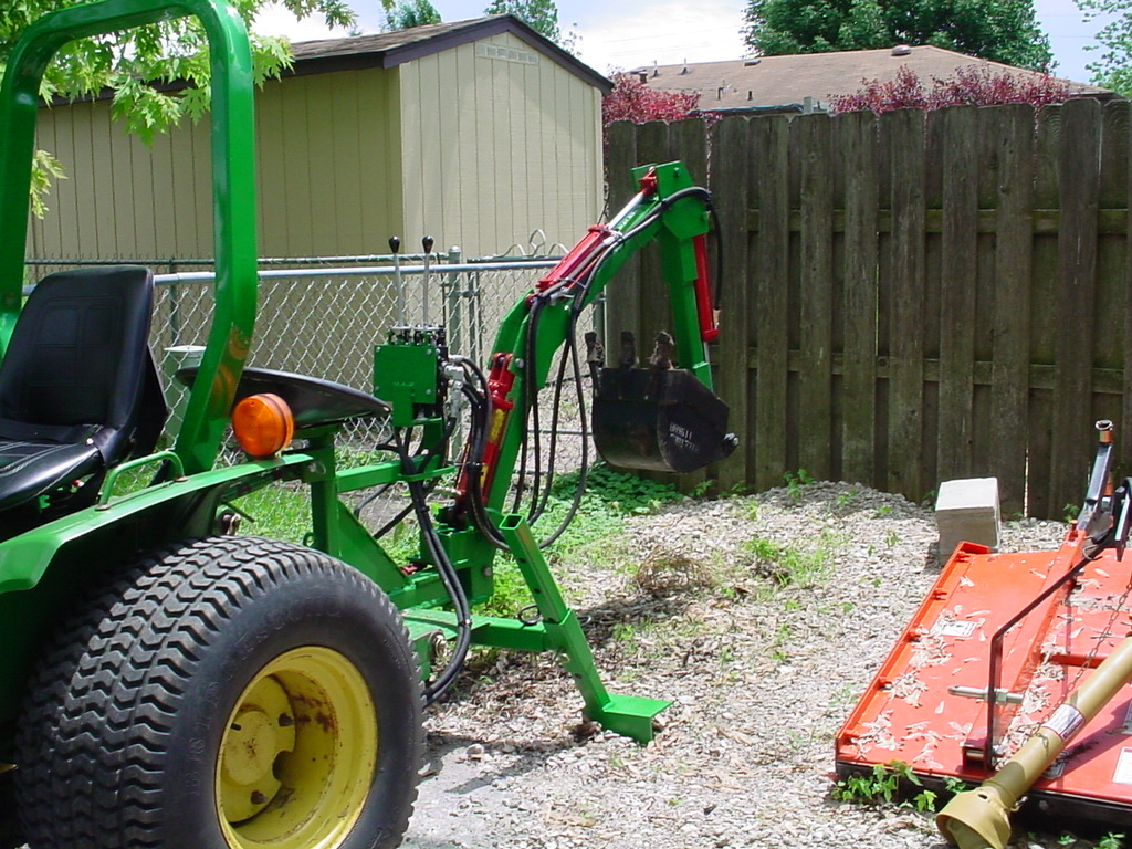

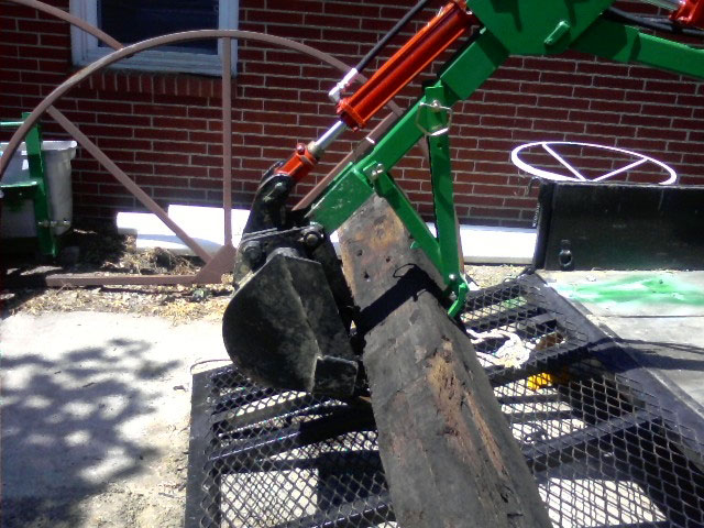

I will post some if I can. My son borrowed the tractor for 3 weeks to do some digging for his construction job before I took down to the lake property. I dug in a sewer line and then did some landscaping. Increased the size of the boom cylinder from 2.5 to 3.0 inches and made a thumb to be able to move those good heavy RR ties.
Oh the bucket is a Ebay find, brand new Bushhog 13" wide, $278 to my door!!
I also covered the hoses with protective material at the wear points.

Very nice work.

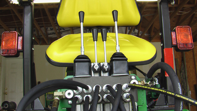

Who's joystick's did you use? I haven't bought mine yet. I like the combination of 2 joysticks and 2 levers however, 6 levers is fine also.
Thanks for the photos.
/ Backhoe Attachment Project #35
Very nice work.
Made my own. Ideas and drawings over on Machine Builders Net backhoe forum. I have a Husco valve, 4 spool, power beyond port, and pressure adjustments on all ports. Price was about $200 to my door from Surplus Center but with no handles. (They are now sold out of these valves)
So I made a mount bracket and handles and then found the Machine Builders Net joystick drawings.

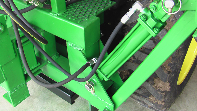

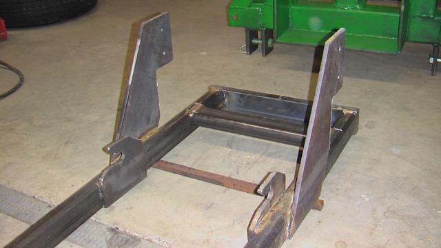

Just an update.
Changed my mind regarding the 3 point attachment. Well, not entirely, when finished, it will have the attachment points for 3 point hook up however a few months back I posted a thread asking if anyone could supply some dimensions for the 46 subframe.
Didn't get much response so I decided to go ahead a fab my own. Basically I found some installation instructions for the 46 and pretty much duplicated what they did. No point in re-inventing the wheel. The subframe is pretty much complete and bears a striking resemblance to JD's.
/ Backhoe Attachment Project #38
Pictures man!! :rolleyes: Pictures!! :eek:Show us what you are doing. :D
Mike

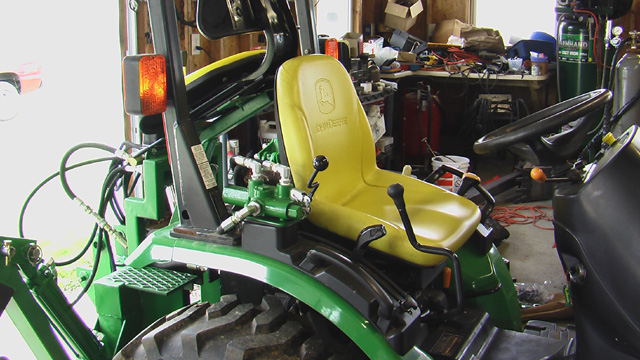

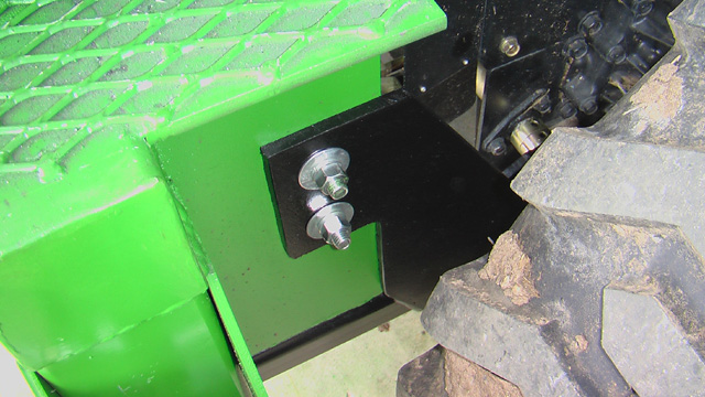

#39

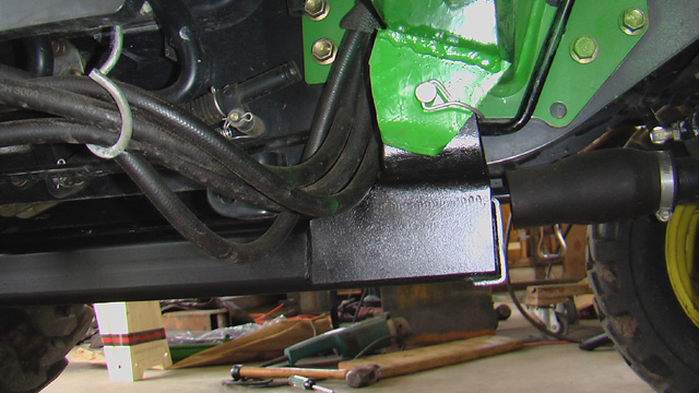

I posted from work and forgot I had no photos.
Anyway, went out early this am and shot a few in no particular order.
I replaced the original draft link pin with a longer one from a different tractor, added two spacers, I picked up from a local TSC store, to each side of the lower mount.
Again, I had no dimensions to work with so I just had to wing it so to speak. I have added a recessed area in the event I want to add a hydraulic tank and pump in the future. Right now I plan on using the tractors hydraulics.

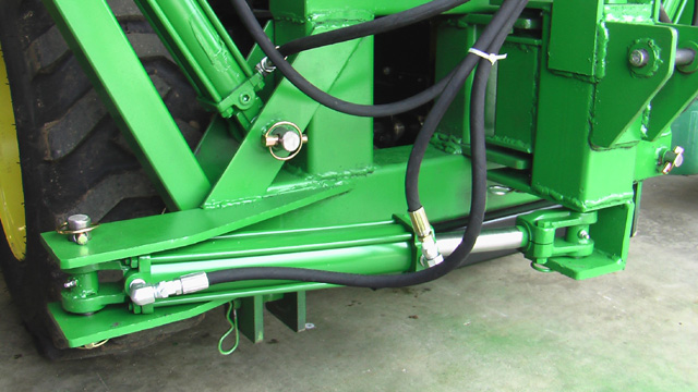

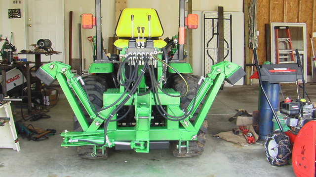

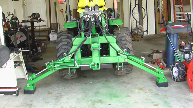

#40

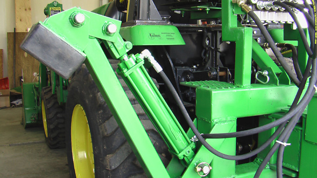

Today was the first time I connected the joystick to my home brew power beyond set up. The good news is the tractors hydraulics appear to provide more than enough pressure and flow to work more than one cylinder at a time. Best news, no leaks! With the stabilizers and slew pivot functioning now it's on to the boom, crowd arm and bucket. Fortunately, everything is pretty much fabricated, just need to cut out a couple support plates, weld on a cylinder bracket and run the hyd lines.
