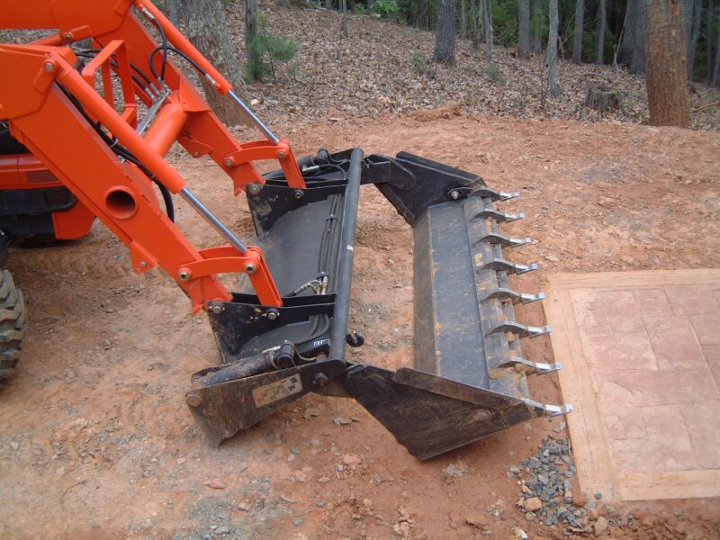

Not offering this as an 'expert' by any means. I'm still learing how to use this properly. But I just thought it fit the thread regarding use of bucket in different positions and how the 4n1 bucket can be used like a box blade.

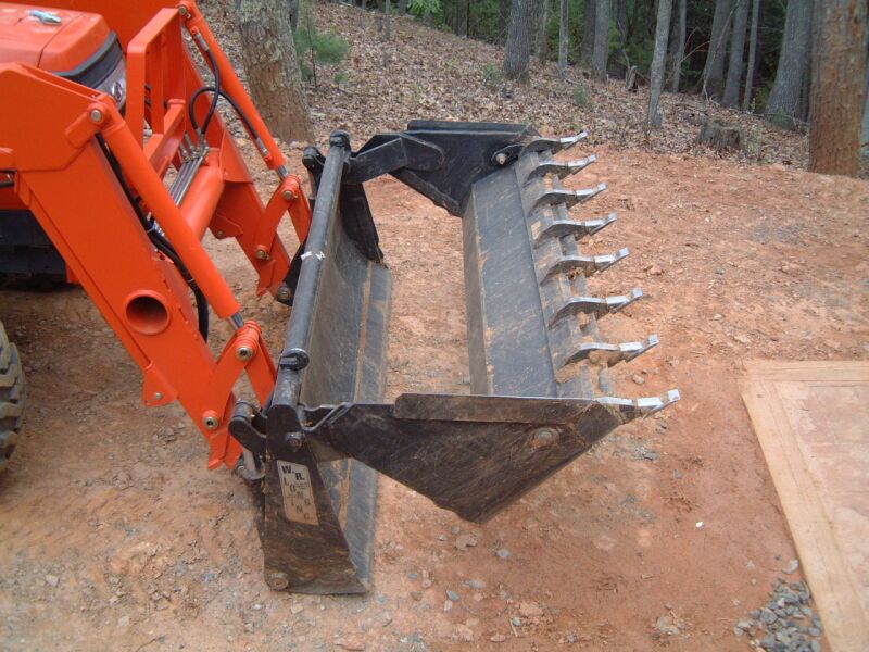

another view....push button on top of joystick....and this happens

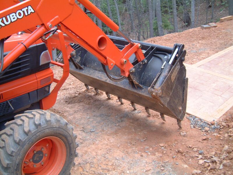

4n1 bucket in position for scraping, light grading, smoothing, keeping dirt clods broken up in fields, etc

yes, duckboy, it is. I am impressed with how well built it is too. Sure is heavy though compared to regular bucket. I'm not that good with it yet but i'm learning. One thing that's a minor drawback is that it's harder to see where your front edge and teeth are at times. I punctured a rear tire on my old tractor with the teeth....because i misjudged when i was swinging around it one day...ouch
