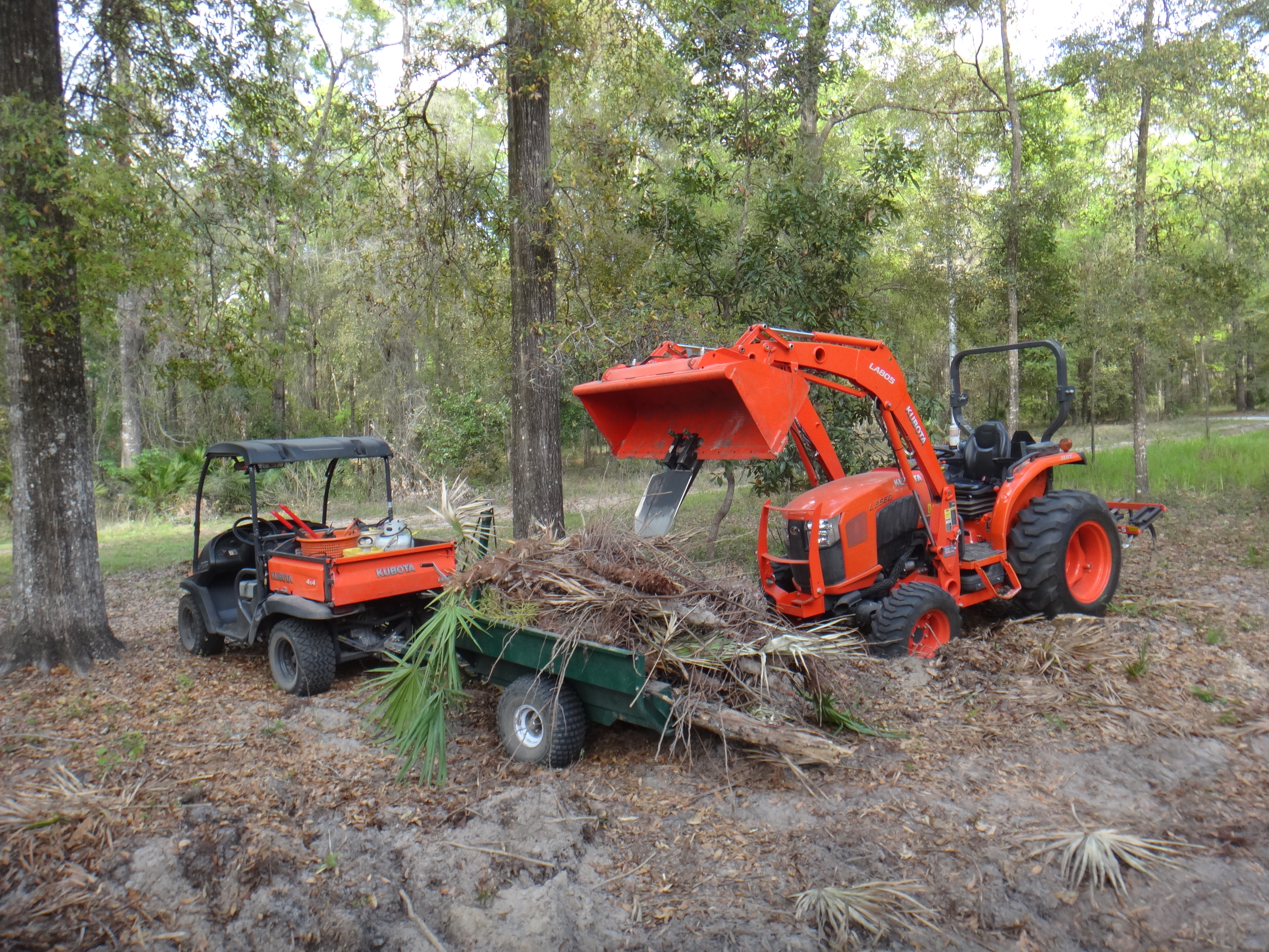

A Ratchet Rake is very efficient at collecting and piling debris of all sorts. This includes brush and stones.
As well as PTB consider a Bucket Spade for digging.
LINK: www.tractorbynet.com]BUCKET SOLUTIONS SPADE - Google Search[/url]
