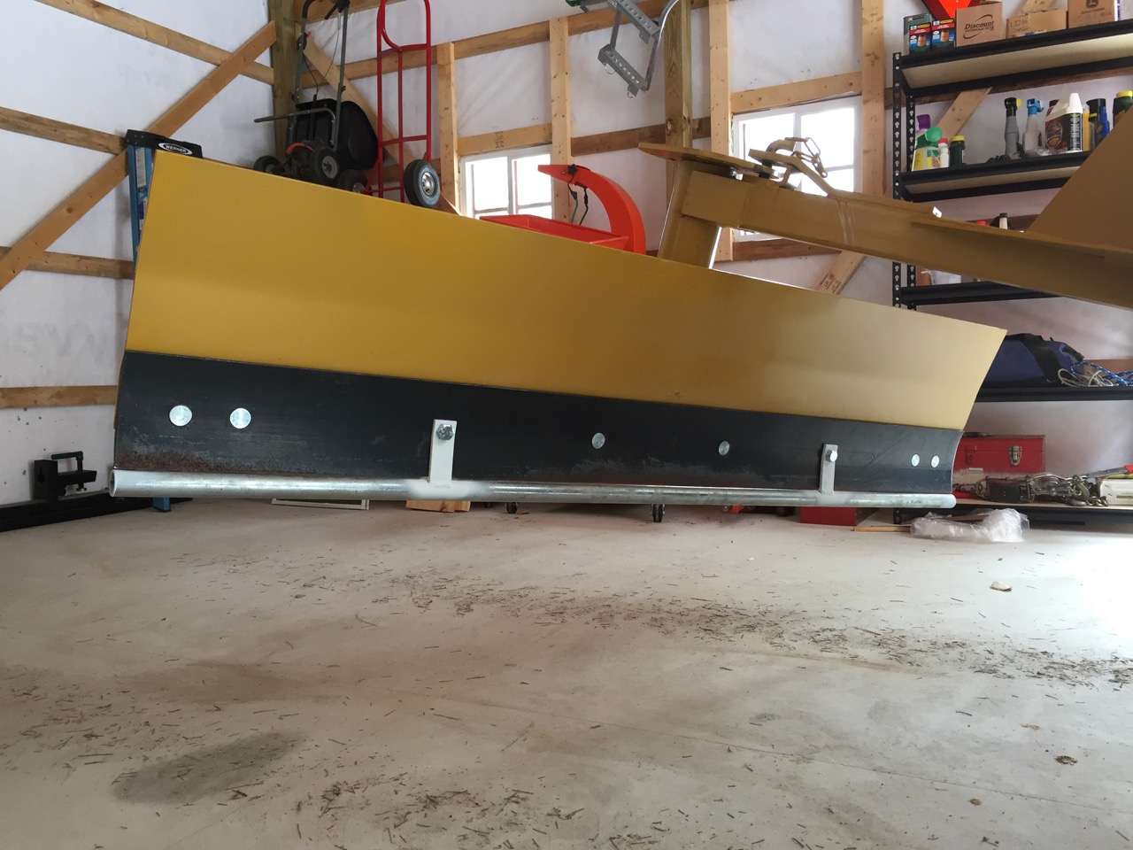

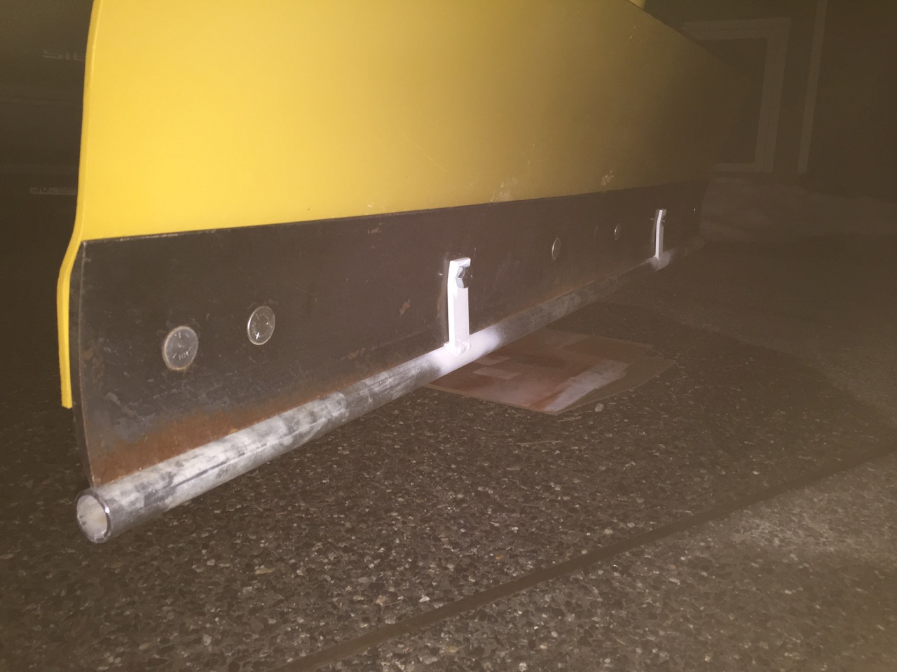

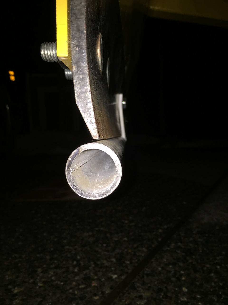

I壇 love to see a photo of the pipe on the cutting edge. I use the rubber horse stall mat between the cutting edge and moldboard trick. Works well but could dig a little deeper.
Looks funny after I plow. The rubber works like a squeegee to keep the cutting edge out of the gravel (1000 ft). Snow on the drive is as smooth as buttercream frosting!
You know I tried the horse stall mat and it worked OK, but I didn't like it as much as the pipe so I went back to that. I think both are good solutions though. I felt like the pipe scraped the snow better when very cold and disturbed the gravel less when warmer/wetter. Here's a pic of my setup -- I did it this way to make the pipe easily removable for summer use (although I haven't done anything but snow clearing with this rear blade in a couple years).
/ Back blade for snow removal #33
View attachment 539353 View attachment 539354 View attachment 539355
Thanks for posting the pics. I've been wondering how to attach a pipe, now I have a plan😁

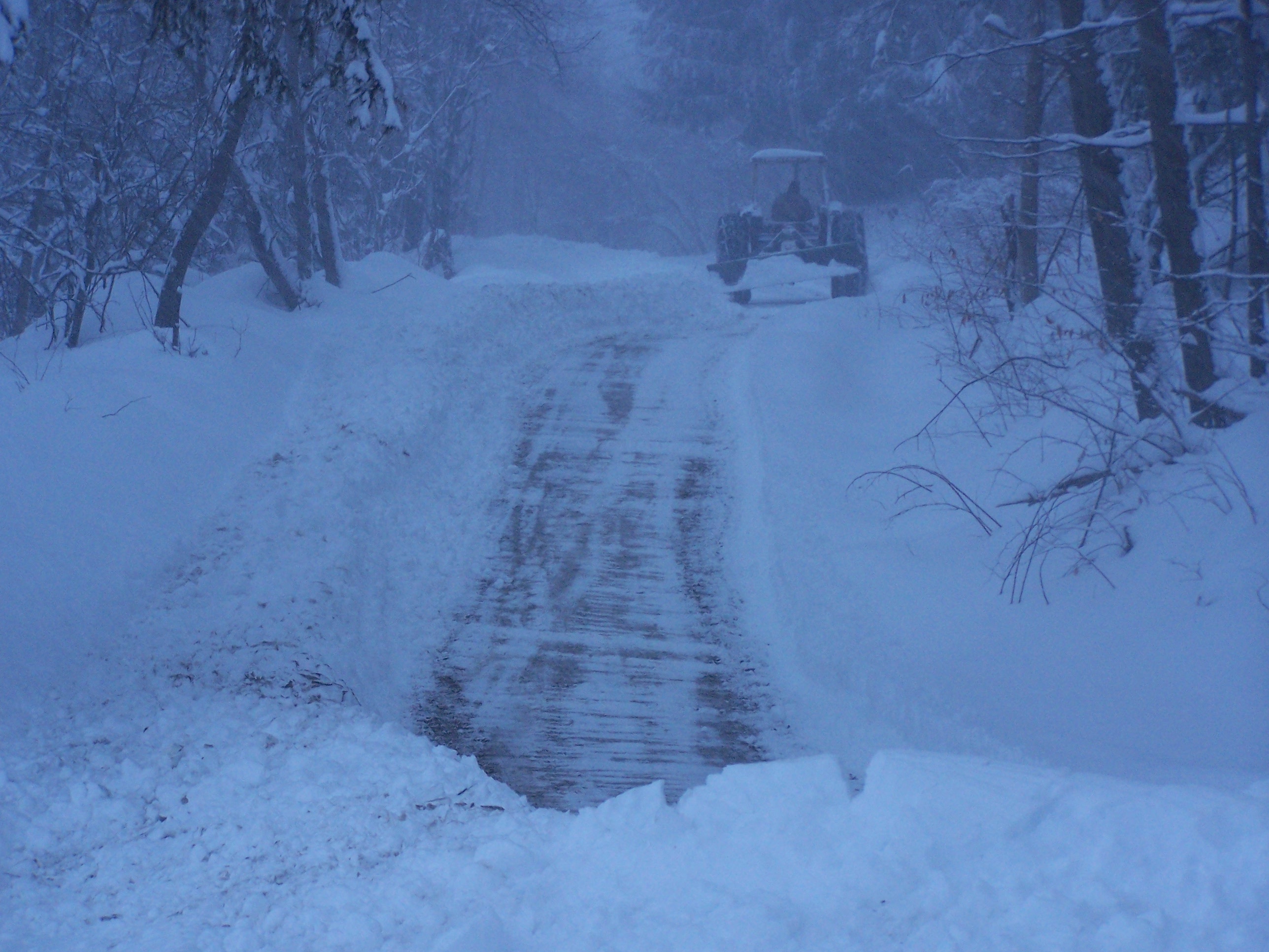

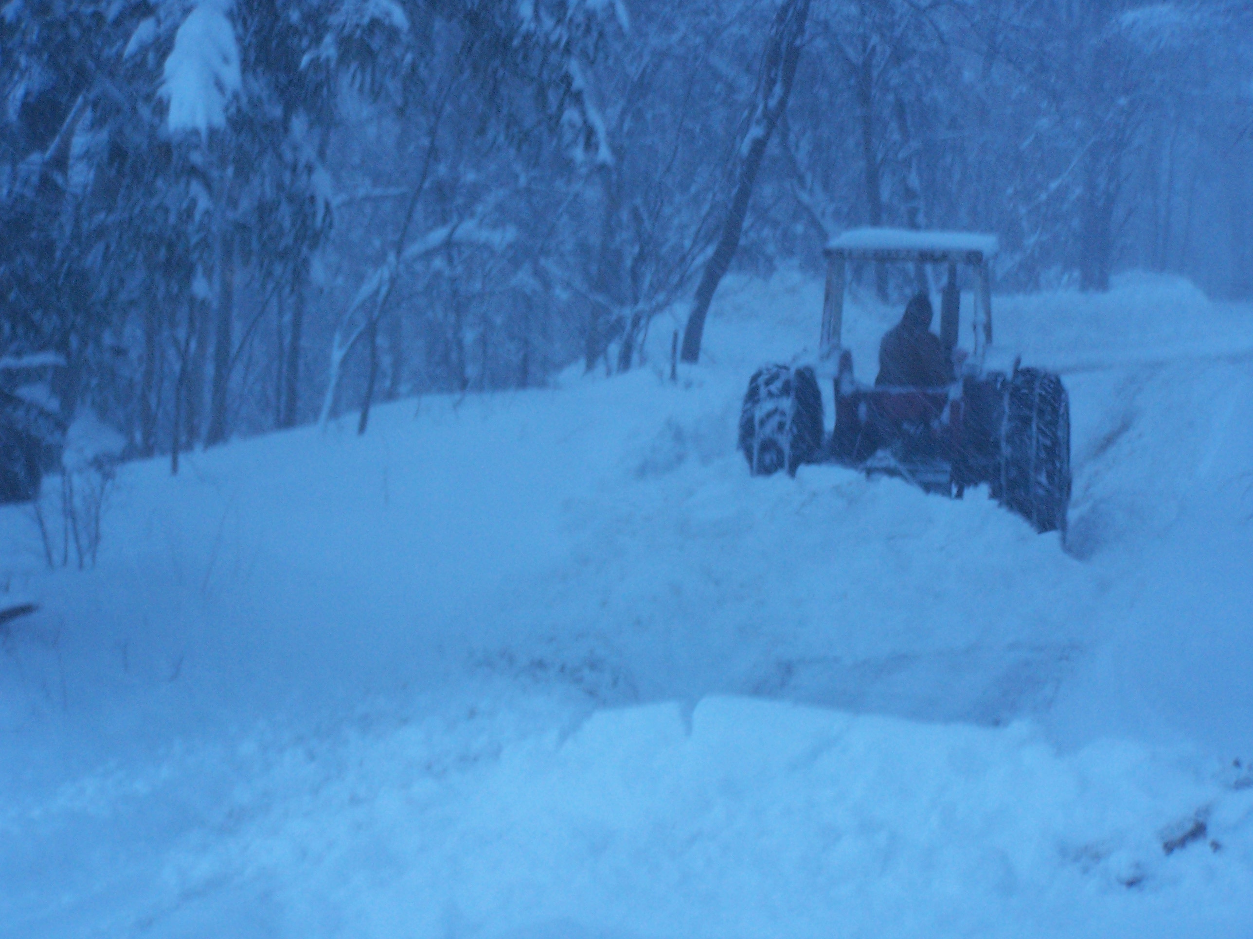

I used a back blade for a lot of years moving snow. I like the pipe idea for until a driveway gets froze, once mine got froze I'd scrape it as clean as I could. Parts of my driveway I would drive forward rolling the snow off to the side parts of it I'd spin the blade around and push it, some places sideways some straight back. These pictures are from several years ago.
you can move quite a bit of snow with a back blade.
