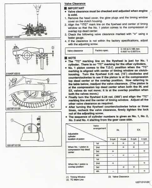

My true blue B7800 is due for a valve adjustment at 800 hours. Today it turned over 795 hours. I'm trying to decide if I should haul it to a dealer or buy the manual and do the valve adjustment myself. I have done all the other maintenance for the past 795 hours. I have done valve adjustments on many types of motors in the past. I do have a trailer and can haul the tractor in for this service. What is better? Haul the tractor in and pay the dealer for the valve adjustment or buy the manual and do it myself?

Adjusting them is easy, but you need to get the recipe for which valves to adjust when the Top Dead Center mark appears in the inspection window, which is probably on your clutch housing. The instructions are only one page in the shop manual for my engine, if you can find someone that has a B7800 manual they could scan it and send it to you. For the money you'll save doing it yourself you can probably buy a service manual.

Here ya go!

Thanks for posting the sheet, orezok. I must say, that after reading it three (3) times I still don't know what supposed to happen. It does not sound complicated, but I never did anything like this on a diesel. I find the explanation on there inadequate, simply because there are no numbers marking what parts the instruction refers to. Even if I'm mechanically inclined I would need to learn how to do this before following the instructions for this particular Kubota engine. In other words if the manual refers to a thingamabob, but I don't know what that is I can't work on it no matter how simple sad work may be. May be it's just me.
The relationship between the numbers and parts is listed at the very bottom of the page, below the table. Those numbers also happen to correspond to the number of the instruction describing what to do.
