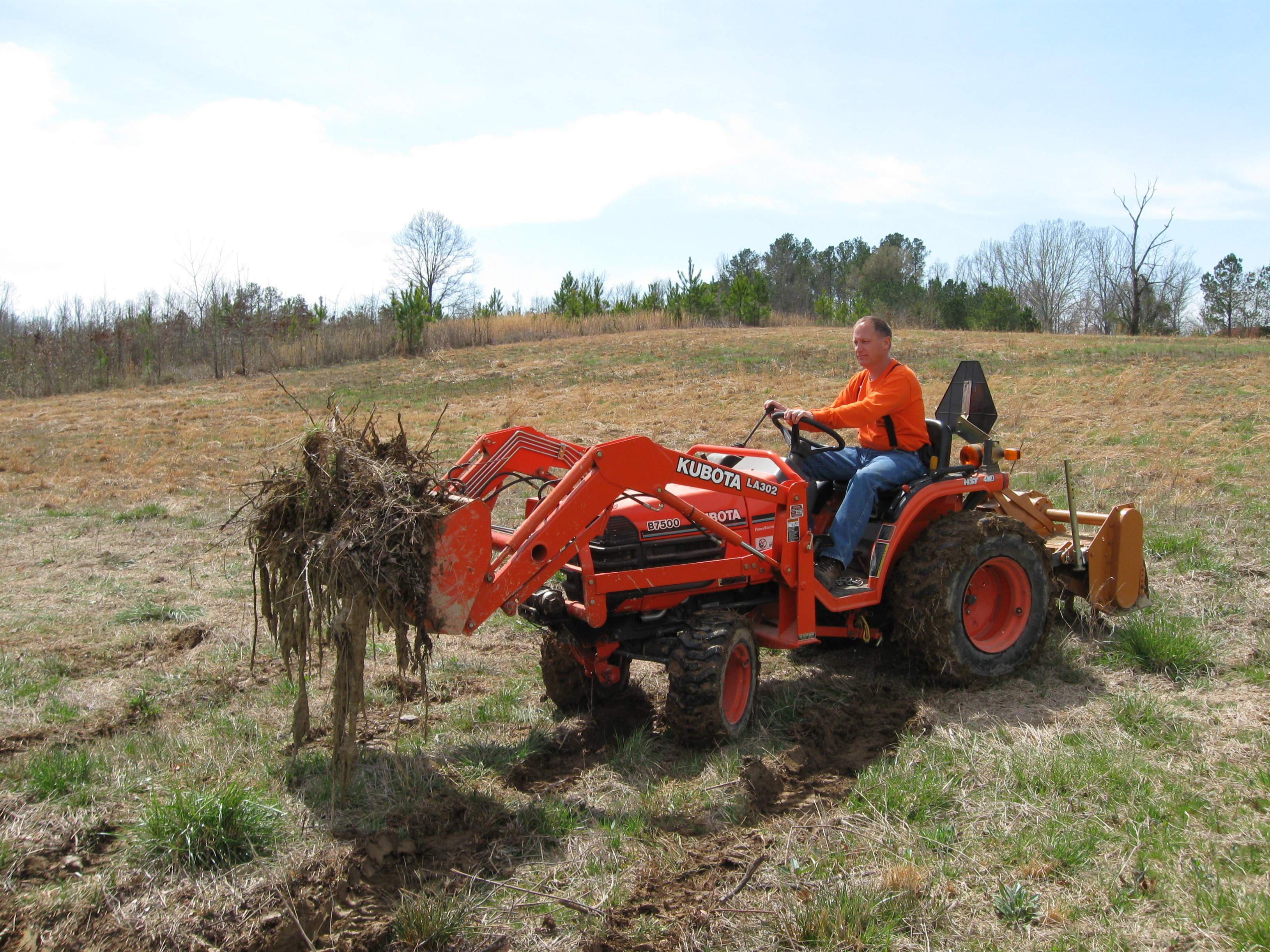

Well, I can answer some questions. Yes, the MMM works just like the rear pto. It keeps going all the time in foward and reverse.I have a 60" deck and love it.Mine is the B7500 HST which is the same as the 7510 just newer.Mine is 21hp.Just turned 382hrs today and alot of those are not easy hrs either.I've bush hogged fields that where the weeds and brush was taller than my ROPS. I have pics in a photo album to prove that.I like to take pics of alot of the things I do with my tractor because I know people wouldn't believe this from such a small tractor but the pics don't lie. I had a RFM for mine but it was no good around the house. Way too many obstacles.The MMM works great and with a front loader the deck is a breeze to put on and take off.When the deck is off you simply pull up to the MMM and your front bucket is across the deck and then you lower the bucket and raise the fornt of the tractor up and roll the deck underneath and about 2 more mins and your ready to mow.
Tilling is something else I love to do. I done some of that today.I tilled up a spot about 10' wide by 175'long in about 20 min. This ground has never been worked before and it ate it up like nothing. By the way I have 17 acres and the little tractor workes it all.About 7 acres is grass and the other 10 is fields that get bush hogged once or twice a year.Two years ago it was all yard but I got tired of mowing all the time so I cut it down to about 7 acres.I will see what I can do and post some pics maybe tomorrow.I have alot of mowing to do.I done some of it today.A tractors work is never done.

Here are some pics of the mowing deck getting ready for grass cutting.I just sharpened the blades and washed everything and greased the fittings.It's now ready to put back on.Easy to move around the yard too.
Donny

Let's see if this picture will download. If it will it was a ditch I cleanned out about 3 weeks ago. It was more fun than a barrel of monkeys.
Donny

Yep, That's a winch. It's a 2000lb. ATV winch. It's hepled me out of a few tight spots. It does work very well. I've used it to put tension on trees while they are being cut.I've pulled myself out of some deep mud and just some playing around.It was new from a Yamaha ATV and I just followed the directions on the wiring from the ATV. I put the switch under my loader lever where it would be out of the way and out of sight.
