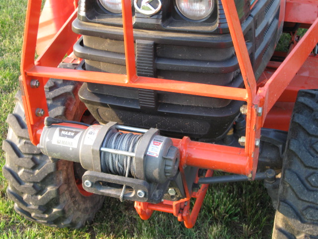

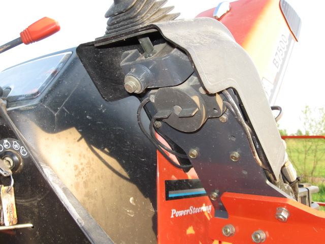

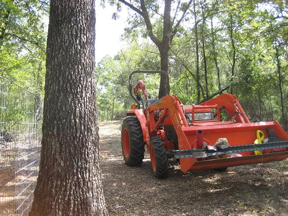

Here are some pics of my winch and the set up.I mounted the switch under my loader lever.
Donny

/ B7510 hydrostat VS regular shift?? #44

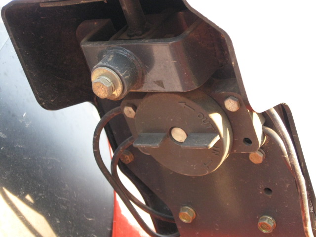

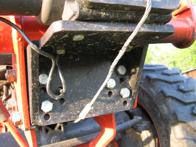

Here are a few more pics.One pic is a regulator for the proper voltage so the winch will not drain the power from the battery. It came with the winch so if you decide to add one of these to your tractor your local ATV dealer can tell you more about this. All in All I think it took about 1 hour to install not counting mounting the bracket.Any other questions I will try to help.
Donny

/ B7510 hydrostat VS regular shift?? #45
Donny-thanks for the link to this thread and posting the pictures of your winch.
Where did you get the mounting bracket that seats into the front of your B7510?
/ B7510 hydrostat VS regular shift?? #46
After I bought the winch I had a friend of mine to make the bracket out of 1/2" steel.It was simple to make. Just make sure that the top part of the bracket where the winch mounts on clears your bucket.Mine clears about 3/8" when lowering the bucket to the ground.Once the bracket is made match the holes with the holes on the front of your tractor,drill and bolt on.
