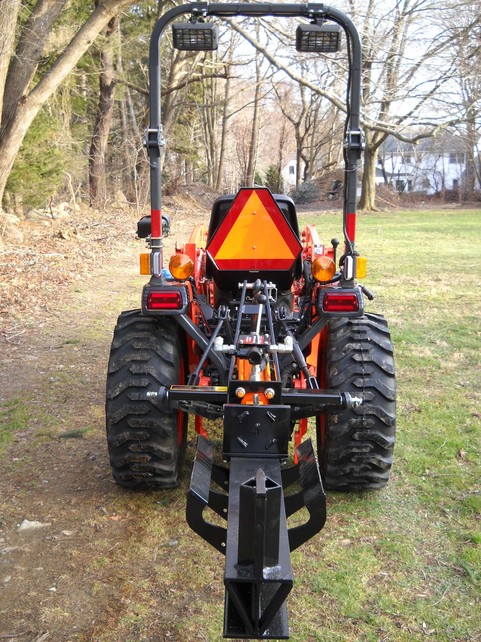

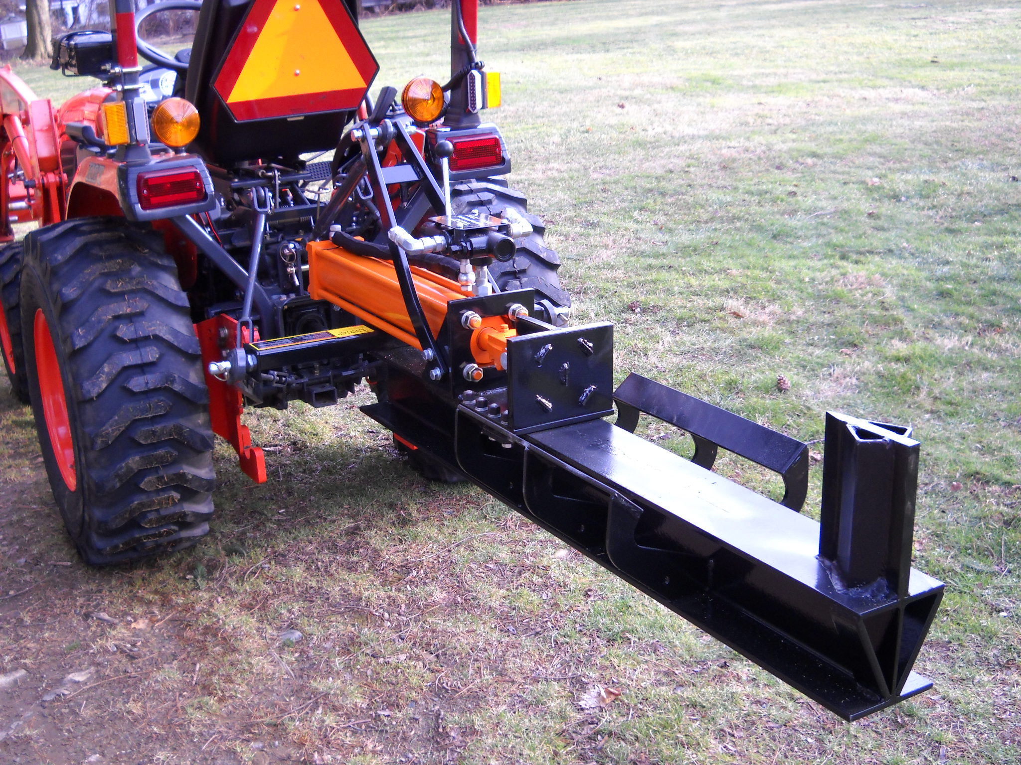

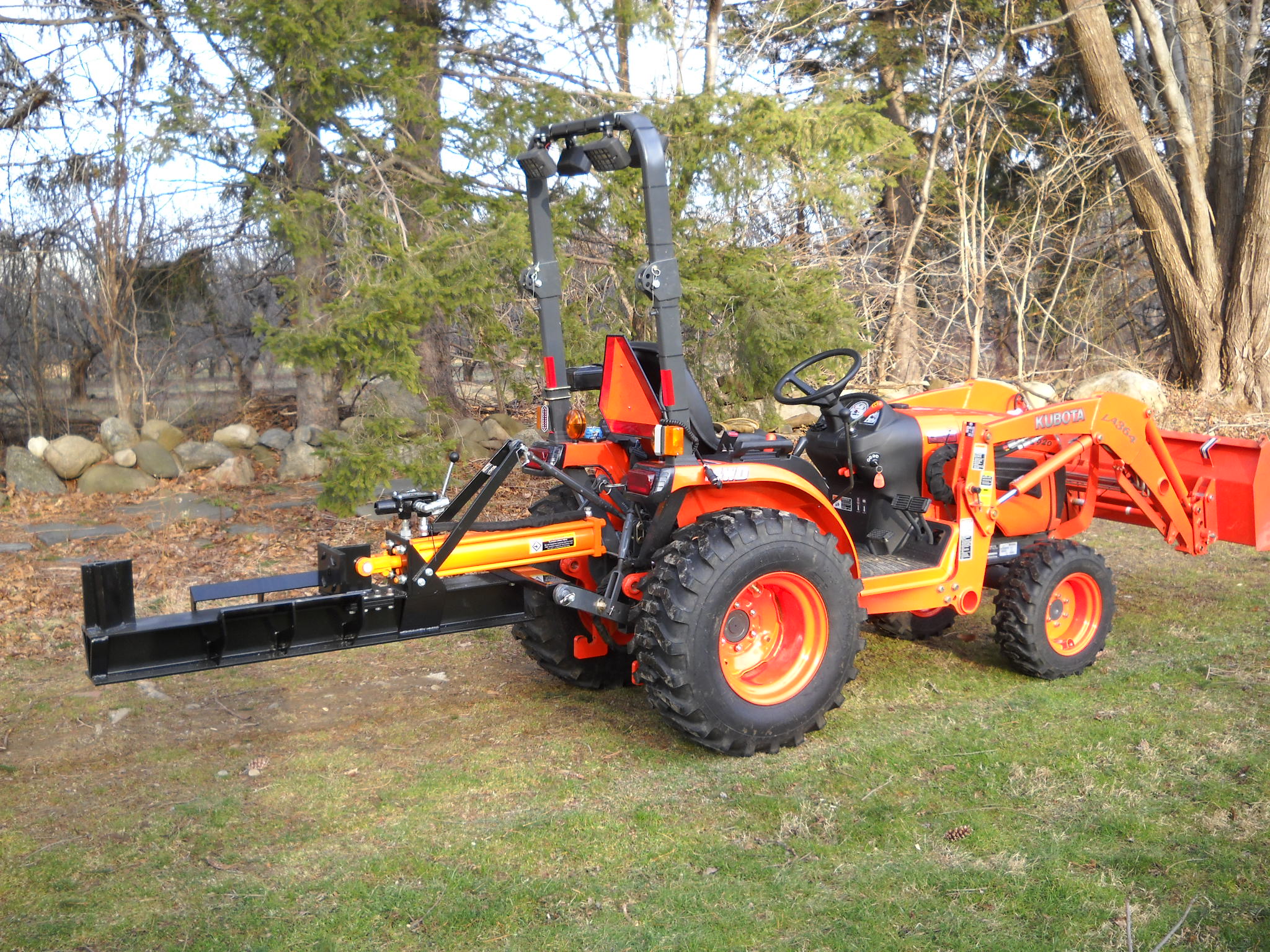

I have a little more flow on my B2920 however the 14 Ton 3PT Splitter I purchased from Harbor Frieght works great - plenty of power, cycle time works perfect for a single user and it only cost me $399 after using a 20% coupon. Since I do not split much (1.5 cords per year) this was the best platform for me. If I did a lot of splitting I may have went with a stand alone unit.

/ B7300 with 3 point splitter #7
jambx -
Looks great. Did you run long hydraulic lines from the loader? Or add a rear remote?
If you did the rear remote, can you give me an idea of the expense? I just bought a B2920 and like your set-up.
/ B7300 with 3 point splitter #8
BXOWNER,
No remotes or Loader plumbing for me since I have a BH and hooked right into these lines. The two hoses and quick couple adapters cost me a mear $110. I am very happy with this set up since I never take my loader off and can a still lower and raise the splitter with the 3pt. The total cost of this set up was too good to pass up. gotta love HF!
