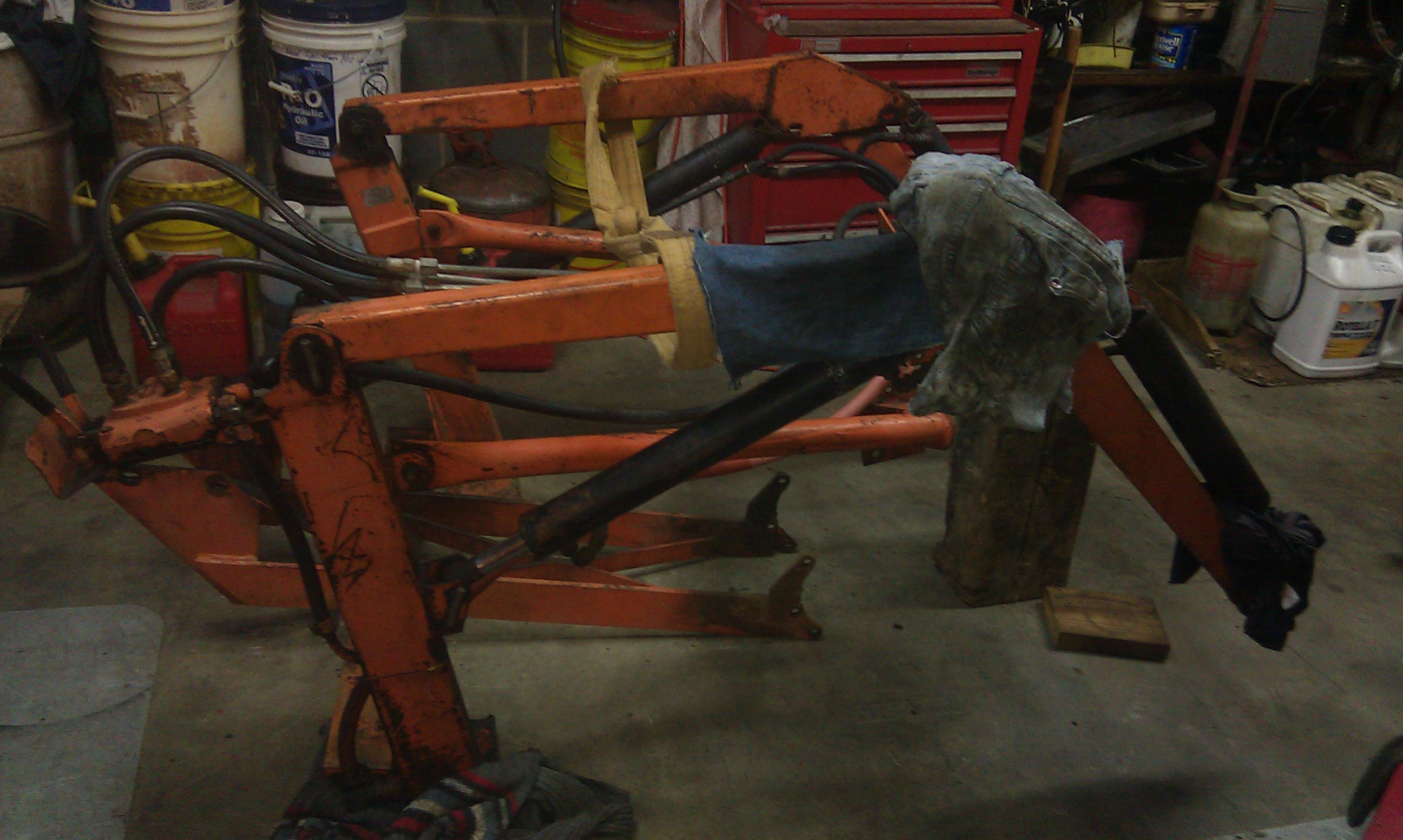

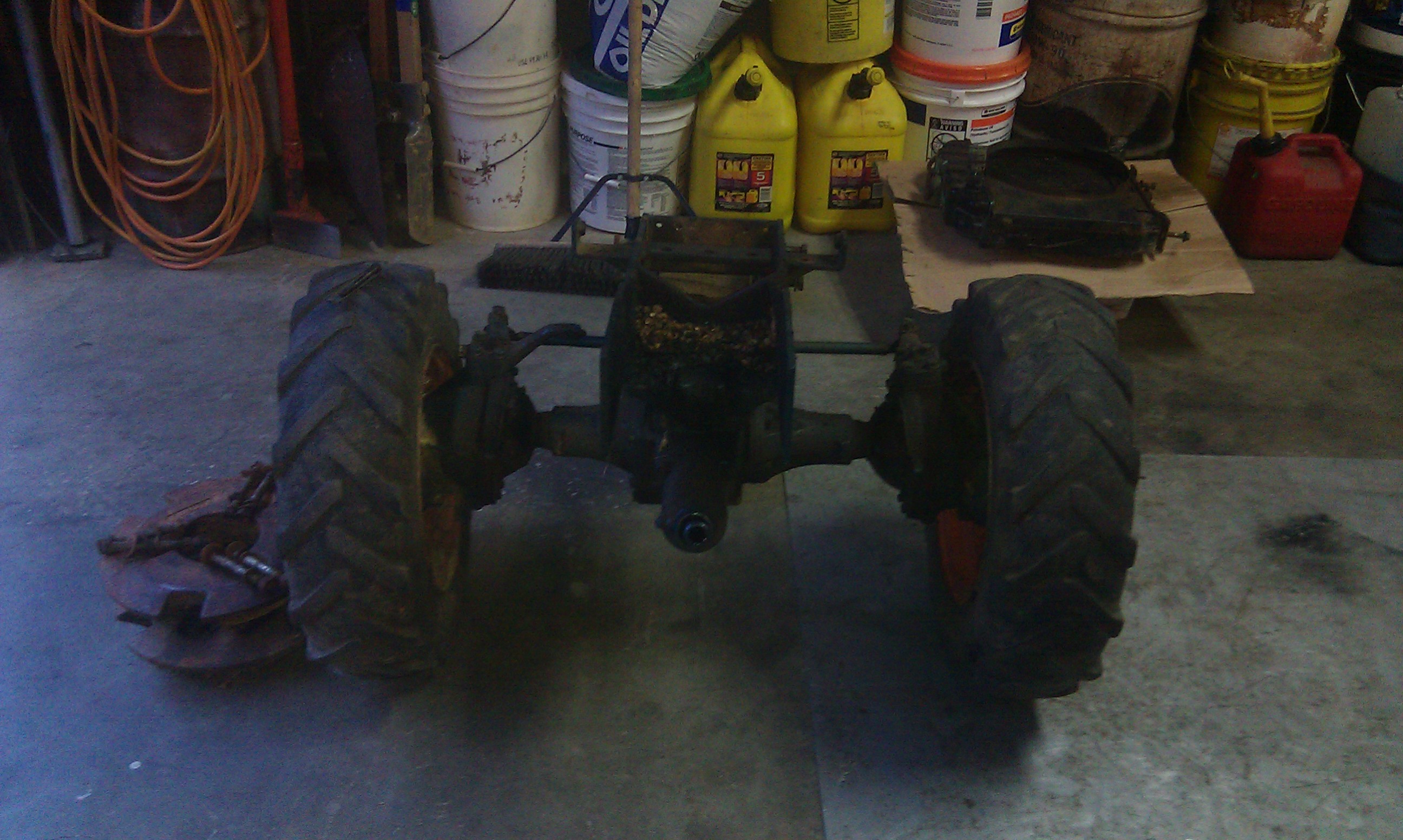

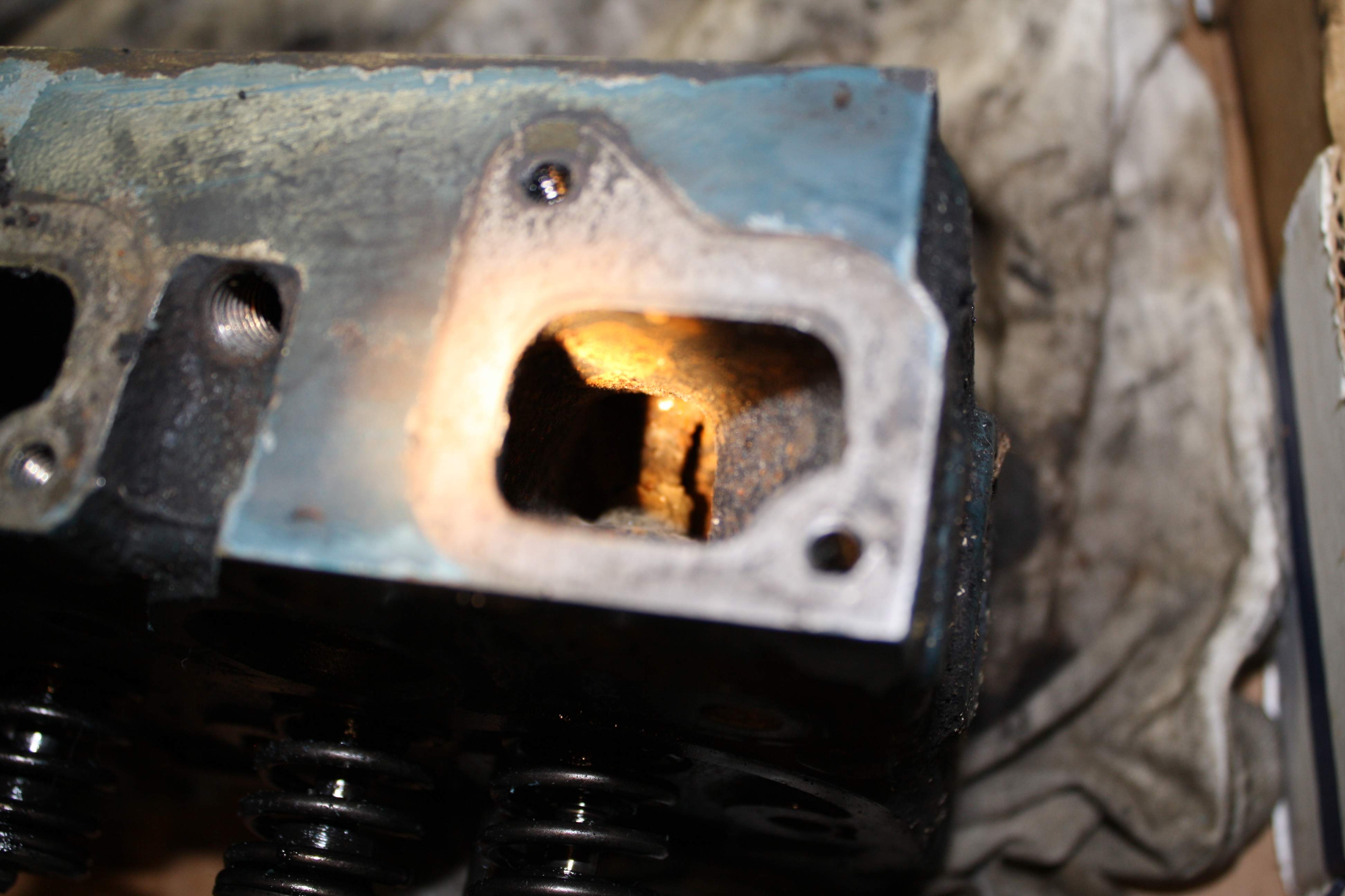

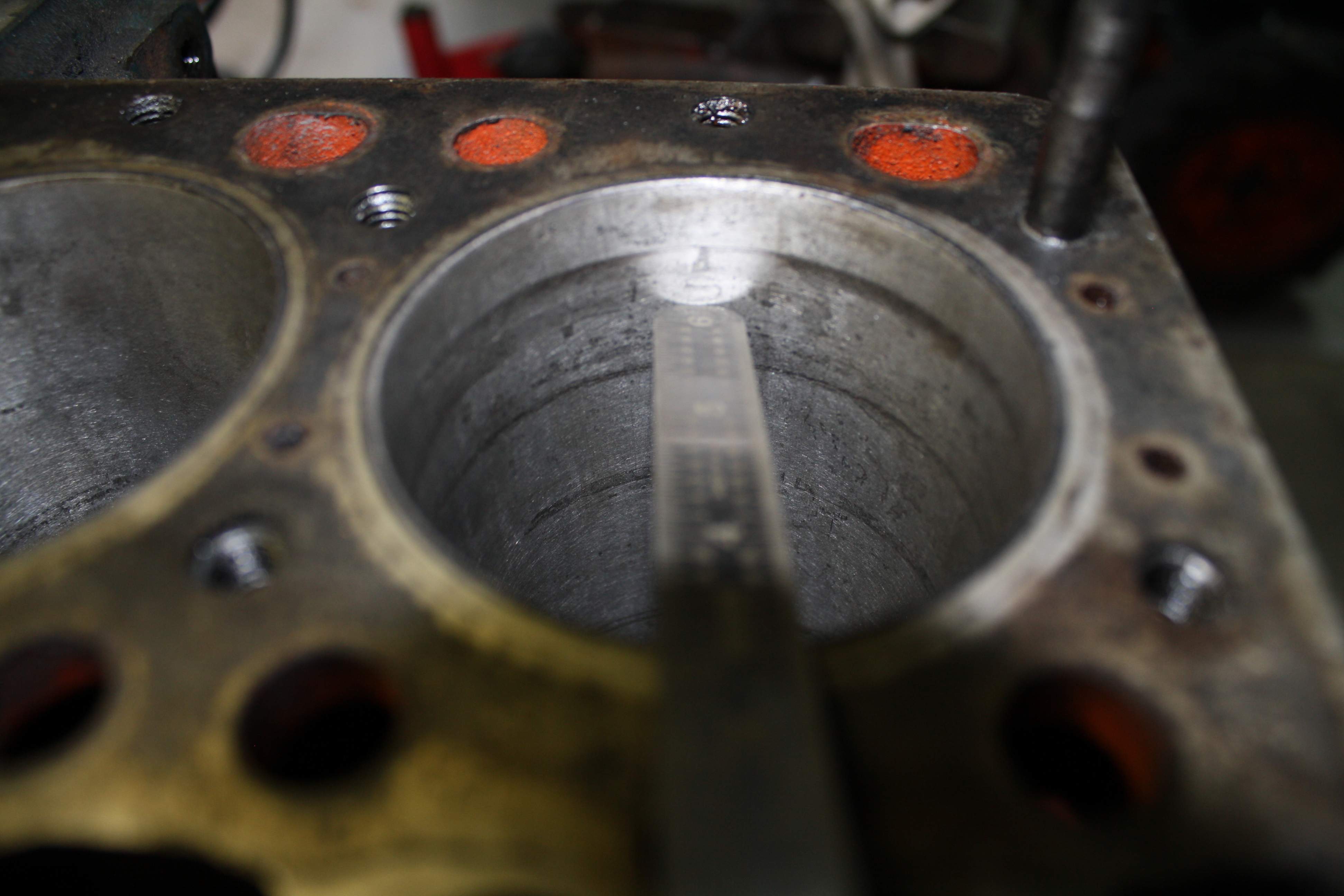

Began working on the B7100 that I brought home in August. The tractor had set for three+ years with the upward exhaust uncovered. I resisted the urge to just try and crank the engine before doing some investigation into possible water damage to it. Good thing I did. Even though the engine was not stuck it did have rust in no. 2&3 cylinders along with stuck rings. Some water found its way to the crank no. 3 rod and main journals which made a small rough spot on both. No. 1&3 cylinder walls have a ring groove worn at the top. I began the task of finding and pricing parts and was shocked to discover the high price of each component.Before I waste any time or money purchasing parts I will wait for the verdict from my machine shop as to whether the cylinders can be cleaned up with a .5mm bore and the crank can be turned within the under size bearing specs offered by Kubota. I have pictures but haven't figured out how to ad them to my post yet.

Yea, i'm afraid that an undertaking might become an under statement before this is over. I can carry on with the news that the block wiil need to be re sleeved but if the crank can't be turned then the project will have to be scraped and the tractor parted out unless I can locate a good used crank that is reasonably priced.

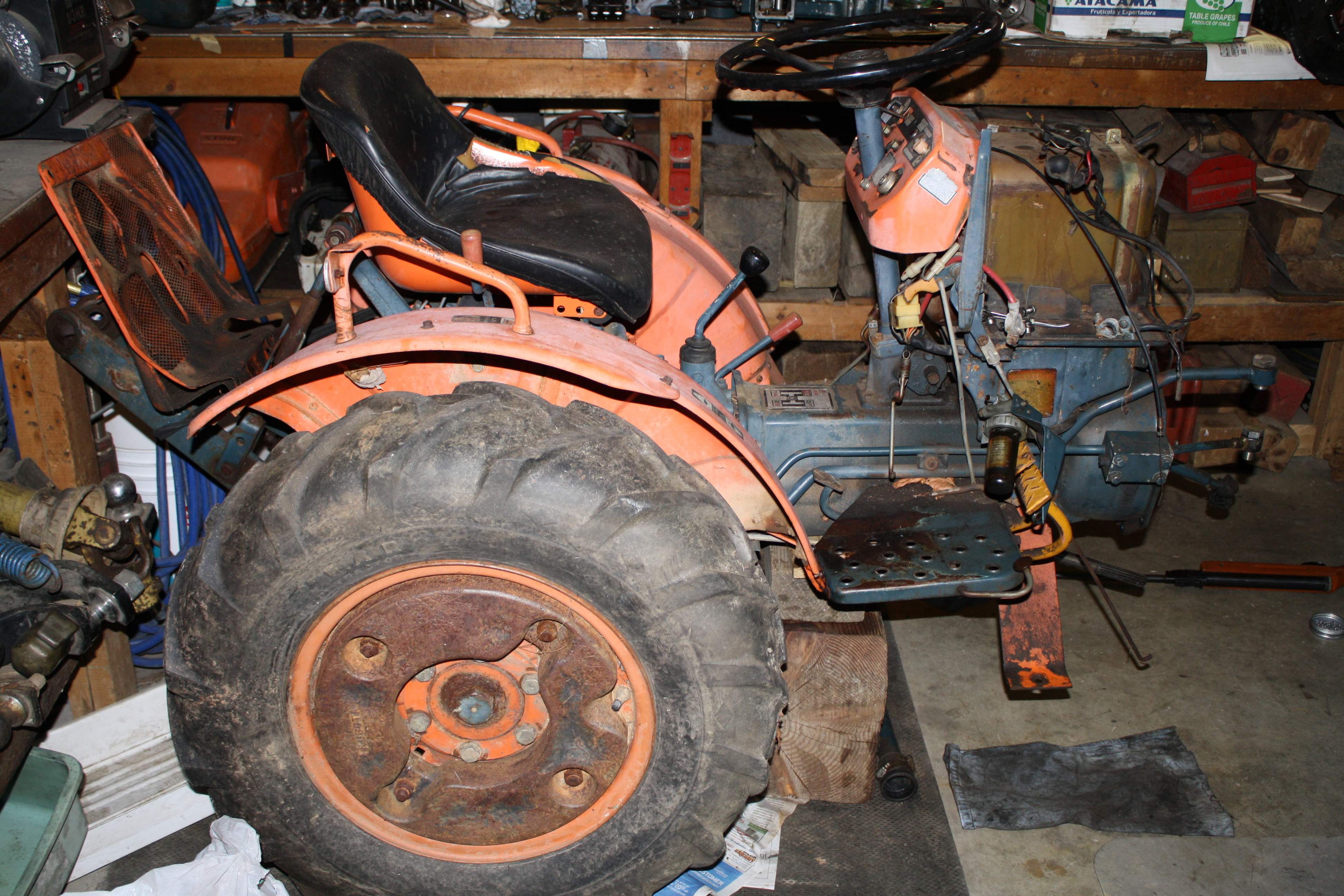

Got my head, block, and crank to the machine shop yesterday. Good news so far. The cylinders are good for a .5mm bore and the crank will just get a polish. Ordered 675.00 worth of parts from Messicks just to get the machine work going and put the bottom end back together. Thankfully I obtained this tractor very cheap on a NC sealed bid so I have a lot of room to spend before I exceed the value. Hopefully I will have a like new tractor for the same money that I would have paid retail for one then had to make repairs. As for the wheel weights, the tractor has front and rear factory weights. With the FEL being plenty of weight for the front I am considering not using the fronts if the restore continues. The tires have never been loaded with fluid so my wheels should be in good condition. Spent 4 hours washing engine parts spic and span to prepare for a restore paint job as I re assemble. Will have to get the engine going before I will know what else needs repair besides the charging system which was the reason for the tractor being taken out of service.

Got my WSM from Messick's, last week. Having some issues with worn front PTO splines. Found a section of copper tube jammed between the teeth when I finally got them apart. Looks like I'm going to have to do some modifications if I can't find the parts.
